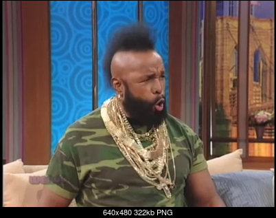

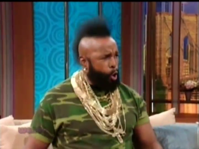

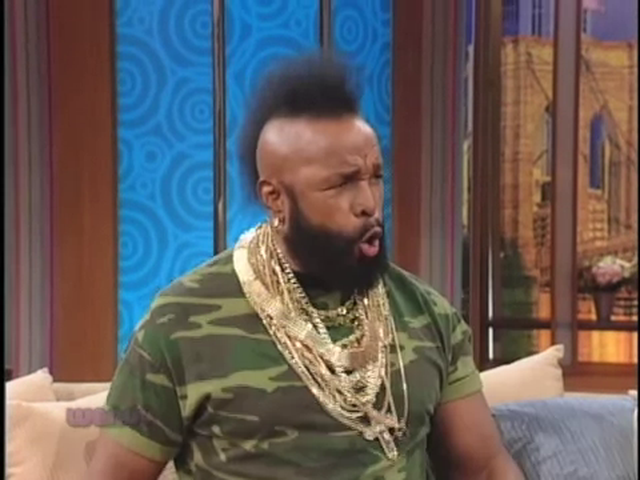

    But, surprisingly, the WEBM video here (first one) is in much better quality than the FLV one I have, despite being in lower resolution.
Name:	YT - Mr. T's Rant - I Pity the Fool [mnauDzs-WJA -f 43+251].webm - 00_00_55 640x480.png
    480x360 WEBM resized to 640x480
Name:	YouTube - Mr. T on The Wendy Williams Show 10-13-2010.flv - 00_04_30 640x480.png
    720x480 FLV resized to 640x480
    So I'd be interested in having the complete sequence in this quality...

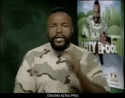

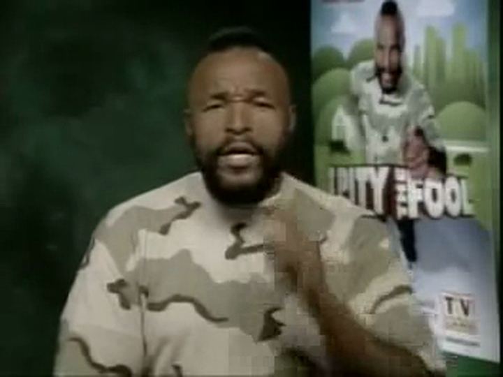

    Somewhat related question : I know that video downloaded from YouTube are bound to be in low quality anyway, and I don't expect to get a pristine result, but one in particular has quite egregious blocking artifacts :
Name:	AVStoDVD - 6. Mr. T Ã* Backstage 2006.mpg - 00_01_00 -2020-02-02-02h04m08s600.png
    Is there any kind of filtering that could improve this ? (I made that conversion from the WEBM stream in 352x288 which is the best one available now. The former conversion had been made from a MP4 stream in the same resolution but slightly blurrier, with Magix Video Deluxe and its included MainConcept encoder rather than Avisynth + HCEnc ; I'm wondering if the extra sharpness is a good thing in this case, as it makes those artifacts more conspicuous overall. Perhaps using BilinearResize rather than Lanczos4Resize would slightly improve the outcome.)

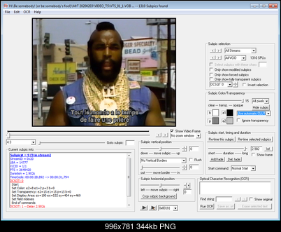

    Noone has any clue regarding the subtitles issue ?

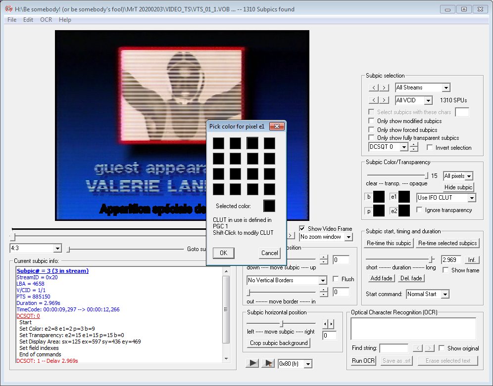

    It's very weird because if I watch the individual VOB, the subtitles are displayed normally, but if I open the whole DVD folder and watch the same sequence from there, they appear in dark gray as shown earlier. What could possibly explain this ? Is there something wrong in the IFO files which could somehow reduce the number of colors of the bitmap images on playback, or replace a color with another ?
    EDIT : If I open the VOBs in DVDSubEdit, I see this :
Name:	DVDSubEdit BSOBSF.png
    Apparently, all the available colors are black or dark gray. Why is that ? How can I fix that ?

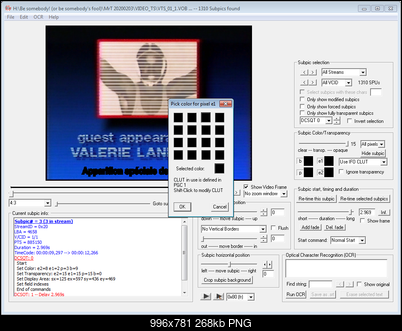

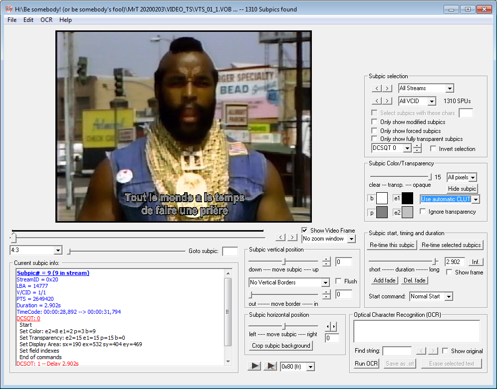

    Then I tried "use automatic CLUT", which improves the aspect although it's still not right :
Name:	DVDSubEdit BSOBSF Auto CLUT.png
    If I set this to "use IFO CLUT", I get the wrong color.
    What exactly is "CLUT", and how come the colors are being changed between the VOBs and the DVD ?

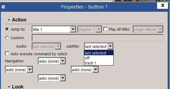

  12. And again, how can I get DVDStyler to enable the subtitles by default ?
    Several options.
    Under "Action" for a button you select which subtitle track to use. Notice subtitle and audio is to be selected in the Titleset domain not the VMGM domain. (It's part of the specification for a video-DVD)
    [Attachment 51827 - Click to enlarge]
    Use a pre-command for the title like subtitle=64;. See p 14 here https://www.dvdstyler.org/docs/dvd_styler_guide.pdf

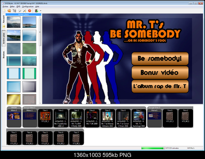

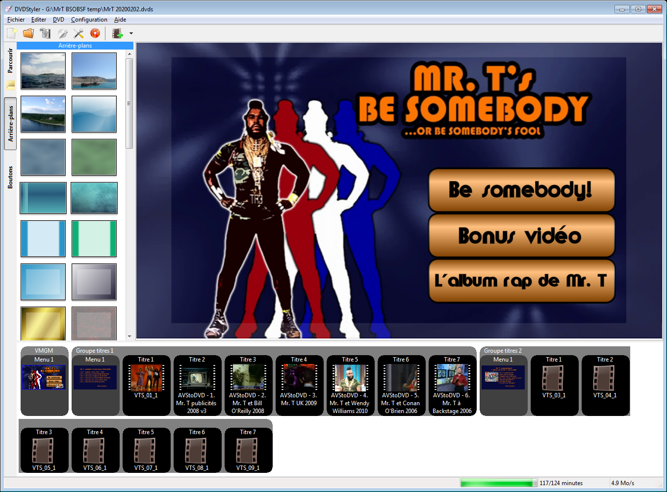

  13. Under "Action" for a button you select which subtitle track to use. Notice subtitle and audio is to be selected in the Titleset domain not the VMGM domain. (It's part of the specification for a video-DVD)
    I've also seen this in the mean time, but I'm not sure I understand this — what does it mean here "in the Titleset domain / VMGM domain" ?
    In this case there's a button on the main menu which leads to the main video (Title 1) ; then a second button which leads to a secondary menu with a selection of six extra videos (titles 2 to 7) ; then a third button which leads to another secondary menu with a selection of audio tracks.
    Does it mean that if I set the “action” for the first button in the main menu (which is under “VMGM”) it won't work ? Or am I completely confused ? Well, indeed, I just tried, I get a warning : “Please use titleset menu to select subtitle track.” But what exactly is the titleset menu ?
    And I don't quite understand this either (from the PDF guide) : “Still, adding 64 to the stream number shows all subtitles in tracks with non-forced subtitles. Track 64 shows everything in stream 0. Track 62 disables subtitles, and track 63 finds the viewer's default language tag (with stream 0 default).” I don't know how I could have guessed “add ‘subtitle=64;’ as a pre-command” from this...
Name:	DVDStyler 20200203.png
