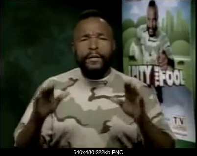

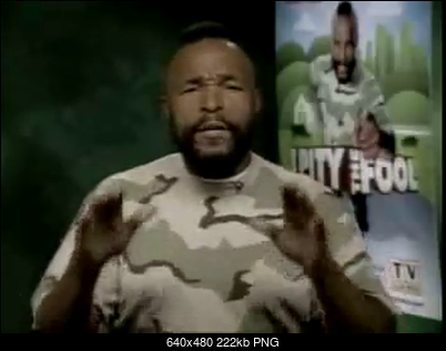

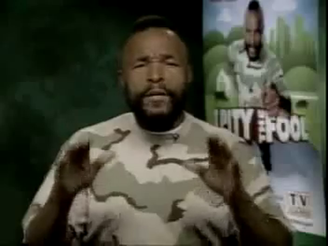

  3. Thanks for the quick reply.
    In the mean time I tested another video, and I'm now not so sure about what I wrote earlier, regarding the encoding quality on Youtube having generally improved. For this one, the video files downloaded in 2011 are both in 352x288 resolution, the FLV has a 262kbps video bitrate and a 48kbps audio bitrate, the MP4 has a 245kbps video bitrate a 125kbps audio bitrate. The newly downloaded file, with youtube-dl and -f bestvideo+ bestaudio, is in 294x240 resolution with a 242kbps video bitrate and a 126kbps audio bitrate. What's interesting is that, comparing screenshots resized to the same 640x480 resolution, it appears that the newer file has less detail, but also much less concpicuous blocking artifacts than the former two. Is there any logic and consistency at all to all this ? In this case I wonder which one is “the lesser of two evils”, considering that the quality is pretty lousy for all three (and it seems a bit silly to convert 250kbps AVC to 4000kbps MPEG2 ! and even more so to do it all over again 8 years later expecting an ever-so-slightly improved outcome !...).
Name:	YouTube - Mr. T - Talks 'Rocky III', 'A-Team' and his Life and Career.mp4 2020-01-17 640x480.png
    (2020-01-17 MP4)
Name:	YouTube - Mr. T Talks 'Rocky III', 'A-Team' and his Life and Career.mp4 2011-07-10 640x480.png
    (2011-07-10 MP4)
Name:	YouTube - Mr. T Talks 'Rocky III', 'A-Team' and his Life and Career.flv 2011-07-10 640x480.png
    (2011-07-10 FLV)
  4. I searched about HCEnc (which I never used aside from some brief and tedious testing years ago, in a situation where I had a deadline and decided to use the more straightforward encoder from the NLE despite the reported superiority of the former) : so apparently it does only encode the video, not the audio, so something else has to be used for the audio, and for muxing the streams. But the discussions I can find on the subject are at least 10 years old. Are the methods they describe still relevant, or are there better workflows now ? What would be the most straightforward way of converting a video to MPEG2 using HCEnc and whatever else ?
  5. You can draw few conclusions about youtube encoding quality from files uploaded by different users. Because you have no idea what those users uploaded.

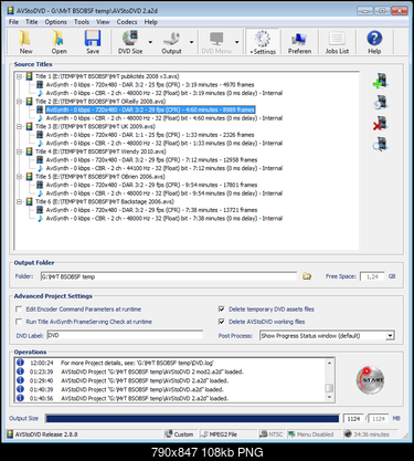

    Tried AVStoDVD, so far it's more confusing than helpful... For instance I can't find explicit video bitrate settings, only minimum and maximum thresholds. Is this on purpose ?
    Mar 2008
    It's set here when the project is loaded. Greyed out by default,
    deselect "auto video setup" and "auto bitrate calculation" to change.
    Be aware the program always chooses an auto bitrate as high as possible so that the title(s) will fit
    on the disk, or, so the setting does not exceed your Max rate in the preferences.

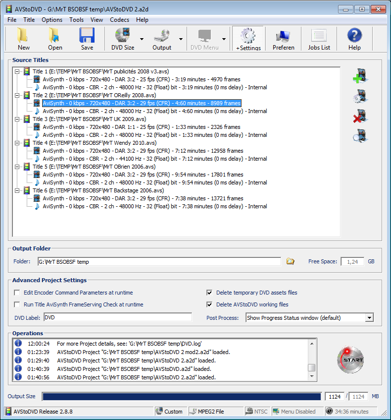

  19. So, I created an Avisynth script for each of those 6 videos, encoded them with AVStoDVD, then generated the DVD with DVDStyler, after a few hiccups it seemed to have completed as intended... But now I realize that all those videos are in 1.5 aspect ratio ! I already resized them to 720x480 within the script, but AVStoDVD insisted on adding 30 pixels black bars and re-resizing, and I can't change that damn setting, whether I type "4:3" or "4/3" or "1.33" I get : "Warning! Inserted value is invalid." If I remove the cropping / resizing in the Avisynth tab, everything becomes red, supposedly because it considers the output invalid / non compliant...
    How is this supposed to be done ?
    Also, if an Avisynth script is loaded in 30 FPS, it adds a ChangeFPS framerate conversion, but if the framerate conversion is aldeady done in the script, it adds "Video = Video.MCJMFPS(29.97)" — why ?

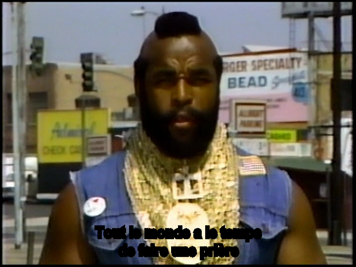

    Also, in DVDStyler, I can't find any setting to determine whether the subtitles should be active by default or not.
    And apparently the current version is not happy with accents in subtitles' file names (accents in the videos' file names don't seem to be a problem). It doesn't warn about it right away though, only halfway through the generation process. With a former version I generated that same DVD with SRT files which had the same base name, some of them with accents, and there was no such issue.
    EDIT : Found here : "MCJMFPS uses motion interpolation via mvtools. It will create lots of distortion with some material. DgPulldown is far better." Why, why does it add such an overkill processing to convert from 29.97 FPS to 29.97 FPS ?...
    And why does it convert to YV12 footage which is already in YV12 ?...

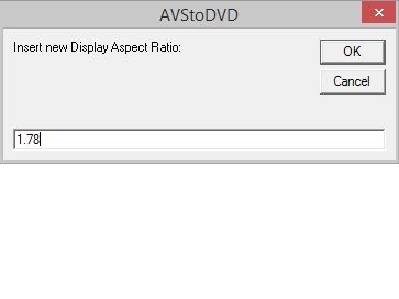

    EDIT : This is really stupid... If I change the AR value from "1.5" to "1" it works (but it's not what I want since now it insists on adding 120px black bars), but if then I try to set it back to "1.5" it stubbornly warns me that this value is invalid !...

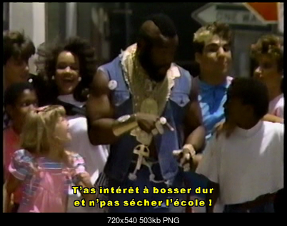

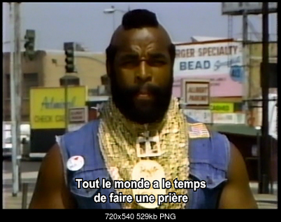

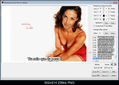

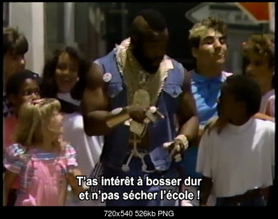

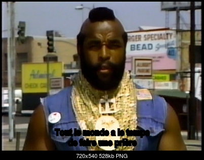

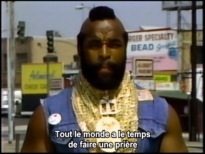

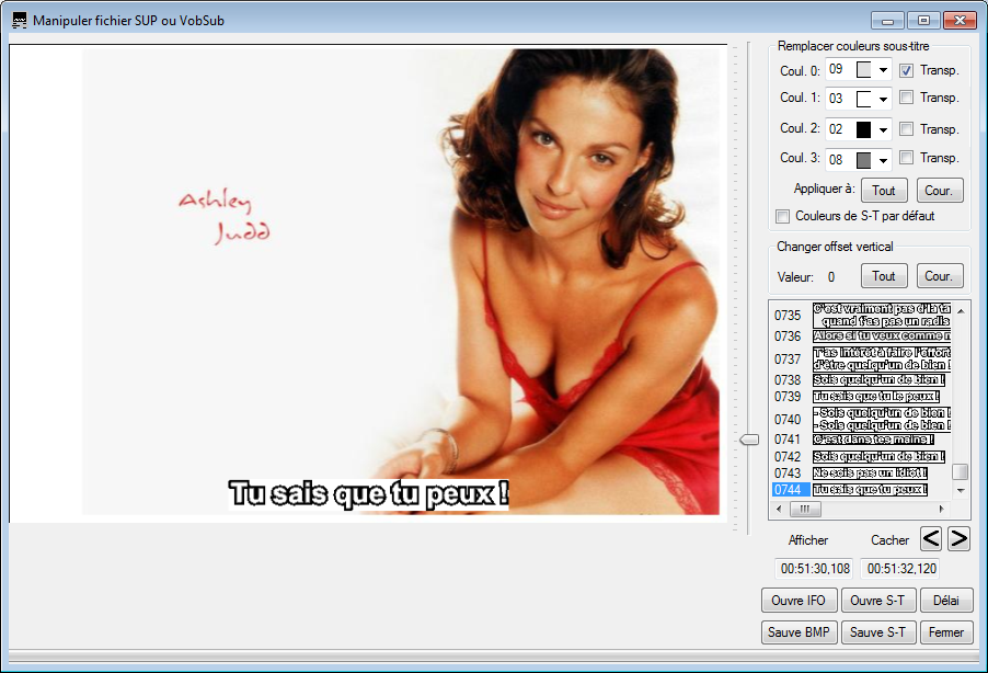

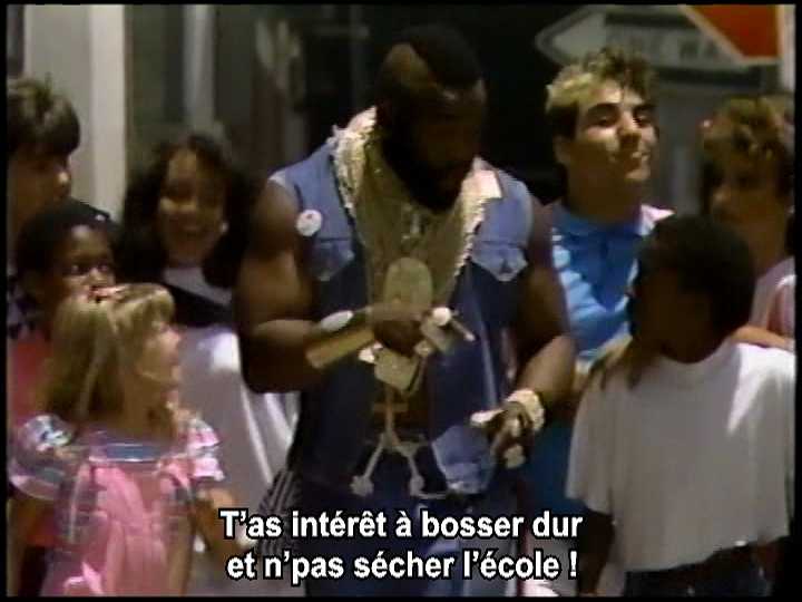

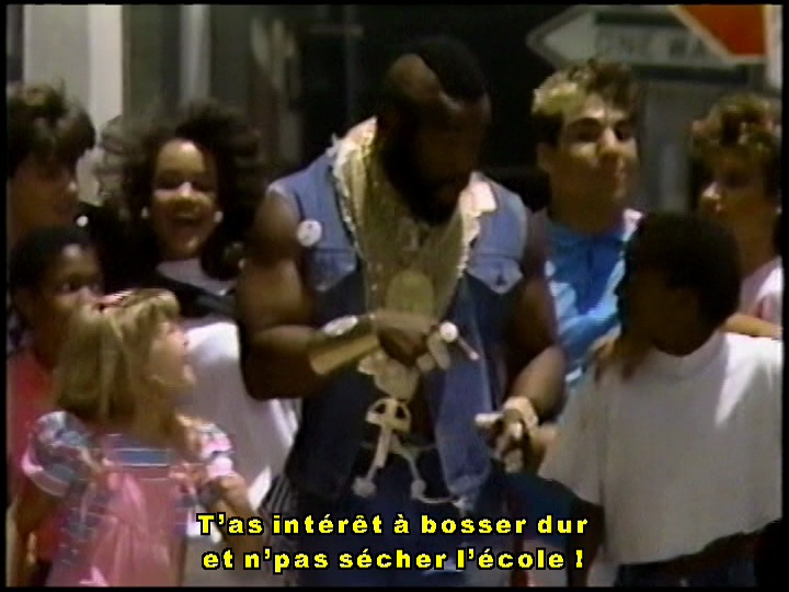

  20. Another issue : I found out that DVDStyler does not apply formatting on SRT subtitles, italics in particular. Apparently this is a well known issue, and not a trivial one to fix. And as already mentioned, the aspect of the subtitles generated by DVDStyler is not exactly pretty (rough edges which make them quite difficult to read). Another problem is the fact that some subtitles can be too long and cut into 3 lines, depending on the font size and the width of the margins, and it's quite unpredictable (I've seen this with a 42 characters line, but elsewhere a 43 characters line can be displayed correctly), so it would be necessary to re-watch the whole thing without blinking in order to be sure that there's no such mistake.
    So, is there a tool which can reliably convert SRT files to DVD subtitles, allowing to preview the output, to control the size, to check if no line is too wide, to set the font type, size and whatnot, and which can preserve italic / bold formatting ?
    Mar 2008
    I don't think the motion compensation is a good default, you can modify the preferences (hard frame rate conversion) to use
    ChangeFPS (insert/drop frames) or ConvertFPS (blend frames) instead.
    Once you change the preference, you'll need to rebuild the project.
    See these images to see how to change the A/R of the source, since A2d assumes 1.5, the SAR of the source.
    30 FPS is not DVD compliant
    Any other issues provide the external script and A2d log.
    Somebody else can help with DVDStyler and subtitles, they're not my thing

  25. See these images to see how to change the A/R of the source, since A2d assumes 1.5, the SAR of the source.
    I did exactly what is shown on those pictures, but then any value I type is considered "invalid", except "1", which is of course not correct. I tried 1.33, 1.333, 1.333333333333333, 4:3, 4/3... and 1.78 is not accepted either. I also tried to modify the DAR values in the .a2d project file, then reload it : doesn't work with "4:3" (AR displayed in the GUI as "4") but seems to work with "1.33" (AR displayed as "4:3").
    The only workaround I could find was to remove all unwanted conversion in the Avisynth tab. Then it seems to proceed as intended, and the output files have a correct AR.
    (Using version 2.8.8 if that matters.)
    I thought that pulldown flags could take care of that, but apparently this works only with native resolutions inferior to the target one, right ?
    But then, why does AVStoDVD insist on converting the framerate even after I already converted it (with ChangeFPS(30000,1001)) in my Avisynth script loaded as source ? (Under "Source titles" it displays the framerate as "29 fps" for those clips, which is also confusing.)
Name:	AVStoDVD 29 fps.png
    For the 25 FPS clips, according to what I could read in the Avisynth tab, "#PullDown: using DGPulldown/HCenc to upsize FPS", the original framerate should have been preserved, with a pulldown flag applied to mimic the valid value of 29.97 FPS on playback, yet according to MediaInfo the resulting files seem to be encoded as 29.97 FPS with "hard pulldown". VirtualDub2 also identifies them as 29.97 FPS, and "MPEG-2, 4:2:0 interlaced".

  28. Regarding the subtitles, I switched to using SubtitleCreator, which can directly convert SRT to SUB/IDX format, with a better previewing interface (although the menus are a bit confusing and I'm already getting tired of that semi-kinky Ashley Judd picture displayed as default background). DVDStyler does not accept SUB/IDX subtitles, but a workaround — found here — is to first mux the MPG or VOB with the SUB/IDX subtitles with MKVToolNix, then load the MKV into DVDStyler.
    On the same page someone states that : “The subtitle format used on a DVD (idx/vobsub) is a low resolution image based format and tends to look pixelated.” So this means that it couldn't possibly look as good as what I see in the preview, with the smooth anti-aliasing, correct ? Is this about the best that can be done with DVD subtitles ?
Name:	VTS_01_1.mkv - 00_02_50 -2020-02-02-11h04m12s024.png
    It's already better than before (and the italics are respected).
Name:	MrT 20200129 - 00_02_50 -2020-02-02-11h18m09s496.png
    But, new problem : the subtitles thus created get progressively out of sync, they appear sooner than they should. (Same if the SUB/IDX subtitles are loaded separately, into VLC Media Player or MPC-HC.) Why ? How to fix this ?
    In the IDX file I can see that the last subtitle is set to appear at 00:51:27:021, yet in the SRT file it's set to appear at 00:51:30,108. The timecodes for the first one are almost identical : 00:00:02:267 / 00:00:02,269.
    EDIT : And strangely, if I re-load the SUB/IDX into SubtitleCreator, the timecodes displayed are exactly the same as in the SRT...
Name:	SubtitleCreator - Manipuler fichier SUP ou VobSub.png
    EDIT : It gets sort-of synchronized by converting the framerate in SubtitleCreator from 30 FPS to 29.97 : it's no longer progressively out-of-sync, only slightly in advance throughout the whole video. The same effect is seemingly obtained by selecting “PAL” instead of “NTSC” under the “Format” menu, but then the placement of the subtitles on the frame is all wrong, being based on a 576px height. According to the author, this is “not a bug, but feature” : “Not a bug but feature. SC applies drop-frame when NTSC in Display menu is selected. If you want to get non-drop NTSC subtitles choose PAL before saving.” What is this supposed to mean ?
    EDIT : So apparently the workaround described here works to get a perfect synchronization :
    – creating a set of SUB/IDX files in NTSC mode
    – creating a set of SUB/IDX files in PAL mode
    – then associating the PAL IDX with the NTSC SUB...
    And the position of the subtitles on the frame is corrected by editing the IDX to change the frame size from “720x576” to “720x480”...
    I only spend half a night trying to solve this mess. é_è

  30. I already explained what the problems were, to the best of my knowledge, but here :
    AVStoDVD test.a2d.txt
    For this test I imported one of the Avisynth scripts with the ChangeFPS(30000,1001) command (below), and the corresponding source video (FLV 30 FPS).
    WendyV = LWLibavVideoSource("E:\TEMP\MrT BSOBSF\YouTube - Mr. T on The Wendy Williams Show 10-13-2010.flv").Lanczos4Resize(720,480)
    WendyA = LWLibavAudioSource("E:\TEMP\MrT BSOBSF\YouTube - Mr. T on The Wendy Williams Show 10-13-2010.flv")
    AudioDub(WendyV,WendyA).ChangeFPS(30000,1001)
    The Avisynth source is correctly identified as 29.97FPS in the "FPS" and "FPSAVS" fields, but appears as "29" in the "VideoFPS" field and in the GUI. Then AVStoDVD insists on adding those unnecessary conversions : ConvertToYV12, AddBorders, Spline16Resize, and MCJMFPS. And the aspect ratio is identified as 1.5 based on the 720x480 conversion in my script (actually I'm realizing just now that this one was already in 720x480 despite being downloaded from YouTube — but with a wrong 3/2 AR — so that conversion wasn't even necessary {*}), but I can't change this to the correct 4:3 value no matter what I type in the "Video Display Aspect Ratio" sub-menu. As I mentioned earlier, it seems to work if I edit the .a2d file and type "1.33" wherever there's "1.5" then reload it.
    Strangely, the 30FPS FLV is identified as 29.97FPS in the "FPS" and "FPSAVS" fields. And AVStoDVD still wants to convert the framerate, but with "ChangeFPS(29.97)" instead of "MCJMFPS(29.97). By the way "29.97" doesn't seem as accurate as "30000,1001".
    As already mentioned, I managed to get (I think) the expected result by removing those unwanted conversions in the Avisynth tab for each one of the "titles" — seems to work, but quite tedious, and not exactly foo’ proof.
    Then I tested an encode of a 25FPS clip with HCEnc followed by a conversion with DGPulldown, and the result seems to be exactly the same : every media player or analyser or editor identifies the output as 29.97FPS, either displaying the partially interlaced pattern (VirtualDub2) or not (VLC Media Player, SMPlayer, MPC-HC, Avidemux). So is this indeed to be expected ? How can I verify that a 29.97FPS file is really 25FPS with pulldown flags if it's reported everywhere as 29.97FPS ?
    Now, for those subtitles issues, I managed to remux the VOB or MPG videos with the SUB/IDX files exported with SubtitleCreator (using the trick described above to get the proper synchronization despite that pesky nonsensical "drop-frame" feature) with MKVToolNix, then replaced the VOB or MPG videos with the MKV ones in DVDStyler, then generated the DVD... And it seemed to work fine, but I got this :
Name:	VIDEO_TS - 00_00_29 -2020-02-02-16h52m12s395.png
    While the .vob files in the "dvd-cache" folder display the subtitles normally :
Name:	entry001.vob - 00_00_29 -2020-02-03-02h36m54s928.png
    How could this be explained, and fixed ?
    I tried to find an explanation in the log file but couldn't find any.
    dvdstyler 6 (aspect aberrant des sous-titres, et non activés par défaut).log
    Also, the subtitles are not active by default (I want them to be).
