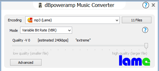

    i create vbr mp3s all the time for audio listening.
    [Attachment 51497 - Click to enlarge]
