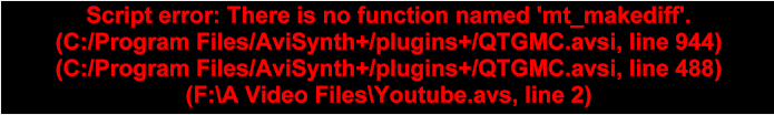

  20. Installed avisynth 3.4 and AvsPmod has opened successfully. I'm absolutely stumped at this error though.
  21. I think you need a newer smdegrain.avsi version
    v3.1.2.101s or newer
    https://forum.doom9.org/showpost.php?p=1790702&postcount=3
  22. Ah, i had v3.1.2.93s installed.
    Now there's this error. Masktools2 (v2.2.18) is in the plugin folder, but the error remains.
  23. Originally Posted by Master Tape View Post
    Did you mean masktools2.dll ? or in a subfolder ?
    That has to be at the level of the plugins folder
    Or you can use in the script
    LoadPlugin("PATH\masktools2.dll")

    Yes the .dll. I think it was due to not having the correct version of AvsPmod running.
    Tracking down all the correct plugins was quite the task, but low and behold i now have a preview window! Thought i'd never see it again
