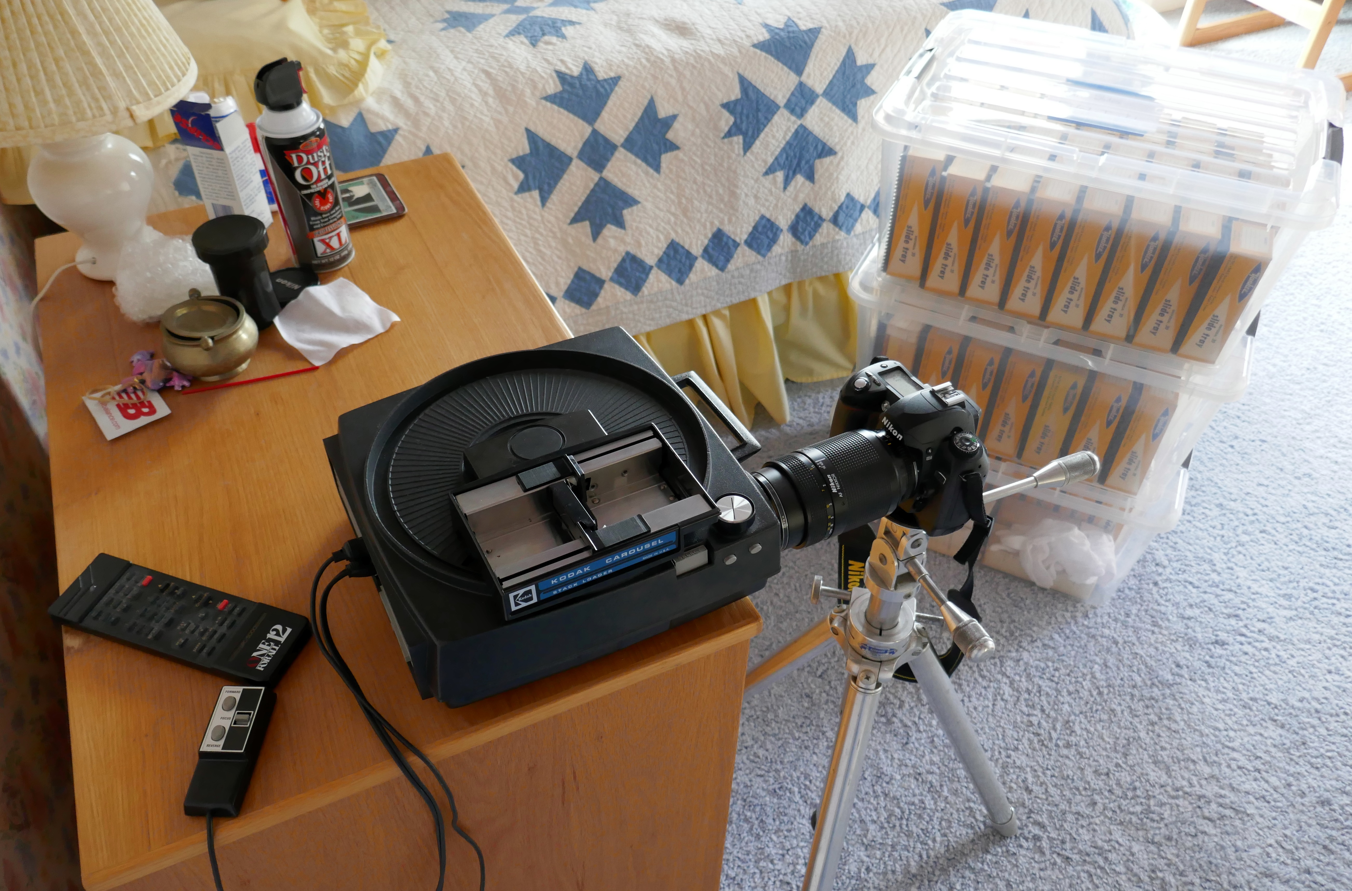

  26. Vuescan is the ultimate scanning program for getting the best quality from your scanner and for doing batch scans. However, I don't know if it will have the accuracy and repeatability to give you well-aligned images, from frame-to-frame. It's worth giving it a try.
    FWIW, it is a lot easier to simply buy a cheap projector on eBay, remove the shutter, put in a telephoto lens, and then grab the image directly from that lens.
    This image shows my slide transfer system, but I did the same thing for 16mm movies using an Eiki sound projector.
    https://forum.videohelp.com/attachment.php?attachmentid=51514&stc=1&d=1579289598
Name:	Slide Transfer System.jpg
