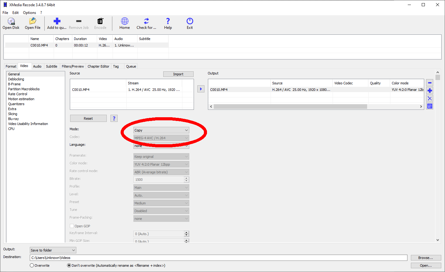

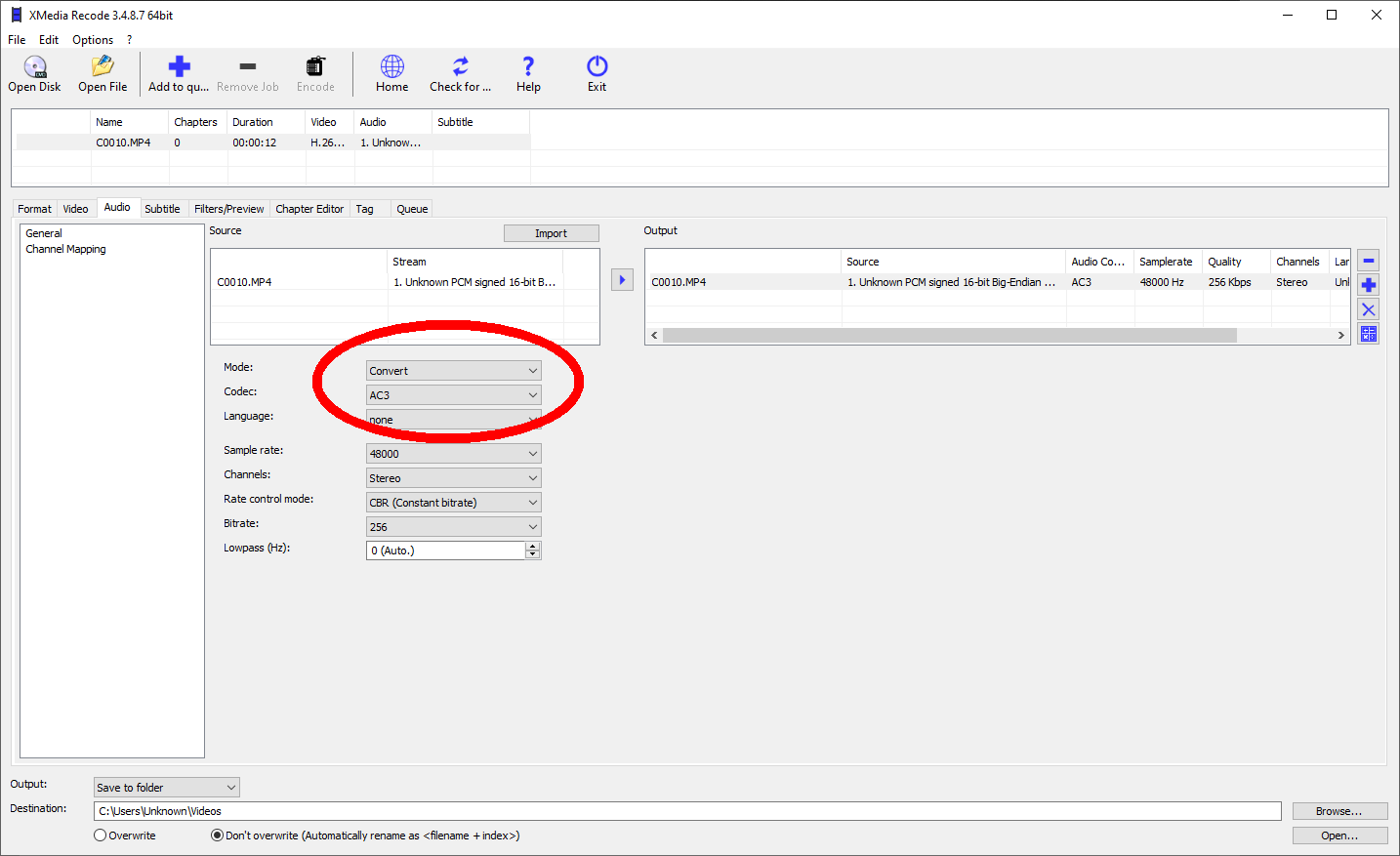

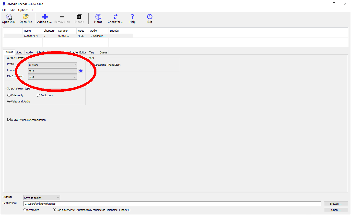

    Well, as far as I can tell you can still do direct copy with the MP4 option WITHOUT the (stream copy) alongside it. I chose regular mp4 as output, and in the other tab still could choose "copy", and also had the "convert" option for audio. I'll attach three pictures to show what I'm talking about.Image
    [Attachment 51437 - Click to enlarge]
    [Attachment 51438 - Click to enlarge]
    [Attachment 51439 - Click to enlarge]
    I tried it, and it worked. I got a list of codecs for audio and successfully cut the video. The final video has sound.
    Thank you very much!
