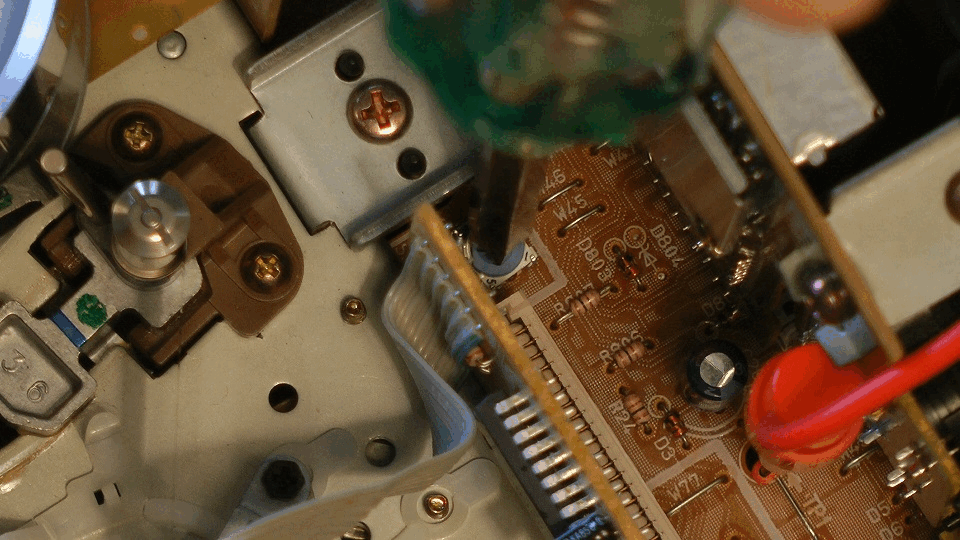

    A current discussion in a grave-dug thread has prompted me to post proof of the method. Just a mini write-up at the moment, not a real guide. But this is a simple procedure once you know where to look inside the machine.

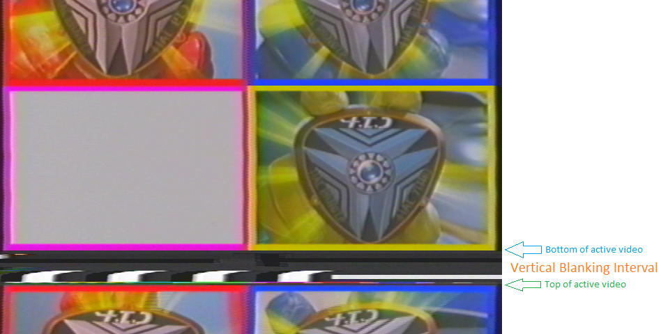

    With my recent usage of a SAA7133 capture card that can be forced to show the Vertical Blanking Interval, it's now easier to demonstrate exactly what's going on.

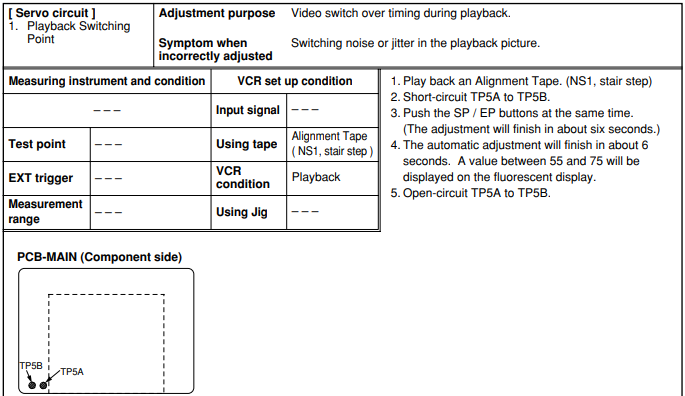

    Internal adjustment of VCR potentiometer
    Panasonic PV-S4670 service manual:
    Our goal here is to intentionally deviate from the spec, so you don't actually need any of the tools/equipment mentioned in the service manual besides the appropriate-sized Phillips-head screwdriver. Unless you want to restore the original setting.
    Warning: Metal screwdrivers are a bad idea for this, at least with the models like PV-S4670 that have a metal support bar right near the PG Shifter pot. I fried mine, and I found out that a guy who read my post fried a PV-S4280 and PV-S4566.

    Similarly, the Mitsubishi HS-HD2000U service manual says how to perform the automatic adjustment of "playback switching point". Nothing about how to manually force it.
