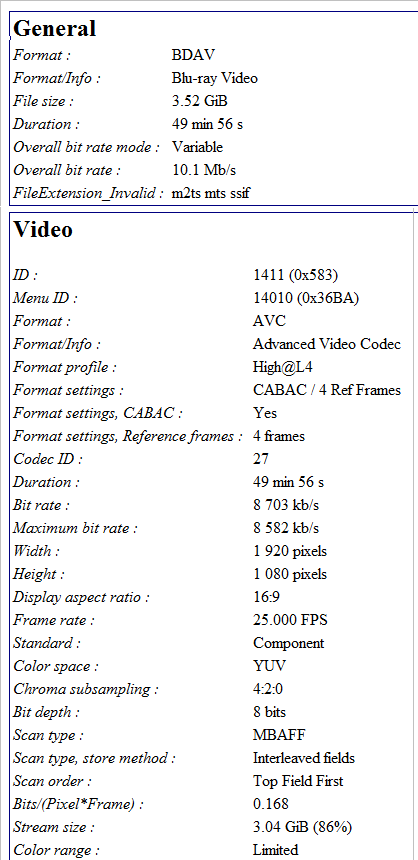

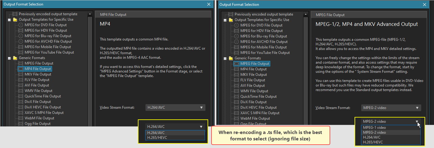

  1. Using TMPGEnc Video Mastering Works (v6.x) I have removed leading and trailing commercials from the video.
    Video = TV recordings in .ts format.
    Media Info - see attachment.
    I could export to .MP4 or "MPEG-2 video"
    I don't care about the file size, but what is important, best quality.
    Note: some time back I selected .mkv but noticed that audio is not entirely in sync with the subtitles, difference of maybe 0,5-1 second or so, which is slightly annoying of course.
    So maybe I should use a different format?
    Am not an expert, or better: am just a newbie in this regards.
    Appreciate suggestions.

    MP4 and MKV are basically the same thing from a beginner's perspective (which I am, don't get me wrong). But Either way you shouldn't be looking to turn it into MPEG2 video codec. You should use MP4/MKV container and keep it the original format (avc). Not sure if TMPGENC Authoring Works does lossless cutting, but there are a lot of programs that do that you can investigate so you don't lose much quality at all. I persanally use Videoredo Suite. If you have to use TMPGEnc and it must re-encode, I would still choose mp4/mkv and leav it AVC.
    But all that aside, the issue of audio sync shouldn't have anything to do with the codecs/containers itself. Sounds like TMPGENC is accidentally messing something up or messing it up by bad design. I capture live tv at times with a capture card and I've tried all sorts of combinations of output files and never have an issue with audio/video synchronization using Videoredo Suite. If you can't figure out how to get TMPGENC to output correct mp4/mkv files from your capture I suggest trying Videoredo. They have a free trial. I'm not trying to market it, I have no stake in their business I just do think it's a very good program especially if main thing you're doing is simple editing like cutting/saving/exporting to different formats.
