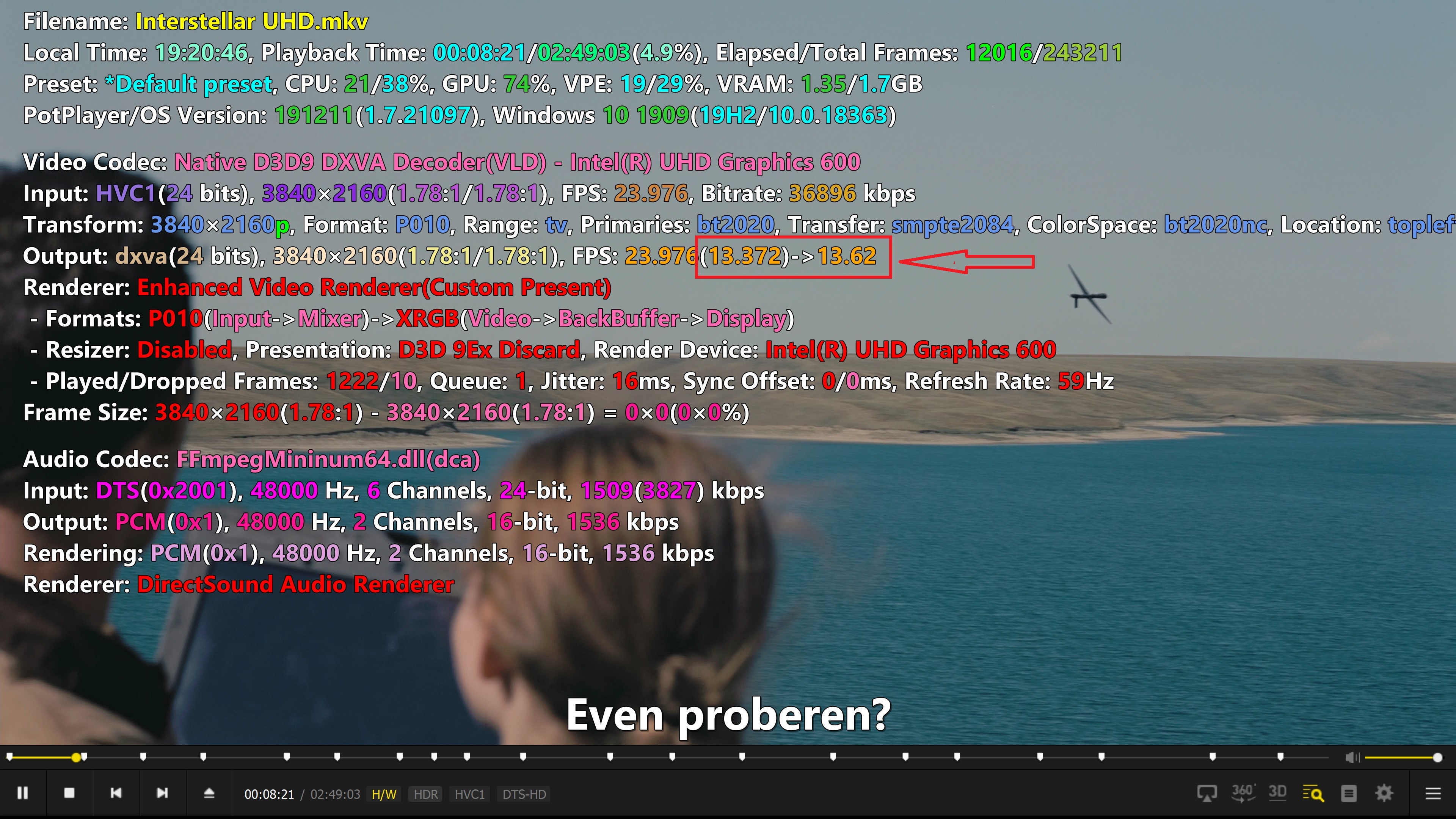

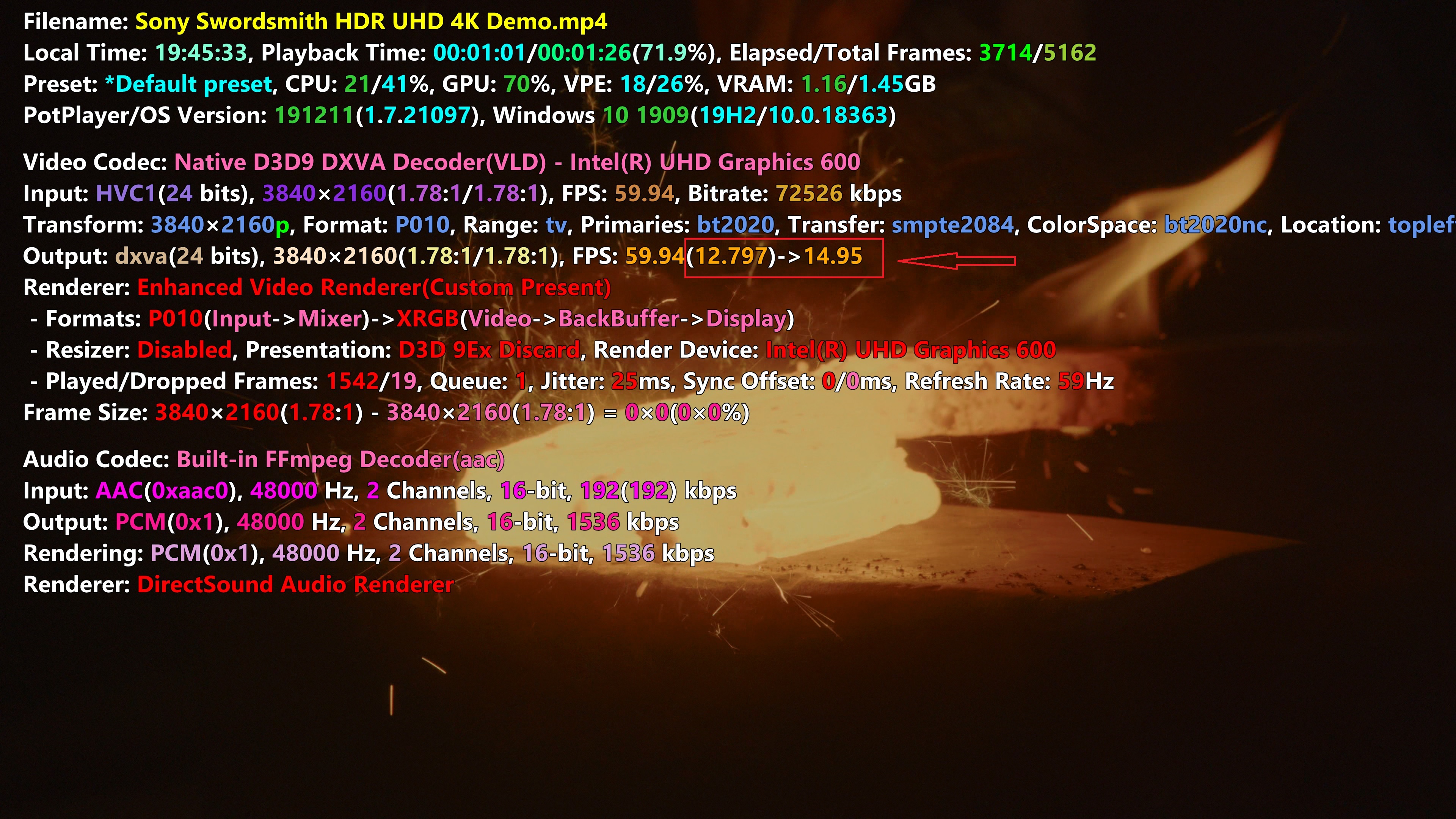

    Ok, so I did a clean install of Windows and installed all updates. Updated all drivers using device manager (no Intel graphic bs installed) and installed only PotPlayer.
    Things are looking a bit brighter since the framedrops are minimal now (still have serious judder though).
    As you can see in the screens below the problem is the FPS being outputed or displayed (not exactly sure what the fps in red is referring to) is different from the source fps (23.976 in screen 1 and 59.94 in screen 2).
    Could anybody identify the possible cause for this based on the info in the screens?
    Thanks guys!!!
    Screen 1 (2160p24)
    [Attachment 51449 - Click to enlarge]
    Screen 2 (2160p60)
    [Attachment 51450 - Click to enlarge]
