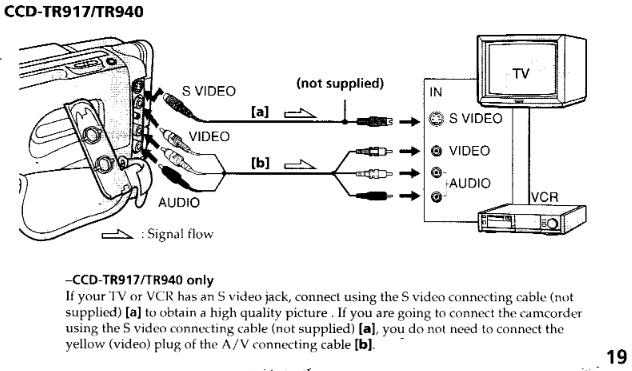

You should definitely use S-Video for Hi8 capture. But know that it doesn't carry audio.
Instead of connecting the yellow plug, connect the S-Video cable. The other connections must remain in place.

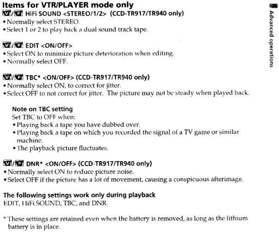

You should also enable the line TBC.
