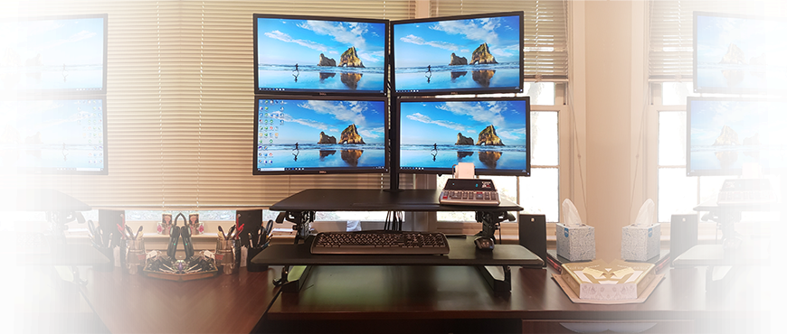

    I have four monitor setup like this:
    [Attachment 51383 - Click to enlarge]

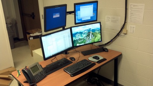

    But it could be different size screens like this:
    [Attachment 51384 - Click to enlarge]
    Note that the top screens are 4:3 at a different resolution.
    Also check that the DB-15 VGA display out works. Some motherboards, will allow only two out of the three video ports to work at once. If it doesn't, you can add cheap VGA card for the output. I was going to suggest a USB to VGA adapter like I have, but see that most don't support Linux.
