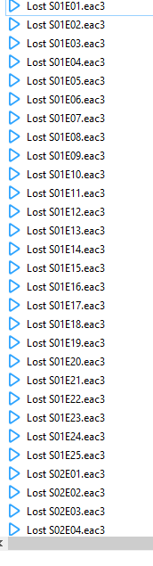

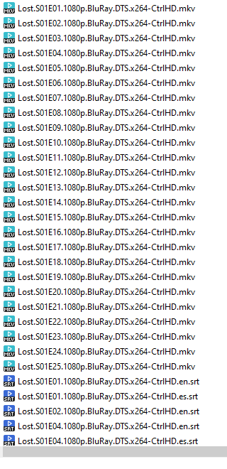

original mkvs look like this: https://forum.videohelp.com/images/imgfiles/6Jk49Jp.png, https://forum.videohelp.com/images/imgfiles/7kAoA4L.png
and audios look like this: https://forum.videohelp.com/images/imgfiles/tcYp7DL.png
do u get the idea? as for not deleting original am fine with it, i can always delete it it manually once i confirm everything was done successfully. -
Well, yes, but it's going to be tricky to give further advice without explicitly mentioning what is shown on those screenshots, which may be at odds with some rules over here !...
As I said, with Bulk Rename Utility it would be easy to rename those .eac3 files so that their names (without the extension) matches that of the corresponding .mkv files, or the other way around (which should be even easier since the part after the episode number appears to be different between folders — with BRU you can for instance remove everything beyond a given position, and replace the extra dot with a space). Then with all the files in the same folder a simple command like this should work :
By the way, it's convenient to have CLI utilities in Windows' "Path", as described here. To avoid doing it for each utility, I created a "CLI" directory on the system partition, and put there all the .exe files I use regularly, more specifically hard links created with Link Shell Extension, which allows to have the same file in several directories on the same partition with no added clutter.Code:for %%I in (*.mkv) do mkvmerge -o "%%~nI [remux].mkv" "%%I" "%%~nI.eac3"
In the command above, I used an upper-case letter for the variable, which is better to avoid confusion with the lower-case modifiers (~n, ~x, ~z...).
The command as it is works as a .bat script, if executing it from the command prompt, only one percent sign must be used, "%I" instead of "%%I".
You can replace "[remux]" by anything you want, for instance the language of the added audio track.
You could refine the muxing scheme by specifying the order of each audio track, and which one should be played by default. The most convenient way to do that is to set it as intended for one file through MKVToolNix GUI, then copy the command line, then adapt the script accordingly with the complimentary switches and parameters.
