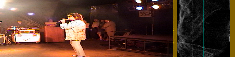

The contrast of the very brightest part of the image alternates every half-field, for some reason.
Single field
Code:AVISource("DV.avi",pixel_type="YUY2") ColorYUV(off_y=-16,gain_y=-4) SeparateFields() Histogram()
[Attachment 51339 - Click to enlarge]
Split into two. If you open the images below in two different tabs in your browser and switch quickly between them you can see how the center of the image flickers from near-white to true white and the brightest part of the histogram jumps up to fully-clipped in the second image.

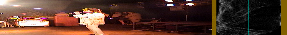

Code:AVISource("DV.avi",pixel_type="YUY2") ColorYUV(off_y=-16,gain_y=-4) SeparateFields() AssumeFrameBased().SeparateFields() Histogram()
[Attachment 51340 - Click to enlarge]
[Attachment 51341 - Click to enlarge]
I don't know how you might fix it so both halves are exposed the same.
