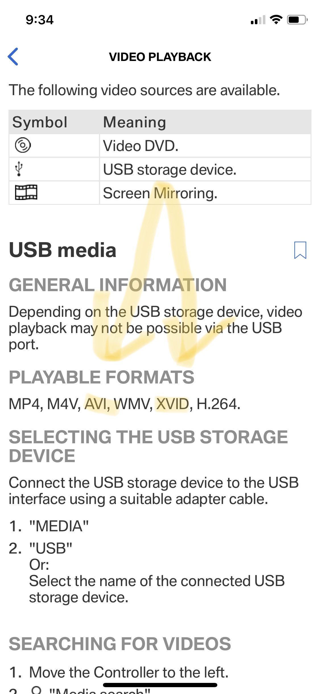

    I wish it was the case here (see the attached car's specs). After speaking to all of you I decided to go through the manual to only discover that the car should be playing both. Moreover, I used to have that same car with an older OS that played anything I threw at it. Lucky me got a new model with the brand spanking new OS this year.
Name:	bmw supported video formats.jpg
  11. Dinosaur Supervisor KarMa's Avatar
    Jul 2015
    US
    The car supports MP4, just use that for h.264.
    I have 4 TB of avi movies (approx 1.3 gb per movie). To convert them to MP4 would take me days . I'm not a pro, this is purely on my recent experience where I did just that for a few movies to prep for a long road trip.
    This forum has been incredibly helpful. Thank you everyone for steering me to the right direction. Learned quite a few tricks and discovered useful softwares.
