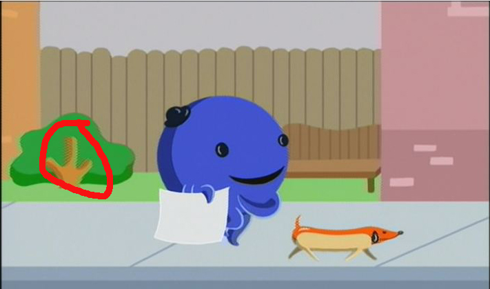

I have a DVD that plays awfully on TV from players, the edges have combs. The situation is a bit better in VLC player, but still not perfect. I decrypted the DVD with DVDDecrypter, and imported the DVD library to Vegas, and was experimenting with rendering it though Frameserver doing a QTGMC deinterlace. At the moment I am checking the outcome with AvsPmod.
The problem is, after applying QTGMC, there are still combs at certain places. You can see it on the photo below, I marked the problematic fields:
The script is:
Code:AviSource("C:\Users\Documents\video.avi") ConvertToYV12() AssumeTFF() QTGMC(Preset="Slower",FPSDivisor=2)
[Attachment 51326 - Click to enlarge]

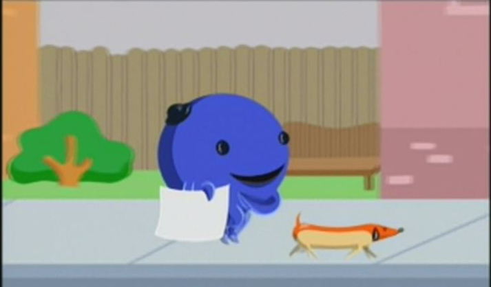

In case I use the following script, the combs disappear from the places marked, but the image of course becomes very very blurry:
Code:AviSource("C:\Users\Documents\video.avi") ConvertToYV12() AssumeTFF() BilinearResize(310,240) QTGMC(Preset="Slower",FPSDivisor=2) Spline64Resize(720,480)
[Attachment 51327 - Click to enlarge]
Any ideas to improve this?

Those are dot crawl artifacts, not interlace combing. There are ways to reduce them:
http://avisynth.nl/index.php/External_filters#Rainbow_.26_Dot_Crawl_Removal
But they look a little unusual. I'll take a closer look later today. -
Yes, I was going to mention that earlier. The video should not be deinterlaced (QTGMC) but rather inverse telecined. Here's what I came up with:
Adding a strong, motion compensated, temporal noise filter like TemporalDegrain2() will remove most of the remaining dot crawl. But it will take much longer to filter.Code:Mpeg2Source("video.d2v", CPU2="ooooxx", Info=3) Crop(8,0,-8,-0, align=true) CheckMate(thr=10, max=20, tthr2=0) SeparateFields() VInverse() Weave() TFM(d2v="video.d2v") TDecimate() Santiag() aWarpSharp2(depth=10)Last edited by jagabo; 3rd Jan 2020 at 21:29.
