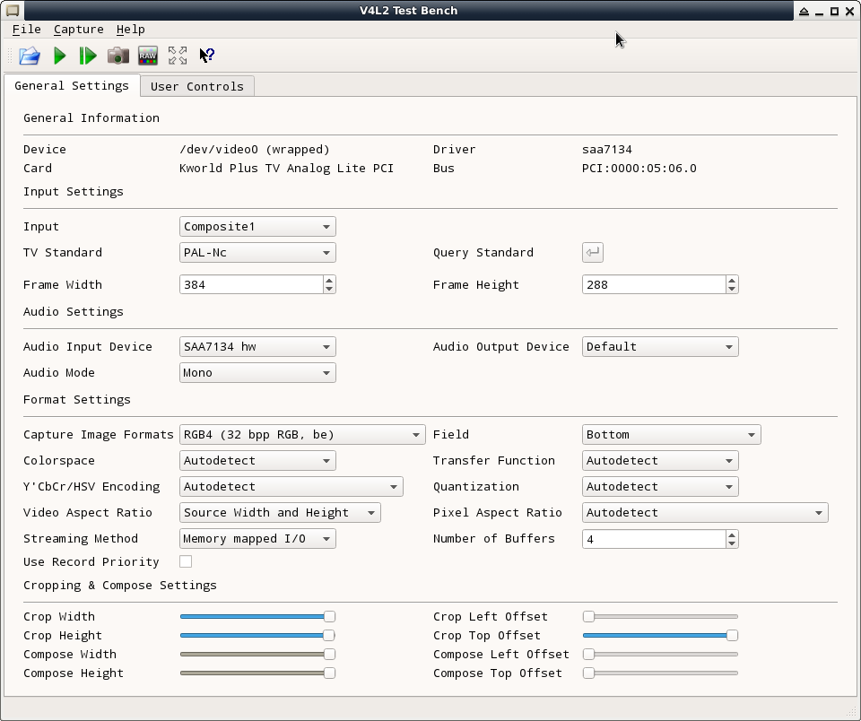

I have been playing with QV4L2, but I have had no luck. What parameters do you think I should tweak to see if this issue goes away?
