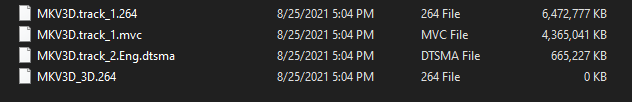

    I uninstalled avisynth, and installed AviSynthPlus_3.7.0_20210111_vcredist.exe and it's still crashing before the mux operation seemingly at random times. I have attached a screenshot of the files, and I wanted to ask, I have been using ENCODE_3D_LAUNCHER, that's what I'm supposed to use, correct? Image
    [Attachment 60441 - Click to enlarge]
    [Attachment 60440 - Click to enlarge]
  4. Originally Posted by MajinDustin View Post
    Yes. You may want to try to launch directly __ENCODE_3D.cmd that does basically the same thing, but at normal priority and without the trick to avoid entering sleep mode during the encoding. IMO, you will have exactly the same problem.
    I see that the MKV3D_3D.264 file (normally created during the encoding phase) is empty. That means probably that the program crashes immediately. Also, the file name suggests that you are encoding from a MKV created with MakeMKV. Fine, but perhaps MakeMKV is the culprit, for example if something has changed in the way it muxes the 3D MKV file. I will do a test here, but be patient. Currently, I don't have much time for that kind of work...

  5. Originally Posted by r0lZ View Post
    I understand, thanks again for the help! I will try the other method and let you know! Also in this particular instance it did crash immediately, but it does seem to be random times while encoding.

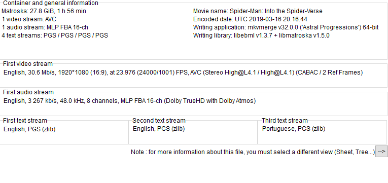

    Hi r0lZ. Thank you very much for your reply. What I wanted to know was that if my MKV has only TrueHD available, how would I get sound with the extracted video. Based on your reply it seems that you can just select the AC3 at the bottom to extract the AC3 or convert the TrueHD to AC3. I'm not sure. I'm asking because according to the image I have to do something else. I'm also confused about the fact that a second demux has to be done.
    [Attachment 62475 - Click to enlarge]
  21. Oh, yes, I forgot that point.
    Indeed, the default demuxer used by BD3D2MK3D is tsMuxeR, and unfortunately it is unable to demux the THD track properly. But if you decide to keep it, BD3D2MK3D will do the whole demux with tsMuxeR, with the exception of the THD track. Then, a second demux will be launched, this time to extract only the THD track with eac3to. Don't worry, it's automatic, and that should work without problem. The only drawback is that demuxing a BD takes a long time, and two consecutive demuxes are very long. (BTW, BD3D2MK3D doesn't use eac3to to demux everything, because it has several problems, especially with the subtitles of many 3DBD. Therefore, tsMuxeR is better, but it has also the THD limitation, that eac3to doesn't have.)
    Also, I see that you are using a MKV produced by MakeMKV as input. That's fine, but as I have explained in my previous post, the "double AC3+THD" audio stream of the BD cannot be kept in the MKV. Therefore, you have to select either the THD or the AC3 option (or both) in MakeMKV. If you select the AC3 stream, of course, the second demux pass will not be necessary and you will keep the original AC3 "pseudo-core" stream from the BD.
    In both case, the "Use 5.1 core" option is not present in BD3D2MK3D, because the selection of THD or AC3 has already be done with MakeMKV and there is only a single AC3 OR THD track remaining in the input MKV. You can of course use the option to convert the THD track to AC3, but it's a pity, as a re-encoding will be necessary, and the quality will be slightly less good than selecting directly the AC3 stream in MakeMKV, and that will also take some time.
    To select the AC3 5.1 track in MakeMKV, you have to click the > button next to the title you want to copy to expand the list of streams, then you can unselect the TrueHD 7.1 track and select the DD Surround 5.1 track just beneath it. (MakeMKV uses "DD" instead of "AC3".) By default, the two versions are selected, and therefore you should be able to do the final selection in BD3D2MK3D, or to keep both streams.
    In summary, if you want to keep the THD track, just ignore the warning, and let BD3D2MK3D do the two demux passes. Otherwise, be sure to select the DD stream in MakeMKV instead of or in addition to the THD track.

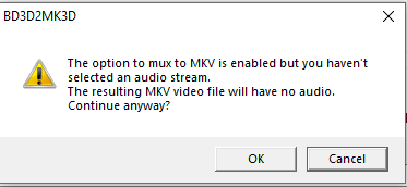

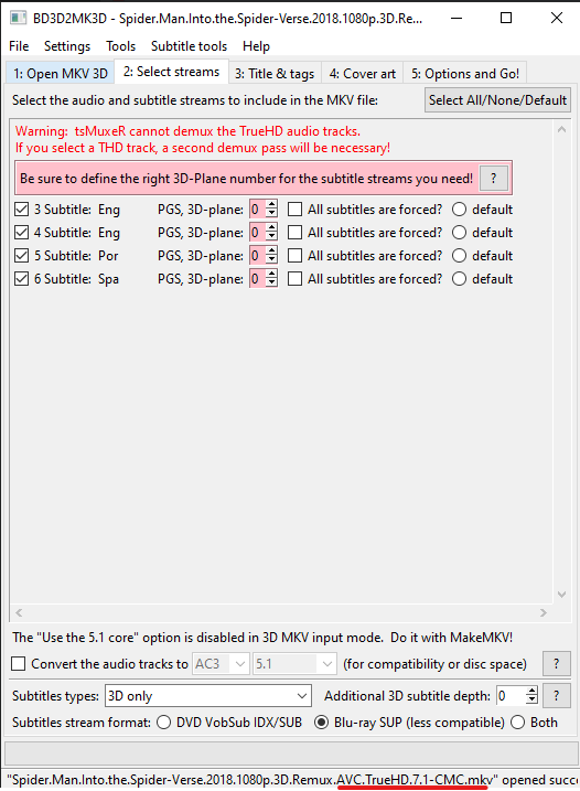

    Thank you again. I have one last problem. It seems BD3D2MK3D is not showing my audio stream. So I get this error.

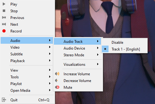

    Playing the file in VLC shows that I do have an audio track in the video file.

  25. Damn ! I don't remember that. I will have a look...

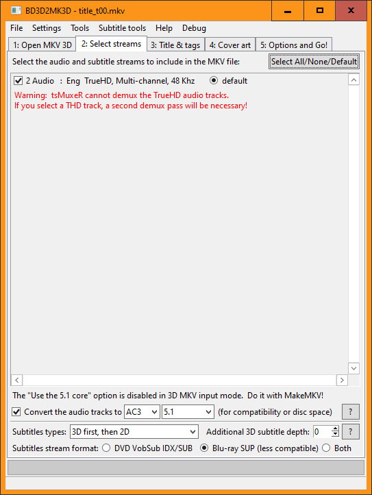

  26. Image
    [Attachment 62480 - Click to enlarge]
    Well, I did two complete tests, and everything works perfectly. The THD stream appears in tab 2, where you can select it. And it is correctly demuxed with eac3to. So, sorry, but I don't understand what is causing the problem, and I can't help much more. Try again with a good source.

  28. I don't know. If BD3D2MK3D doesn't show the THD source, it's for a good reason. But you can try to demux the THD source manually with, for example, gMkvExtractGUI, and process the video alone with BD3D2MK3D (ignoring the No Audio warning). Finally, you will have to remux the new MKV and the THD audio together to create the final MKV with audio with MkvToolnix. If the demux of the audio works correctly, the rest should be straightforward.
    Oops, no, it's even simpler. You don't need gMkvExtractGUI. Just install MkvToolnix, and create the SBS MKV without audio with BD3D2MK3D. When it is finished, load it in the MkvToolnixGUI, and add the original MKV in the MkvToolnixGUI as a new source. Deselect the video and subtitle tracks you don't need, and leave only all tracks from the SBS and the audio from the original MKV. Save. Again, if the audio is accepted, that should work.
