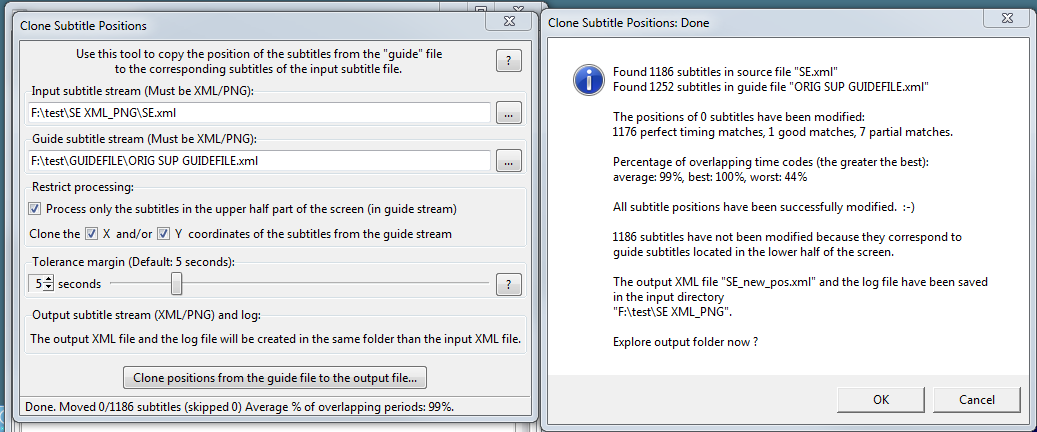

    In the "Clone Subtitles Positions" tool, did an old bug sneak in again?
    When I check to process only the subs in the upper half part of the screen, "X & Y" and "Y only" coordinates are not copied from the guidefile to the exported xml-file.
    I didn't check "X only" btw. Could you please have a look?
    Thanks in advance
  10. Well, I can't find any bug.
    Maybe it's the way it works that is not very clear. The option to process only the upper subtitles works only if the subtitle OF THE GUIDE is in the upper part of the screen. If the subtitle in the original file is in the upper part of the screen but the subtitle in the guide is in the lower part of the screen, nothing will be modified. IMO, it's normal, as that option is primarily intended to align the subtitles generated from a SRT file (and therefore always in the lower part of the screen) with a guide from the original BD (possibly with upper subtitles). It's indicated in the GUI: "Process only the subtitles in the upper half part of the screen (in guide stream)".
    My tests did exactly that. The x and y positions of the upper subtitles of the guide are cloned if the two options are selected. If only Y is selected, only the Y position is cloned. It is not possible to clone only the X position, as there is no sense to move the subtitle along the X axis if it is not at the correct position along the Y axis.

  11. Member Ennio's Avatar
    May 2005
    Netherlands
    Hi r0lZ,
    I still have the issue, it bugs me. Check out the screenshot.
    [Attachment 59425 - Click to enlarge]
    Here I checked the "upper half" and both X and Y. The output screen says that subtitles haven't been modified because the guide subs are in the lower half of the screen. They certainly are not.

    Obviously the first subtitles are in the upper half. So, there should be no mentioning that all subs are in the lower half. It's also mentioned when upper half is checked and with "Y only" checked.
    When "upper half" is NOT checked, things are fine for both "X and Y" and "Y only". I tested with 2 guidefiles. Same result. Is it possible my guidefiles are corrupt? I do them like I do for years: load the original SUP in BDSup2Sub and then export as XML/PNG.
    FYI I tried with previous version 1.21, but it stays the same

  12. Well, perhaps the subtitles in the upper part of the screen are displayed exactly when there are no subtitles in the source stream. There are more subtitles in the guide, and if the timings of the additional subs do not correspond to subtitles in the source file, they are ignored anyway, regardless of the options you have selected.
    I can check it myself if you wish. Send me the two XML files (not the PNG please), and I will have a look...

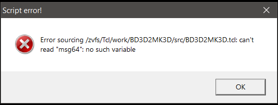

  25. Image
    [Attachment 60420 - Click to enlarge]
    Cannot run BD3D2MK3D because of the above error on start. Suggestions?

  28. Originally Posted by MarkS-Indy View Post
    Strange. This error should never happen. Perhaps it's an old bug, fixed recently. Are you using the latest version ? Anyway, try to download BD3D2MK3D again, and re-install it.
    This error happens when the program checks if anysynth 64-bit is properly installed. Try to re-install it. It's probably sufficient to avoid the problem.
    Do you have an old 32-bit computer ?

  30. Originally Posted by r0lZ View Post
    I believe I am trying to use the latest version, compiled in January 2021. My PC is 64 bit, AMD Ryzen 5 2400, 16G RAM, Windows 10 64bit.
    I have been unable to find a version of AviSynth that wants to install in the Program Files directory. Version 2.5.8 wants to install in the Program Files (x86) directory.
