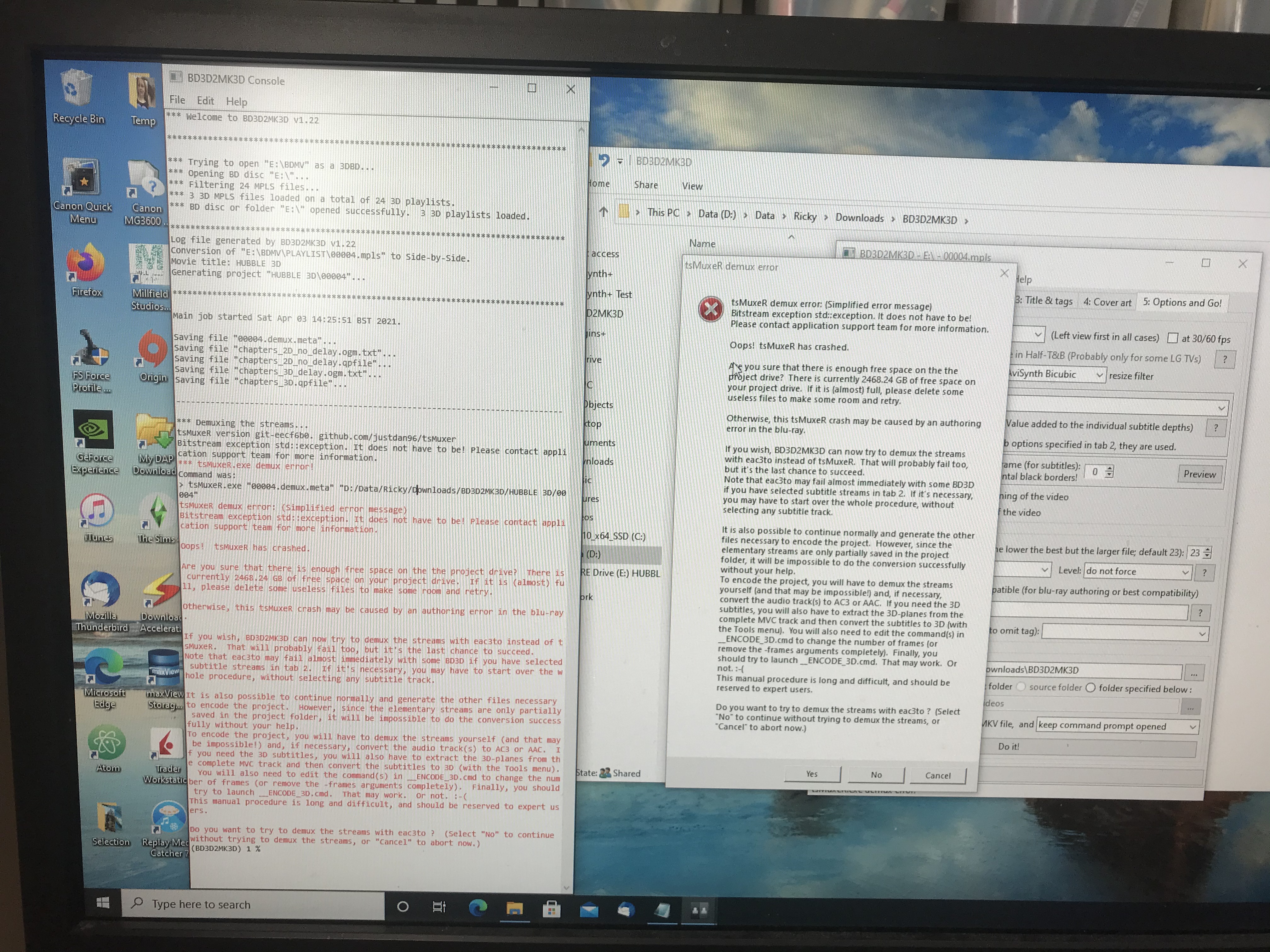

  10. Hi! A few years ago I used your tool to process a number of different BlueRay 3D movies and it worked perfectly every time.
    I recently bought a 3D capable projector which has rekindled my interest in 3D and so have bought a pile of good movies on 3D BlueRay to convert. I convert to side by side HD so that I can store on my iTunes server and use with my gen 3 Apple TV.
    Last week I downloaded the latest version of your tool and tried to process two movies. Both failed for the same reason. Tsmuxer crashed. I was trying to process Hubble 3D and Star Trek Beyond in 3D.
    I have since tried using both the previous versions of BD3D2MK3D and tsmuxer crashes there too. I am using the same BlueRay player, the same decryption driver (which is working perfectly). The only differences in the machine since I last used your tool are the faster processor (same generation) and a higher spec. ASUS motherboard.
    Screenshots of the error messages are here:
    https://files.videohelp.com/u/299032/9647B01C-D6FC-49F0-99F3-6ECD9C66B6A7.jpeg
    https://files.videohelp.com/u/299032/BC7936DD-E18A-439C-9D4F-5E8C3102DC0A.jpeg
    Regards and many thanks,
    Richard
  11. Hi! A few years ago I used your brilliant tool and it worked perfectly.
    I have just tried to use the latest version and have run into a problem with a crash. It seems that tsMuxeR is crashing, throwing a demux error.
    I tried a couple of different BlueRay disks and have also tried to use the two old versions of BD3D2MK3D that I successfully used before but had no success.
    Here is a screen shot of the problem:
    https://forum.videohelp.com/attachment.php?attachmentid=58229&d=1617485405
    Regards
    Richard
  12. Hum, strange. I have never encountered that error, and you are the first person reporting it.
    Have you tried the suggestion to demux the BD with eac3to ? Does it work ?
    Anyway, it seems that the problem is related to txMuxeR and/or your BD, and not directly to BD3D2MK3D. Perhaps you should report the problem at the tsMuxeR thread at Doom9. Also, try to replace txMuxeR.exe with the latest nightly build. Since tsMuxeR is again heavily developed, a bug may have been fixed.
    r0lZ - PgcEdit homepage Hosted by VideoHelp (Thanks Baldrick)
    - BD3D2MK3D A tool to convert 3D BD to 3D SBS/T&B/FS MKV
  13. Thank you very much for the reply. I did indeed try the fallback to eac3to and that also failed. That failure is shown on the second screenshot.
    I will try using the latest build of tsMuxeR and will export back. I have tried more than one BD but to tie things down I will try with a disk I successfully processed a few years ago. After I try those two suggestions I will post the problem on the tsMuxeR thread as you kindly suggested.
    Best regards and many thanks,
    Richard
