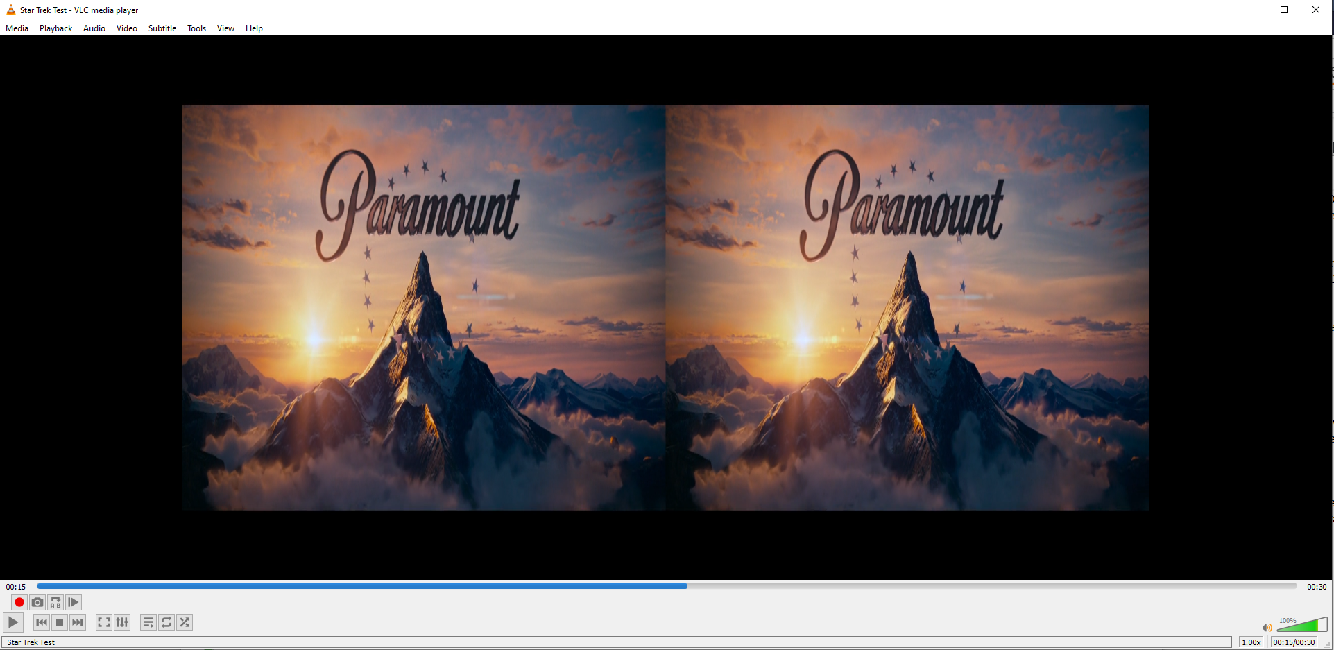

  5. I'm hoping someone can help me because I must be doing something wrong. I'm trying to use MakeMKV 1.15.3 and BD3D2MK3D 1.2 to rip some of my 3D blu-rays for playback on an Oculus Rift 2. The problem that I'm running into is that the left and right images are not being reassembled by the player correctly, which I suspect is something in the tags and not so much in the actual video files themselves. I'm using defaults everywhere for half (and tried full) side-by-side. The opening Paramount logo, for example, has the Paramount mountain dead center. However, what I see is the left half of the image touching the right edge of the screen and the right half of the image touching the left edge of the screen so instead of () I see )(, if that makes sense. 2D playback looks fine, opening the file in VLC appears to show the right and left halves at the same time and they look fine as well, so I just don't understand why the 3D player is struggling with it (I've tried two different players, BigscreenVR and GizmoVR. I downloaded a sample SBS file online and that had no problems. Ideas?
  6. I have no experience with your VR players, so I can't help directly, but can you post here an image extracted from the sample SBS you have downloaded, or just post here the link where I can download the sample myself ? Perhaps that will help me.
    Can you confirm that the aspect ratio of the movie created by BD3D2MK3D is correct (the image doesn't look stretched in a specific direction) ?
    Also, have you checked BD3D2MK3D with several movies, or just one ? It is possible that a movie reacts differently for some reason.
    r0lZ - PgcEdit homepage Hosted by VideoHelp (Thanks Baldrick)
    - BD3D2MK3D A tool to convert 3D BD to 3D SBS/T&B/FS MKV
  7. I'm guessing that it's something in the metadata for aspect ratio or the like that is causing the issue because the image "looks" fine, see attached. But what I do notice is that unlike the sample video I downloaded, VLC is not properly stretching this video to take up the whole screen, so for some reason those black borders on the side appear to be messing with how the player reassemble the video into a 3D image. FFPROBE gives the following information but I'm happy to provide whatever will help me get to the bottom of this. This was done as a Full SBS with all defaults selected to my knowledge.

  8. Unfortunately, there is no well designed standard for Full-SBS, and the aspect ratio necessary for a specific player may be different than for another one. It's why, in BD3D2MK3D, there are two options to change the aspect ratio for full-SBS : see the menu Settings -> Full-SBS/T&B Aspect Ratio. The aspect ratio is saved in two different locations, hence the two options, but most players take only one of them into account. Change the two options and try again with a short clip.
    For Half-SBS, the standard is well defined, and should be OK for all players, including for VR. But it might be necessary to configure the player for the correct Half/Full mode.
  9. Thanks for those hints. I tried switching both the full/half setting as well as changing the AR setting but that didn't seem to make any difference, the output always looks the same in both players I try.
    Does this sample help?

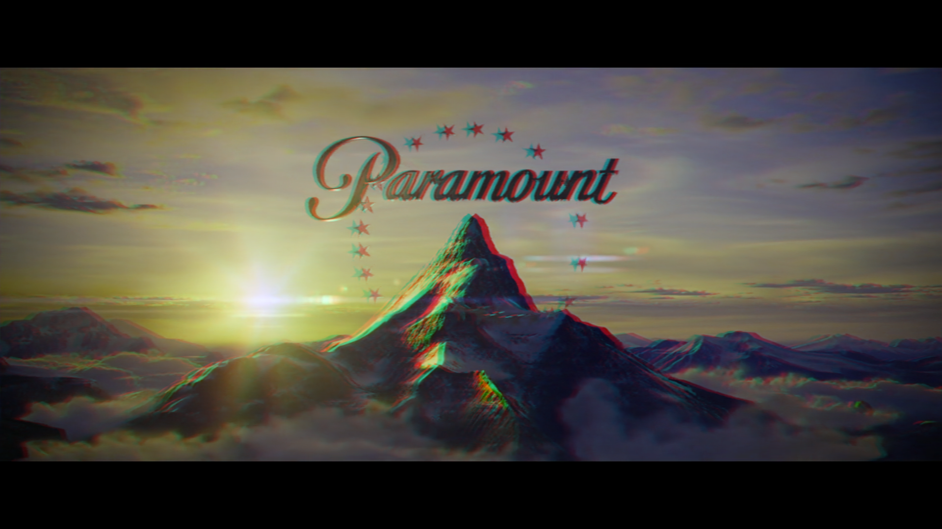

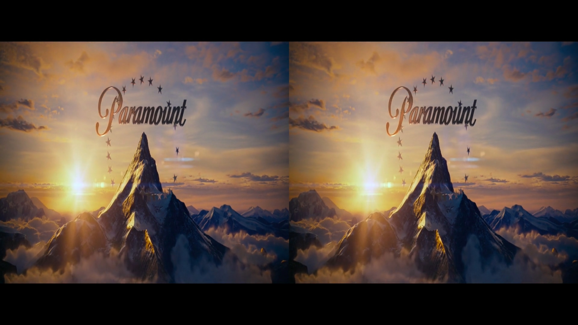

  10. Well, the sample is encoded in HSBS with BD3D2MK3D, and it is IMO perfect. Full screen as it should (with only black borders above and below the picture due to the original Cinemascope format). A good 3D player should display it correctly. I'm not sure why the VR players display it wrongly. Perhaps there is a setting to change somewhere, but the two AR in the sample are correct, since there is no other choice for HSBS.
    BTW, please do not test 3D material with VLC. Use a real 3D player like PotPlayer. Or extract the source image directly from the video clip, and do not post a screen capture of the player's window. In your capture above, the vertical black borders have been added at playback time by PotPlayer itself, to fill the empty space between the image and the border of the window. It's obviously not a problem in the video.
    Here is a capture of an image from your sample made with PotPlayer. As you can see, there is no useless black border.
    [Attachment 56028 - Click to enlarge]
    When the correct 3D options are used, the AR is correct, like with this anaglyph rendering, again with PotPlayer :
    [Attachment 56029 - Click to enlarge]
    Sorry, but I can't help much more. Try to contact the authors of the VR players to get some help. And if you find the issue, please post the explanation here. I'm curious to know what's the source of the problem, and perhaps I will modify slightly BD3D2MK3D if it is sufficient to solve the problem.
