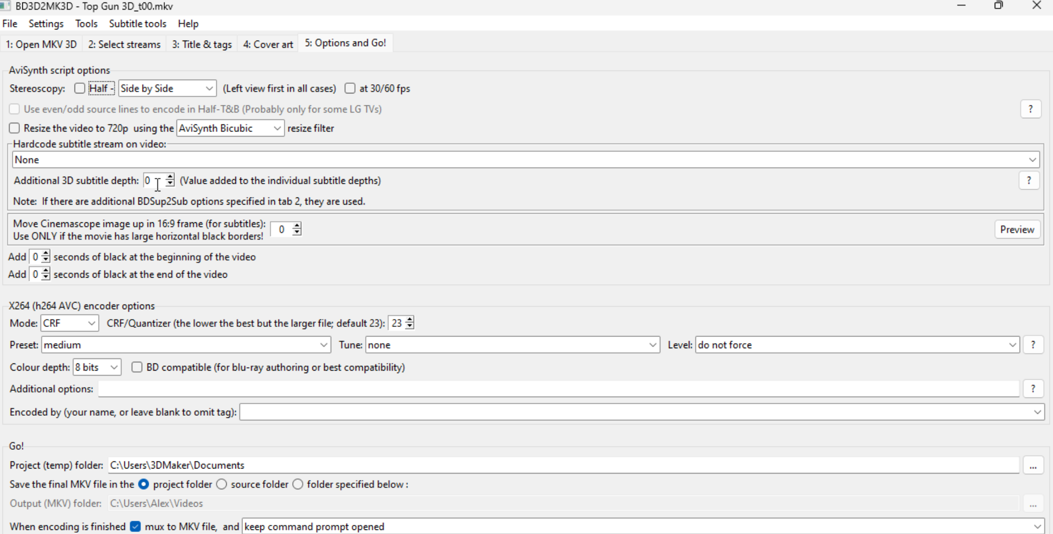

  14. Hello!
    I have a weird issue where output Full SBS 3D movies don't display correctly without having to change the aspect ratio in the player, unless transcoded or re-encoded through handbrake first.
    Seems like something BD3D2MK3D should be able to handle, without requiring an extra steps, considering it encodes the 3D movie in h264 just like handbrake.
    I leave everything as default except for unchecking the "Half" checkbox.
    [Attachment 87686 - Click to enlarge]
    What setting am I missing?
  15. Look at my last post, just above yours.
    r0lZ - PgcEdit homepage Hosted by VideoHelp (Thanks Baldrick)
    - BD3D2MK3D A tool to convert 3D BD to 3D SBS/T&B/FS MKV
  16. Originally Posted by r0lZ View Post
    Unfortunately, that's not the solution. Using "Use respectively 32:9 or 16:18...", just creates a problem on the other end.
    It displays correctly when direct playing but doesn't when transcoded.
    I need it to display correctly in both cases, direct play and transcoded, like it does when I take the output of BD3D2MK3D with the aspect ratio set to "Use 16:9 AR...." and run it through handbrake.
    I'd like to eliminate having to run it through handbrake if possible.
  17. Have you also tried changing the SAR?
    Anyway, with these two settings, you have everything related to the aspect ratio. I can't do more.
