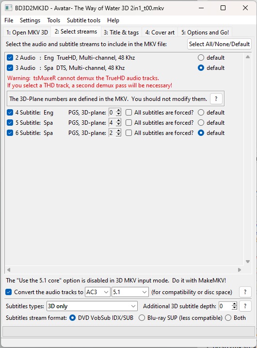

  26. Member
    Sep 2023
    Spain
    Good night.
    I have a problem with subtitles when playing HSBS movies created with BD3D2MK3D.
    I give the example with the movie Avatar the way of the water. The image itself has certain subtitles burned into it. So far good. The problem comes with the forced subtitles. Despite seeing the image correctly, I see the forced subtitles of my language in duplicate. They are read perfectly with glasses but I see the same subtitle twice. On the left side of the screen and on the right side as well. Like when the two images are unassembled. I don't know if I explain myself. The image is assembled and can be seen perfectly but the subtitles are not. Do I have to put something specific in the subtitle options of the BD3D2MK3D menu?? If I play the movie in skybox VR with my HP reverb G2, although the forced subtitles look exaggeratedly large, a single subtitle is read and in this case I do not read it twice (left and right side of the screen)
    Let's see if you can give me a hand.
    Thank you very much in advance
    P.S.: I attach an image of the options I selected when making the conversion
  27. Let me explain. To be pleasant to look at, subtitles must be placed at the required depth in the 3D scene. If they are placed too far into the scene, they will penetrate foreground objects, and if they are too close to the viewer, the latter will have to constantly change the focus of his eyes, on the scene and on the subtitles. This is why subtitles, like the main image, must be displayed in 3D.
    In the original BD3D, the subtitles themselves are always in 2D, but the video stream contains information (called 3D-Planes or Offset Sequences) that instructs the player how they should be displayed in 3D. The horizontal displacement of the right-eye subtitle relative to the left-eye subtitle determines the depth at which it will be displayed. Offset Sequences determine this displacement. Unfortunately, this system is specific to blu-rays, and is lost when the film is converted to SBS (or any other format).
    This is why BD3D2MK3D can convert subtitles to 3D. They are then placed on either side of the image (for SBS), with the displacement specified by the BD3D offset sequence values.
    To be visible normally and in their correct depth position, the player must process them in the same way as the 3D image, i.e. by dividing them in two, and displaying each half for the eye for which it is intended.
    A good video player should be able to display the subtitle on the composite image before splitting it and resizing the two halves. When this is done correctly, subtitles are displayed in 3D at their correct depth. But the player can also display the subtitle AFTER splitting and resizing, and this gives the result you've seen.
    Perhaps your player has a setting to indicate whether the subtitle should be displayed before or after the image split. If this is the case (as with PotPlayer), simply change this parameter. If not, there's really no good solution.
    BD3D2NK3D lets you save subtitles in 3D (as explained above), but also in 2D. In this case, the subtitle will be displayed on the surface of the screen, with all the disadvantages of the bad depth, which can be a real torture for the eyes and the brain! Anyway, il might be a good idea to keep both formats, as you will be able to select the best one for the current player. See the bottom of tab 2.
    But there is another solution. In the last tab, you'll see that you can burn (aka hardcode) subtitles into the image. The disadvantages are that there's no way to disable them, or to keep different subtitles in different languages, but all players will display the subtitles in good 3D, without you having to figure out how to set up the player. It's exactly like the Na'vi subtitles in Avatar. Personally, this is the method I recommend. Unfortunately for you, to use that method, you will have to convert your movie again. (Note that if you select a subtitle stream to hardcode it, you don't need to select it also in tab 2.)
    I hope this helps.

    Thank you very much for your great explanation.
    I continue testing and this time I set the subtitle type dropdown to ONLY 2D and they do appear correctly on my Panasonic Viera TV player. However, in Skybox VR with my HP Reverb G2 they still look good but huge (they take up almost the entire width of the movie theater screen)
    I'm going to continue doing more tests and I'll tell you, but I repeat, thank you very much for the long explanation you gave me r0lZ
