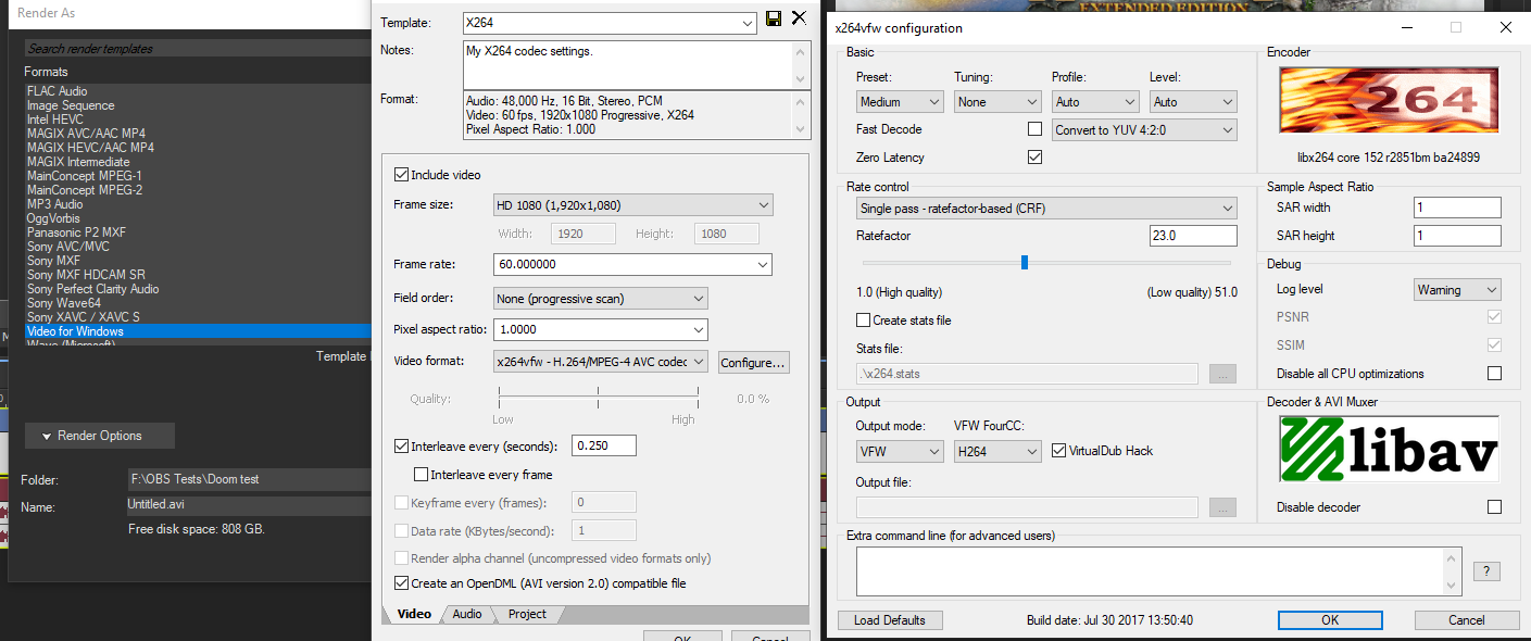

    So a few years back i used to use FRAPS to pretty much record Youtube videos and then compress them using Virtualdub and the x264xfw codec. Since fraps hasn't been updated in ages as well as being a huge drain on system resources i went and looked for alternatives. One suggested to me was OBS using the NVENC encoder on my GPU with something like a CQP rate of 15 and while the source file is pretty good its stilll a bit big. A 7 Minute video of a modern game (in this case DOOM 2016) was about 4.14GB while an older game like Age of Mythology Extended edition, a RTS game was about 8.37GB for 30 minutes.
    Now i do have a decent net connection at 100/40 with unlimited data so it really wouldn't be an issue uploading these sizes yet I'm a little worried with storage for such big files and would just rather keep the rendered/compressed versions like i did after i was done with the FRAPS videos. I would like to also add intros to my videos (I'm currently messing around with Sony Vegas 15 i got from humble bundle) and that usually involves more rendering and more generational loss since its already recorded as NVENC H.264 so I'm at a little loss what to do here. I've been asking friends on some opinions when i do render with a few settings and their opinions on what looks best vary.

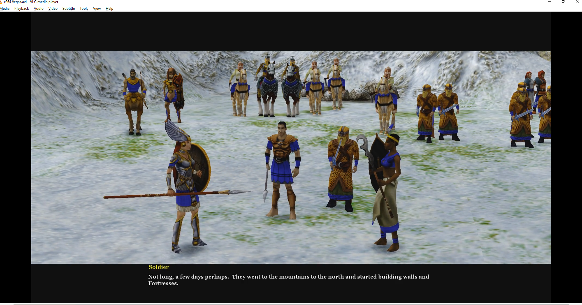

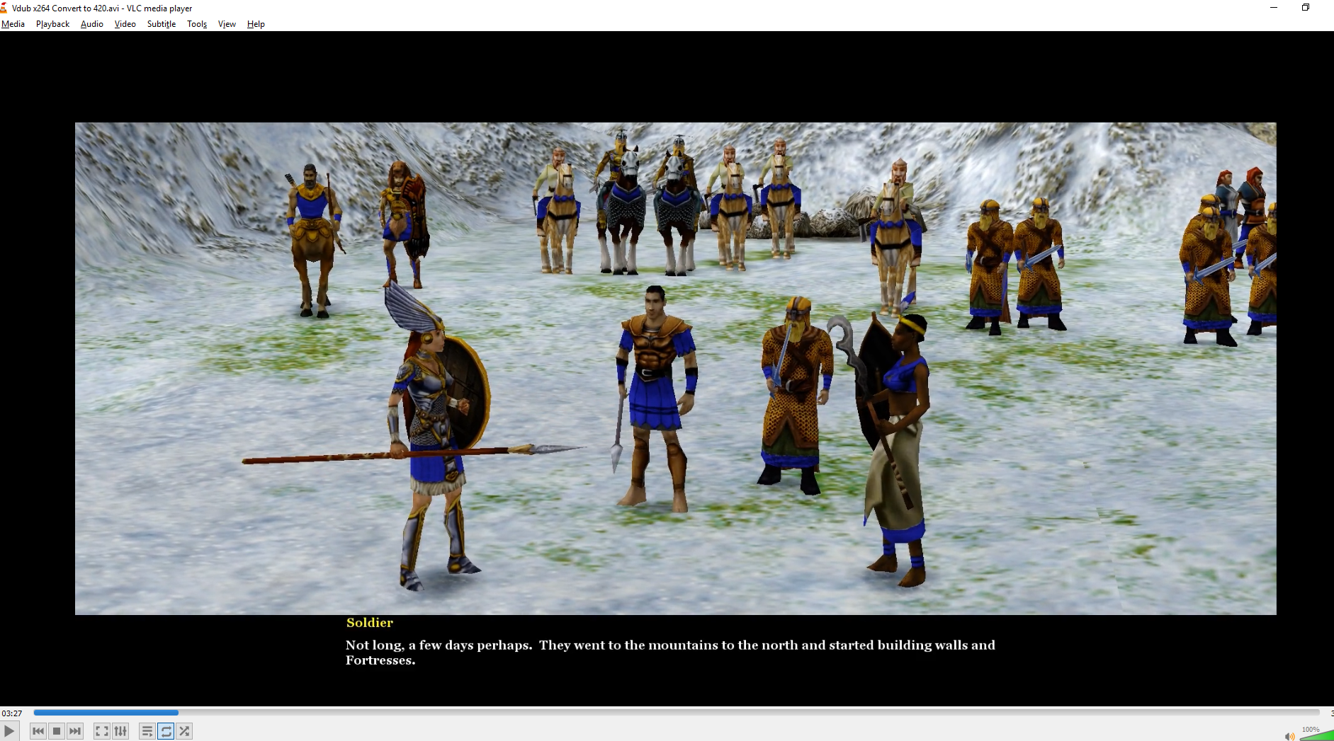

    Another issue is that with the same settings, vegas for some reason will brighten the video will vdub will keep the colour the same (screenshots provided as vdub x264 420 screenshot and vegas x264 420 screenshot) . The comparison videos are the convert to 420 Aom Video and the x264 vegas 420 under the Aom video list i have below, you can see it in the cutscene at around 3:27 the black bar where the text is.

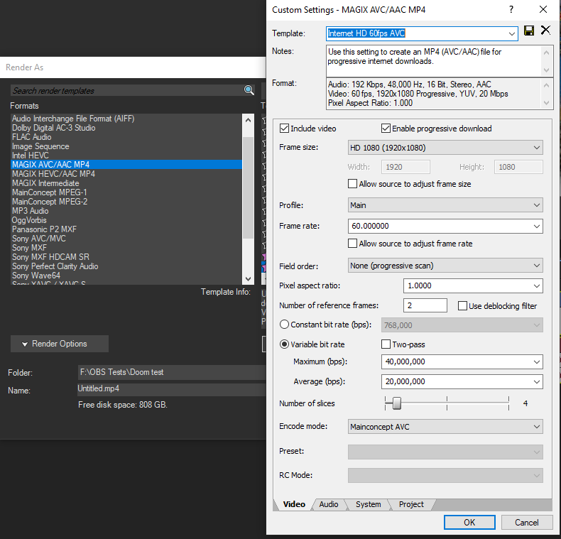

    I have posted screenshots with usually the settings i do use to convert. As well as the media info from the source files. I will also be posting links to all the videos uploaded to Youtube and would appreciate some insight/help. According to my friend one them (the AVC one specifically) seems dark to him but i found it seems to match closest to the source file went i alt tabbed between the media player and the file uploaded to youtube.

Name:	obs settings 2.png

Name:	AVC VBR 60fps.png

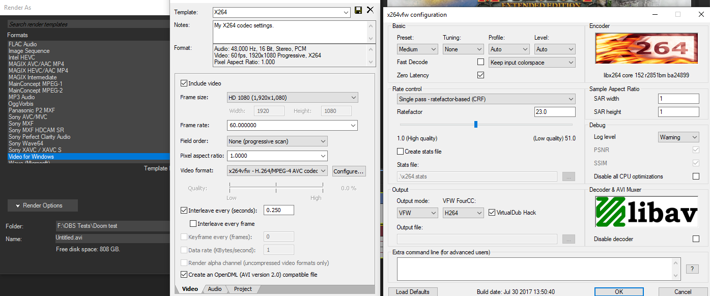

Name:	x264 convert to 420.png
Name:	vdub x264 420 screenshot.png
Name:	vegas x264 420 screenshot.png

Name:	x264 keep input color space.png

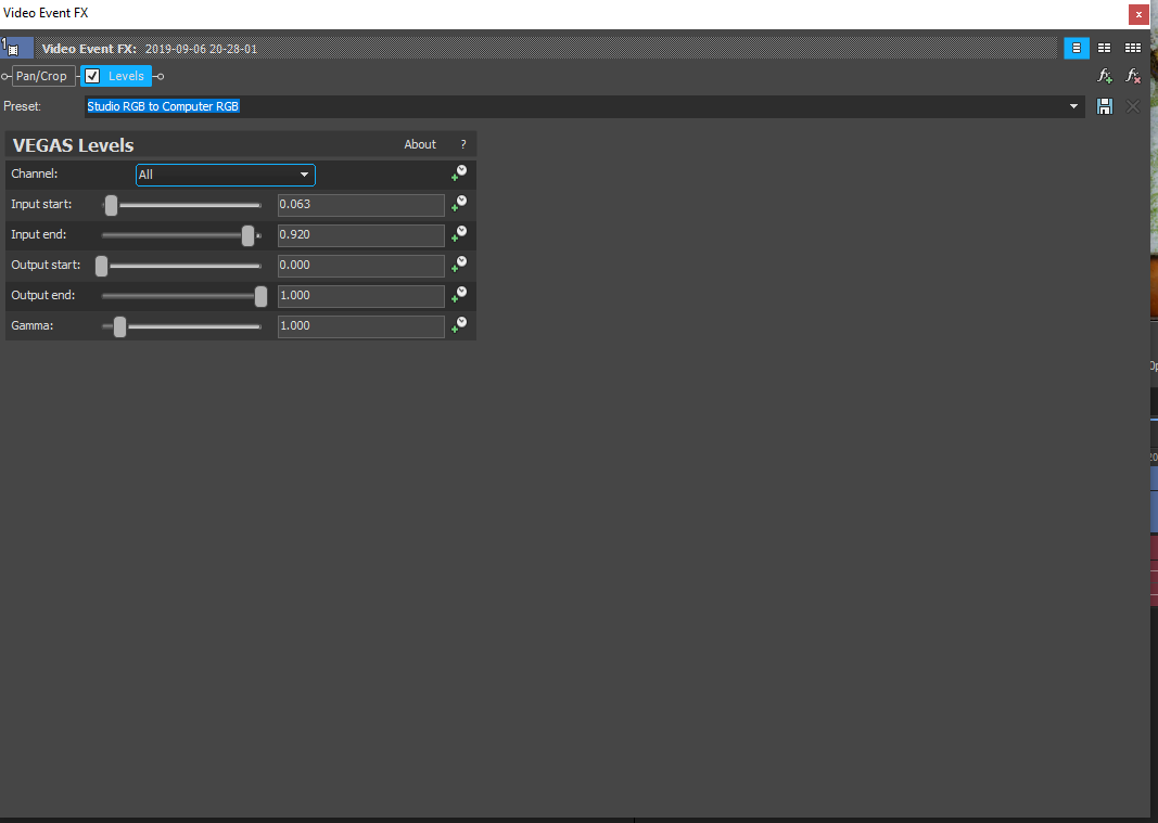

  5. regarding Vegas, some video formats are treated differently in Vegas, you might need to apply "Vegas Level effect", Preset, "StudioRGB to ComputerRGB" on your event
  6. For vegas x264 to match vdub x264 - you probably need to add levels filter before final render - the "studio RGB to computer RGB" filter preset

    EDIT: I found it, it definitely was under video FX window and levels. So i put on the studio RGB to computer RGB and it seems these are the levels according to this window. Would i change them all to 1.000?
Name:	vegas color levels.png

  9. Originally Posted by MajorFoley View Post
    Don't change; those values are already "preset" and the ones you need to "reverse" it.

    Holy crap it seems to have worked! That being said the size is definitely bigger. Comparing keep input sizes from 8.37gb source file it goes to 6.69gb without the colour levels and 7.16gb with the colour level applied. converting to 4:2:0 (which i think is what youtube wants anyway) with colour level applied is 2.58gb while without is 2.45gb. Now i just gotta do straight to x264 instead of NVENC and see how it better the quality is but i think this pretty much solves the issue either way even if i have to apply it with x264 as well. Thanks guys
