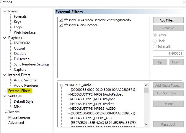

    I tried both "Folder" function from MakeMKV to copy full BluRay disc to my computer or DVDFab to copy full disc. So now I have a main directory with several sub directories (BDMV, STREAM, CERTIFICATE...).
    Then, I just try to open BDMV folder on MPC HC (with "Open BD/DVD") but it says either it "cannot render the file" or "cannot find DVD directory" (depending on what I open, "BDMV" or "STREAM"). I have MPC HC configured with ffdshow. I never encountered issues when directly storing BluRay on MKV files. I don't want to use anything excepted MPC HC. I know it is possible as I've already managed to do so in the past.

  4. Maybe I miss something : Am I supposed to configure something on MakeMKV or DVDFab ? As I said, right now, playing BDMV or just reading physical BluRay directly via MPC HC results in the same thing. It "cannot render the file". Am I doing something wrong ?
  5. Is there anybody to help me figure this out ? I also tried to instal VLC Player and did some trick to handle BluRay support (adding something on a "Roaming" folder and on VLC instal folder). Then opening main BDMV folder works. Nonetheless, though BluRay is opened, it won't play correctly (lagging...) but it is another story and that is mainly why I don't want to use VLC.
    Anyway, this test leads me to think that my BDMV backup is probably okay (obtained via MakeMKV or DVDFab). I guess there is something that doesn't work well on MPC HC itself (and/or its configuration). What can I do ? I don't understand what could be wrong : MPC HC is configured normally with ffdshow as preference (External Filters) and almost nothing as Internal Filters. See attached pictures. FFDSHOW is more or less the best decoding filter in my situation but I don't know, perhaps I should use something else ?

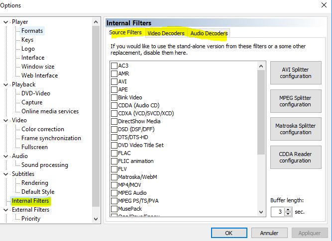

  6. Why do you want to use ffdshow? Is there any specific reason for this? LAV Filters are great and ffdshow is way outdated, but there are some special features in ffdshow which are good for some special cases, but normally you shouldn't need it.
    What version of MPC-HC do you use? Please update it to latest, but before please also turn on all internal filters and disable external ffdshow. Does that work?
    Can you please check MPC-BE 1.5.4 with only internal filters?

    I want to use ffdshow as I originally store my compressional BluRay into uncompressed MKV files (created with MakeMKV). I'm using MPC HC v 1.7.13 which I got lately and I guess it is latest version. I tried internal filters but it won't play correctly at all these MKV files (lagging, jump in audio or audio somehow stops sometimes...). I also tried madVR (something like that) but it didn't work well. At that time using ffdshow (audio, video) leads to great results excepted for VC-1 which are more or less played with some jump in audio (I have no solution for that).
    I got MPC-BE 1.5.4 as suggested. I didn't configure anything. I opened BDMV folder and indeed it plays now but...it is awful : audio jump and sometimes stops as explained above, lagging, image is somehow slow. Well it plays very bad. It is almost the same and even worse with an MKV uncompressed file I just tried to opened. Regarding this one, it is similar to what I encountered with internal MPC HC filters. Should I set ffdshow ? Notes : ffdshow doesn't seem to be reachable in External Filters.

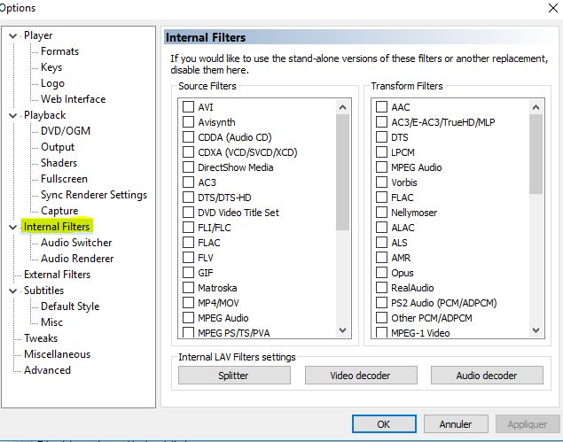

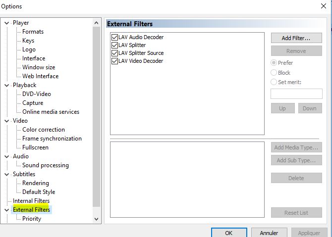

    I installed latest LAV and set every one as preferred while unticking anything in Internal Filters :
    [Attachment 51281 - Click to enlarge]
    [Attachment 51282 - Click to enlarge]
    Result : same : still lagging, audio jumping...

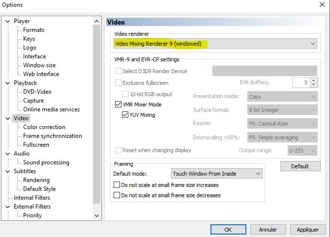

    I desperately had the idea to change something there instead of Enhance Video Renderer (custom presenter) :
    [Attachment 51283 - Click to enlarge]
    Now it seems to play well both audio video (for BDMV or MKV uncompressed file) but not any subtitle (pgs format) while it played subtiles with previous Enhance Video Renderer (custom presenter). Well it would be absolutely perfect with subtitles !

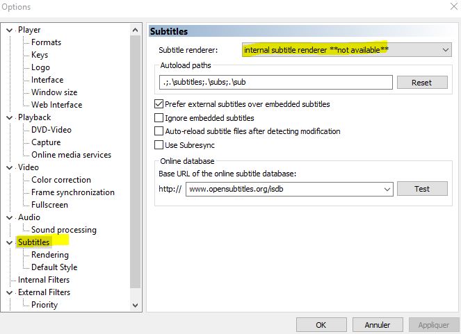

    Yes, it plays. I don't think there is a point in creating myself a sample as full BDMV or uncompressed MKV work now. Since I've set Video Mixing Renderer 9 (windowed) as shown in above capture, both audio and video seem to play perfectly. But subtitles are disabled. I don't understand why the hell it happens...
    As you can see with Video Mixing Renderer 9 (windowed) enabled, it is like that in Subtitles :
    [Attachment 51286 - Click to enlarge]
    So internal subtitle renderer is not available anymore. Then pgs subtitles are not taken in account and even worse I can't load anyone either (it is greyed out).
    What can I do to handle subitles there ? I want to handle either pgs, SRT ect.
    Notes : I also tried in MPC HC : since I enable Video Mixing Renderer 9 (with ffdshow instead of LAV Filters), it now works but same issue : subtitles are not recognized. So my issue seems due to that Video renderer more than ffdshow, LAV ect. But I loose subtitles handle which seems to be non logical to me...I just need to keep Video Mixing Renderer 9 and be able to handle subtitles.
  12. This is a known limitation of VMR-9.
    Download MPC Video Renderer, extract the folder to your desired location then run the install as admin and then select the Renderer in MPC-BE. Does this Renderer work for you?
