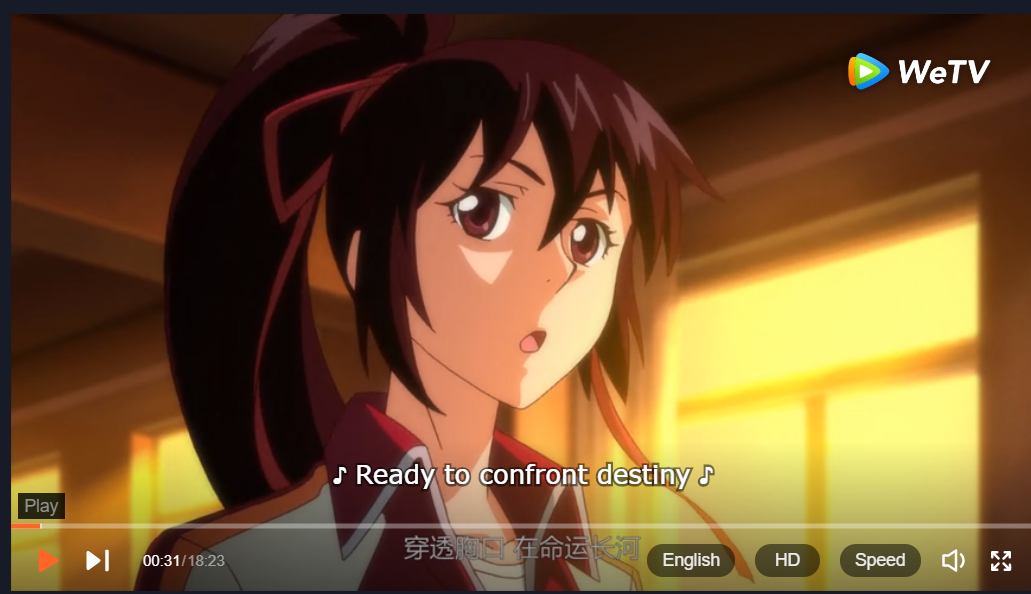

    Hello,
    Youtube-dl is not grabbing videos from wetv.
    HTML Code:
    https://wetv.vip/play?vid=g0032bnc6xu&language=en
    Any solution? I'm unable to download from that site.
  2. unable to play video.
    this site require access to play? if yes please post here your login data
    [Attachment 51262 - Click to enlarge]
    It does not require vip to play. I'm playing it without any sign in.
    If not try any random series from the site.

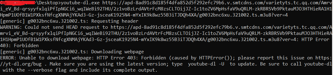

  15. VPN India and:
    youtube-dl https://apd-8ad91c8d185f4dfa852d5f292efc79b6.v.smtcdns.com/varietyts.tc.qq.com/Amrvi_eV_Bd-qrsyyfxlqiPfIpNGCi6_wqIWeBi92THU/2z1voBzLrdAVtrFcM8zsCLTOijJZ-Ic1toZV6MpHsfaV9uQRLM-zkRBRSVb9PktauMJO3HTHieRA1H1HpmP1UOfB1W1PXksfNfcgXNMAjYKAd3-Gz-jsceaK1925N4-mYxIK9k8wz55B3iTJDQh4XA/g0032bnc6xu.321002.ts.m3u8?ver=4
    The URL was found with FireFox's Developer Tools (F12), Network tab.

    VPN India and:
    Still unable to grab it. Using the latest version.
    [Attachment 51296 - Click to enlarge]

    I dropped the link on IDM. It said 403 Forbidden.

    you need get new link m3u8 and try with youtube-dl (so need ffmpeg installed and work fine for me)

  21. ytube is forbidden when the video cannot be played. and therefore not downloaded.
    use VPN India.
    then use IDM to download
  22. Originally Posted by Rex View Post
    oh yeeeess! tanxs jagabo
    VPN india work fine!
    and very simple without youtube-dl, IDM work fine!
    You need to get a fresh m3u8 link. It changes periodically to prevent what's going on here.
