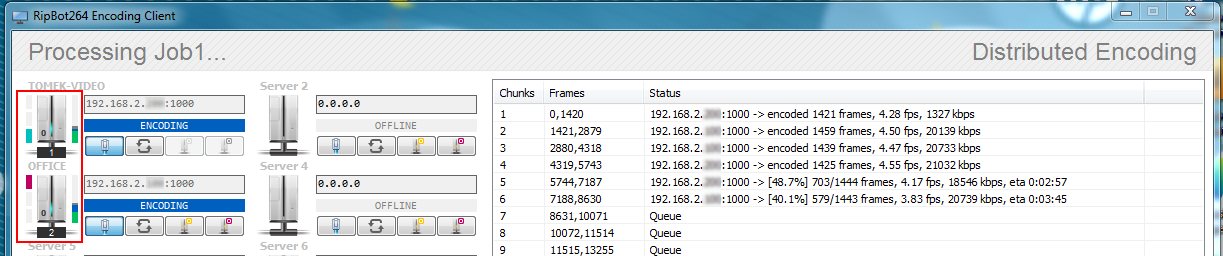

    I noticed a few changes in the client but have no idea what they mean can you please clarify? The grey server icons have a "0" marking and there's also a black box with number fluctuating between 1, 2 and 3. See screenshot.
    [Attachment 51243 - Click to enlarge]

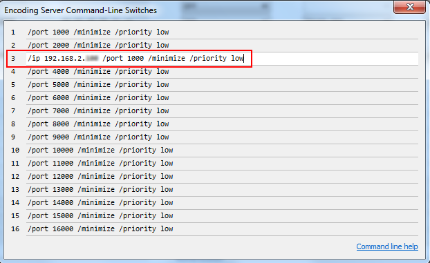

    Also in that screen shot I'm assuming the color bar to the left of the server icon is the priority setting which shows that server 1 is running on low priority (cyan bar) while server 3 is running on high priority (rouge bar). Is this correct? I figured that I could set the priority of server 3 (slave machine) to be also on low but when I make the settings via command line switches on my master (see screenshot below) it has no effect and the bar on server 3 remains as rouge.
    [Attachment 51244 - Click to enlarge]
    I'm probably not understanding something and couldn't find any documentation regarding this so would appreciate if you could explain.

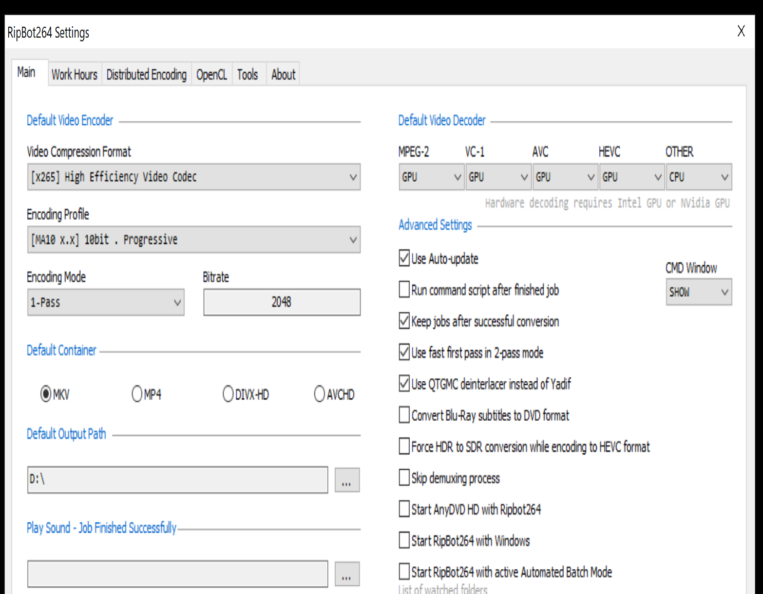

  9. Gpu don't work?
    when you sett, not cpu , but gpu, why not working?
    [Attachment 57256 - Click to enlarge]
