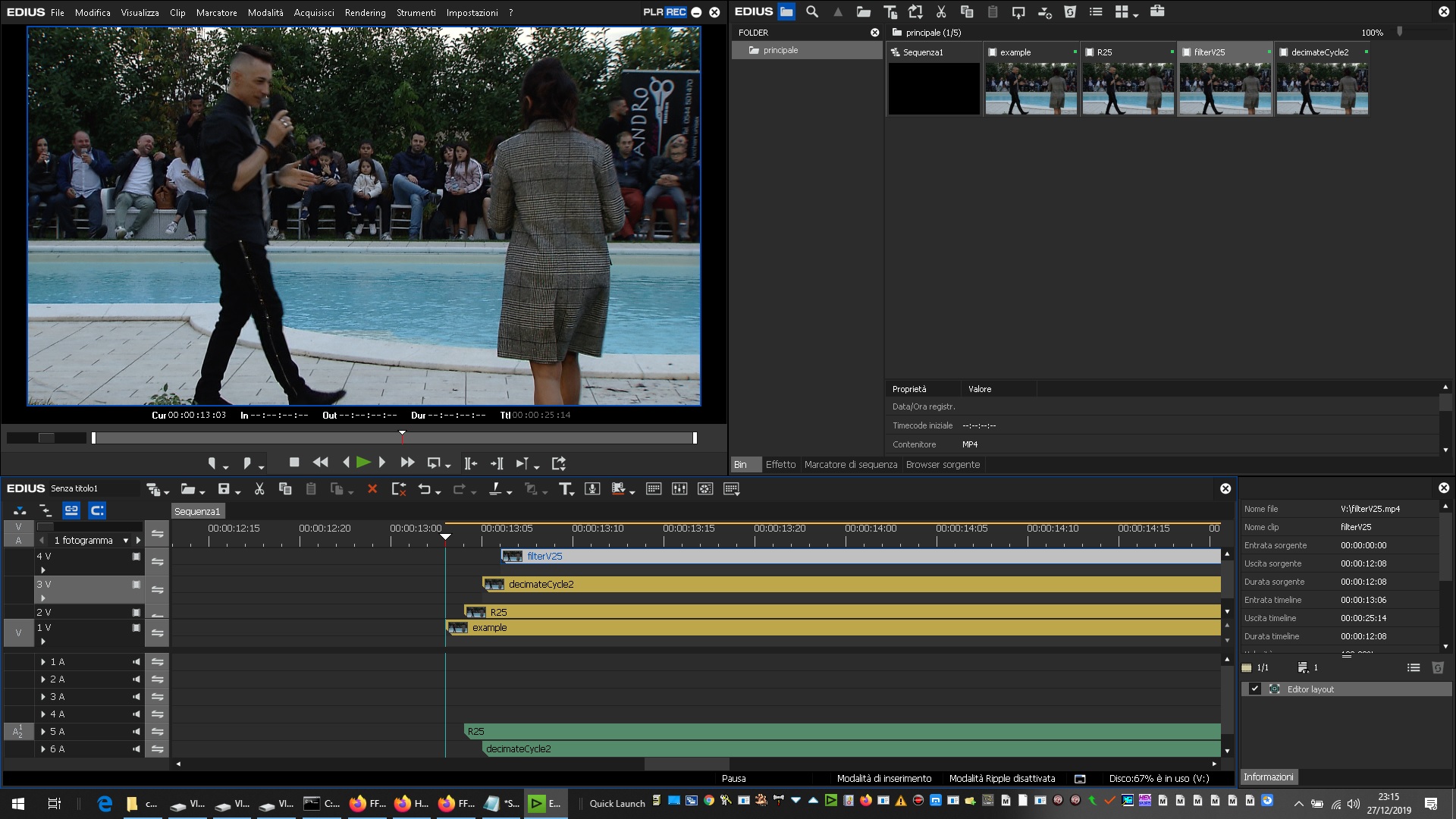

    [Attachment 51224 - Click to enlarge]
    and SEEMS that
    R25.mp4 is the "best" but is not in sync frame by frame (seems shifted of 1 frame backwards) but also maybe oversharp if compared with the original clip
    Decimate
    decimateCycle2.mp4 is "good" but seems a little jerky during playback (and not oversharp), but in sync frame by frame with the original clip
    filterV25.mp4 is very smooth playback and is in sync frame by frame with the original clip but seems to have details slightly "corrupted", detail seems not smooth

  14. Originally Posted by marcorocchini View Post
    This is 50p . The fps didn't work. I think it has to be in the same filter graph as the other filters
    (That would explain the "very smooth" playback and detail problems - crf encoding will raise quantizer based on framerate)
    Decimate
    Its the same issue as in the demo above - 2 extra frames, and wrong selection at the beginning
    -r should "just work" in theory. But 2 samples, 2 buggy results so far....
    I think you are oversharpening it with your "unsharp" filter on all of them . Very bad on dress pattern - aliasing
