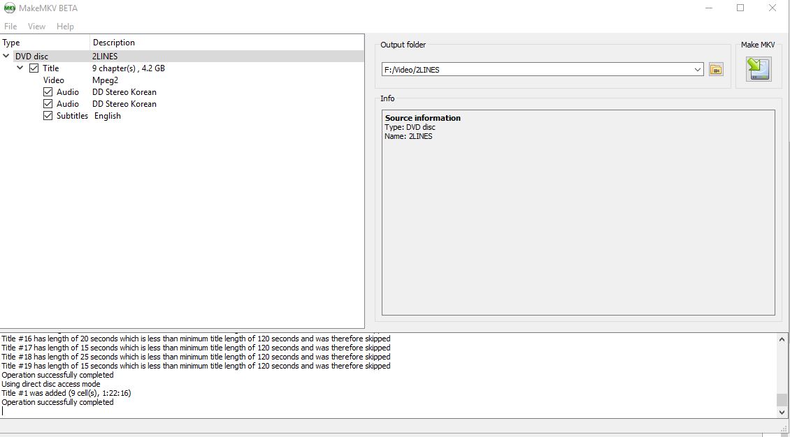

    Don't understand why you say MakeMKV doesn't show subtitles are there:
    [Attachment 51210 - Click to enlarge]
    I've run thousands of discs through MakeMKV and never missed seeing a subtitle unless it's hardcoded. DVD subs are extracted as .sub and .idx, and Blu-Ray subs as .pgs
    DVD and Blu-Ray subs aren't text, but images and need to be OCRed to convert to text, .srt is best if you want plain text. With any program that does OCR, you'll still have to babysit and correct questionable characters and probably scan the finished subs for errors, common problems being l, I, O, Q being converted as 1 or O.
