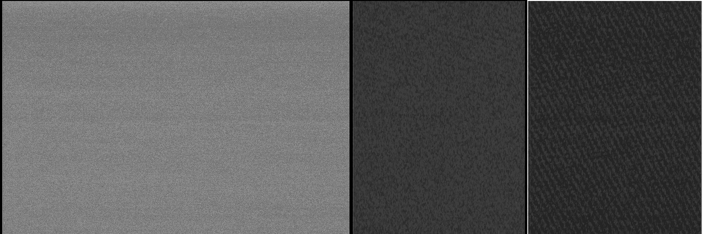

Hey clashradio! Ok so without the eval board, I'm getting this diagonal pattern noticeable on solid colors, like the blue screen of camcorders and vhs players. It was thanks to Vaporeon, I noticed it. A lot of that can usually be attributed to bad cables or bad capacitors in the device. The latter would suuck! I'm returning the camcorder, since it's within the 30 day and I don't wanna take the chance dealing with a bad unit. I might have to get another, or get a refurbished one serviced by a good technician.

So I got this new monoprice cable and I recorded a short clip of the blue screen.I couldn't find that diagonal pattern noise like I saw before. I saw wavy lines, but that appears to be typical analog noise. No rolling lines either. Idk, it looks ok? I need to figure out that script that was posted earlier. Btw, this is a direct capture to my capture card, no eval board yet. That thing's still on fritz. -

Diagonal lines / noise.
Went through multiple iterations of configs to arrive at this - the tuning here may change depending on what level of oversampling you've selected for your source. I use 8x oversampling for S-VIDEO input.Code:4C 05 0F ; Enable Anti-Alias Filters on all ADCs ***

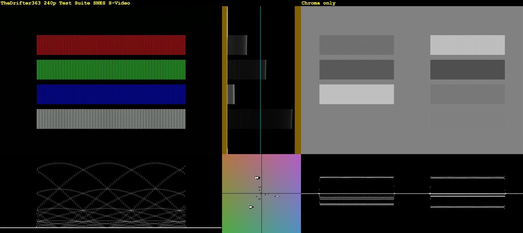

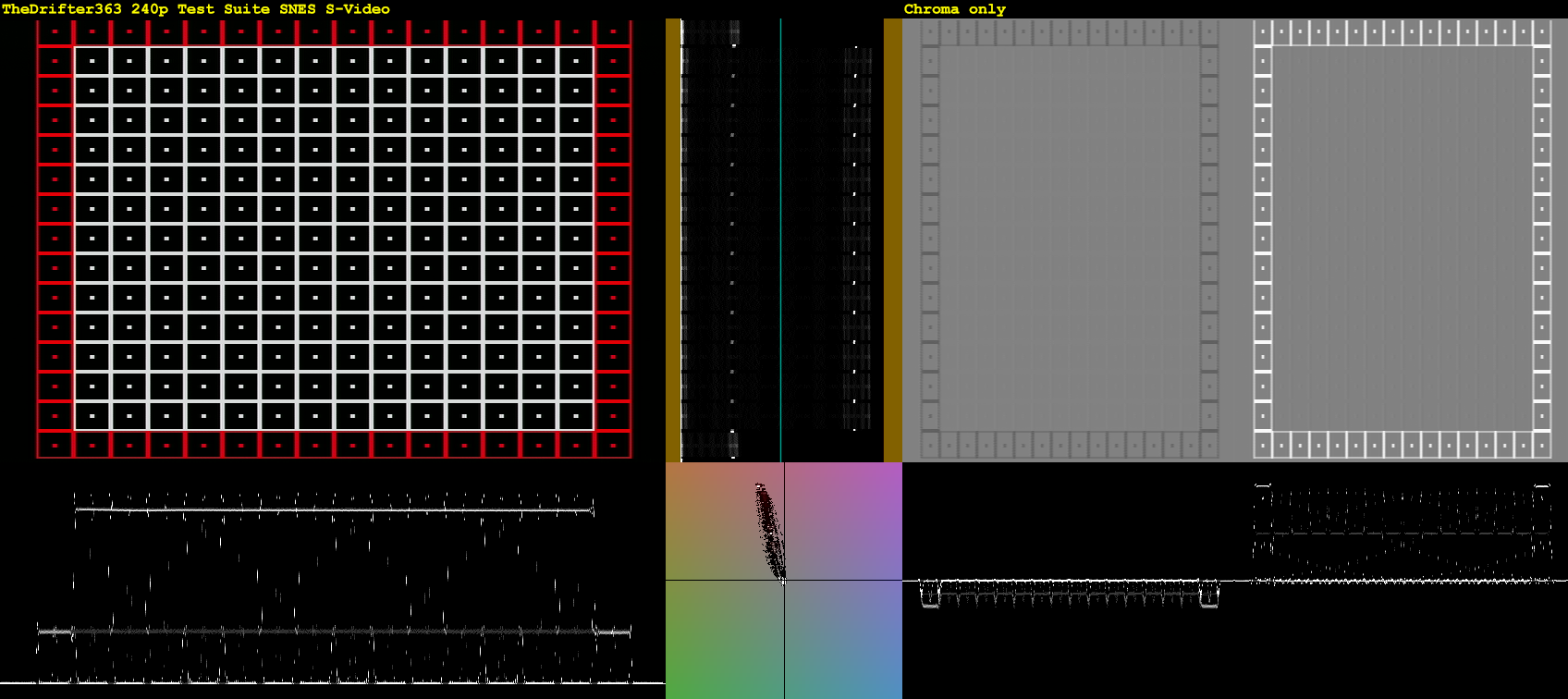

Full-screen red & especially full-screen green show chroma noise, also visible in the screenshot below.
Weird effects going on with these two patterns, though I don't have anything to compare them to. Why is there chroma around the grey parts of the grid?

The post #39 direct-to-Magewell camcorder Blue Back capture: luma looks good. Chroma looks about the same as the frame I showed in post #30. It's possible the "V" channel diagonal noise is caused by something other than the camcorder. A 240p Test Suite direct-to-Magewell capture may be useful for comparison.

So yeah 240p test suite was direct to magewell, no eval board in the way.
Now I wouldn't be surprised about those SNES s-video cables. They're not particularly high quality. Think I got them on ebay. They're about 6 feet. I'd have to scour the retro game forums for some high quality cables, but I use RGB for my old consoles, so I haven't really bothered.

Hmm so even my SNES shows chroma noise. Maybe it's not a camcorder issue then. Something is causing chroma to bleed into places where it shouldn't. Capture card? That would suuuck! Though I do plan to use EVAL board for my final captures anyway. And vaporeon, I don't think you noticed chroma noise when connected to the eval board. Just luma rolling noise I think?
