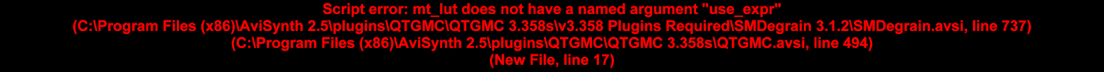

    I'm wondering if it's QTGMC needs an update, but I cant get the new QTGMC to work. I keep getting a stupid error that says mt_lut does not have a named argument "use_expr". I even tried updating my masktools2 to the newest version since supposedly that's the plugin tied this error, and the masktools2 plugin will not load no matter what. Manual loading of it is also failing. The plugin just refuses to load. masktools2-v2.2.18
    This is literally all I ever get no matter how I try to load the plugin. I even tried an older 2.2.17 version and it too wont load.
    [Attachment 51225 - Click to enlarge]
    EDIT: I still cant figure it out and it will not load or work. They really need to start bundling required plugins with releases.

  15. I don't think the QTGMC (or any other plugin) version is the difference between your filtering and mine. But your video is only 640x480. Did your script resize before QTGMC? That would be the likely source of the problem.
  16. Nope it's not the resizer causing it. I tried it without resizing at all as well, and the issue still persists. I even tried using TFM with clip2 as QTGMC, and its not as bad, but its still happening and it didnt clean as well as yours did. I am very stumped as to why yours is so smooth compared to mine no matter what I try.
  17. Go through your script line by line until you see what's going wrong.
    I missed post #15 about MaskTools2. Are you running 32 bit or 64 bit AviSynth? This is the version I'm using (both 32 bit and 64 bit AviSynth+):
    https://github.com/pinterf/masktools/releases/download/2.2.18/masktools2-v2.2.18.7z
    The 64 bit QTGMC.AVSI I'm using is version 3.358. 32 bit is v. 3.32.
  18. I've taken everything but the QTGMC out and its still doing it. I've tried altering several things and rearranging them in different orders and its still doing it. Its not causing it to become more jittery than the source when it's just QTGMC, but your sample is certainly less jittery and more smooth than the source, or this encode I am getting. Possibly because yours is 23.976fps and mine is 29.970fps.
    I'm only seeing this increased amount of jittering when I make the video 23.976fps. It doesn't matter if I use srestore or tdecimate to get it to that, it makes it very jittery. It seems to have made yours better than the source. So It's either the srestore I have, or QTGMC is my guess. I doubt it has anything to do with codec settings
    I do not have 64-bit avisynth and could never get it to work, so I'm stuck with 32-bit. The updated QTGMC I am trying to get to work is v3.358. v3.32 is the one I have been currently using for a long time. Are you saying the 3.358 will not work at all in 32-bit? I have 32bit versions for all the required plugins to my knowledge.
    That's the same masktools I am trying to use, but for whatever reason it refuses to be loaded. I even tried manually using loadplugin and import and it does not want to load in anything that uses avisynth on my computer. AvsPod, MegGui, VirtualDubMod, it will not load in any of these and I only get that jumbled text error. I am going to guess for now that it wont load because I have something running through the encoder and it might be using the older masktools. I may have to take the mt_masktools-26 out of my autoload folder to get the new one to work when loaded in manually. I cannot verify this for at least 9 hours until it finishes.

  21. What version of srestore are you using?
    I tried updating to the newest srestore but this is all I get for an error when I try to use it.
    It looks almost identical to the error I was getting when I was trying to use the newest QTGMC that you have. The only difference is now its mt_lutxy instead of mt_lut.
  22. Originally Posted by killerteengohan View Post
    I was not aware you could install 2 different versions of avisynth at the same time and not have them conflict or break each other.
    You can't have 2 of x86 or 2 of x64 versions at the same time . You can have one of x86 and one of x64 simultaneously
    You have some version conflicts. You're using avisynth 2.6 classic, and your script is calling for the newer function in the newer version of masktools . You'd have to use older matching versions of everything, or newer matching versions of everything

    I tried updating everything it said it required. Most of the updated plugins wont even load in and give an error.
    these ones absolutely refuse to load.
    LoadPlugin("C:\Program Files (x86)\AviSynth 2.5\plugins\QTGMC\QTGMC 3.358s\v3.358 Plugins Required\dfttest-v1.9.4.3\x86\dfttest.dll")
    LoadPlugin("C:\Program Files (x86)\AviSynth 2.5\plugins\QTGMC\QTGMC 3.358s\v3.358 Plugins Required\masktools2-v2.2.18\x86\masktools2.dll")
    LoadPlugin("C:\Program Files (x86)\AviSynth 2.5\plugins\QTGMC\QTGMC 3.358s\v3.358 Plugins Required\mvtools-2.7.41-with-depans\x86\mvtools2.dll")
    LoadPlugin("C:\Program Files (x86)\AviSynth 2.5\plugins\QTGMC\QTGMC 3.358s\v3.358 Plugins Required\mvtools-2.7.41-with-depans\x86\DePanEstimate.dll")
    LoadPlugin("C:\Program Files (x86)\AviSynth 2.5\plugins\QTGMC\QTGMC 3.358s\v3.358 Plugins Required\mvtools-2.7.41-with-depans\x86\DePan.dll")
    LoadPlugin("C:\Program Files (x86)\AviSynth 2.5\plugins\QTGMC\QTGMC 3.358s\v3.358 Plugins Required\RgTools-0.98\x86\RgTools.dll")
    I managed to load these plugins below by removing the ones that would not work or load when called in the script, and now I am seeing this error.
    [Attachment 51235 - Click to enlarge]
    Is this not the fault of dither plugin? I am loading it in and its the newest one to my knowledge as can be seen below.

  24. You probably need newer version of smdegrain for that Dither_Luma_Rebuild error . Newer versions of QTGMC require newer versions of smdegrain for some dependencies
    It might be some megui thing where it has some portable avs version that already loads some versions. But newer .dll versions like that masktools should still load in older avs versions. It might be some already loaded issue, or multiple plugins autoloading conflict issue. You should clean out the plugins folder too
    Do you have an actual system avisynth x86 version installed ? You can try test script in vdub2 x86
  25. Yeah I tried the newer smdegrain before as well, and it loaded but changed the error into a different error. Which is I believe tied to masktools? But that wont load. So I took it out.
    Import("C:\Program Files (x86)\AviSynth 2.5\plugins\QTGMC\QTGMC 3.358s\v3.358 Plugins Required\SMDegrain 3.1.2\SMDegrain.avsi")
    autoload? isn't autoload overridden by manual loading? I thought if you do a manual load, it will use the manually loaded version you specified instead of the one in the autoload folder. At least thats how it seems to have been working for me when it comes to other plugins. Its trying to use the new QTGMC instead of the one in my autoload folder when I use loadplugin/import for the newer QTGMC.
    Yes I have x86 avisynth installed. I never installed the x64 because it would never work for me years ago when I tried it. A lot of plugins I prefer to use are for the x86 version anyways, and I do not use multithreading, so I never bothered with x64 after that.
  26. Originally Posted by killerteengohan View Post
    How do you know what version is working or loaded?
    I'm not sure about the "priority" . If you have a .dll in the autoload directory, what happens when you load the same plugin, just different version? What if you have 2 LoadPlugin ? Does it take the 1st or 2nd or the autoload ?
    For me, I keep it clean and don't encounter these problems. Nor do I ever want to predispose myself to those problems. I like to follow the KISS rule. And many avisynth problems can be traced back to a cluttered autoload directory
    I don't think that's related to this bunch of problems here, but everything with avs+ x64 is working well now. Much more stable and faster than the old x64 avisynth and avs+ MT works better than the old MT
    You have mismatched versions causing these errors, I'm certain of it.
  27. Originally Posted by poisondeathray View Post
    Well if I take out loadplugin/import qtgmc, its uses the old one in my autoload folder and no errors come up. If I put in loadplugin/import of something that's a different version of whats in my autoload folder such as srestore, it loads and uses the one I told it to import/load and ignores the one in the autoload folder. I know this because the new one wont work (it gives an error) and if I remove the import of the newer version, it loads and uses the one in my autoload folder just fine so its trying to use the new one I manually imported.
    That's where I get the assumption on what version is working and loaded. I figure anything I manually load in the script is what gets priority and what gets loaded based off of that. I also assume the order you load them in is they order they get priority, just like the order you use filters in.
    I don't think my autoload folder is too cluttered and I haven't had any problems with updating things before or loading other versions of things from other folders manually like I am trying to do here. This QTGMC however, is being a real pain lol.
    I have something encoding and it wont be done for about 5 hours, but when that's done I can try an all new autoload folder out, made from scratch and put in only whats needed for QTGMC to see if it will work. Then I will be able to tell you if was indeed conflict in that folder.
    I don't think that's related to this bunch of problems here, but everything with avs+ x64 is working well now. Much more stable and faster than the old x64 avisynth and avs+ MT works better than the old MT.
    If I uninstall my x86 avisynth version and install only x64 version, can I still use all my 32-bit plugins I want to keep or will that require 32-bit avisynth? It would be nice if I could use both x64 and x32 plugins in a single avisynth script.
    Ideally I would be very happy if I could have an all x86 autoload plugins folder and an all x64 autoload plugins folder, then be able to pick and choose from both when calling them in avisynth script. I might want 32bit only filter for something and 64-bit updated for something else and want to use them in one single avisynth script. I was always under the impression that you can only have one or the other installed though.

    I've had no problems with it.
    Im confused as to which I should get.
    http://avs-plus.net/ has r1576 version (Seems much older)
    https://forum.doom9.org/showthread.php?t=168856 has MT-r2772 version (Is yours MT?)
    https://github.com/AviSynth/AviSynthPlus/releases has 3.4.0_20191020 version (completely different version numbering system than the others and possibly worked on by different person?)
    Which is the official newest and which would I want?
