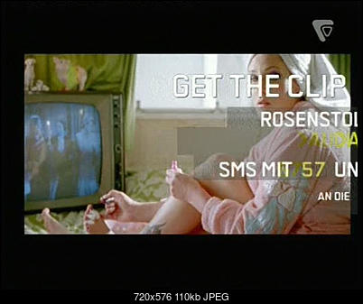

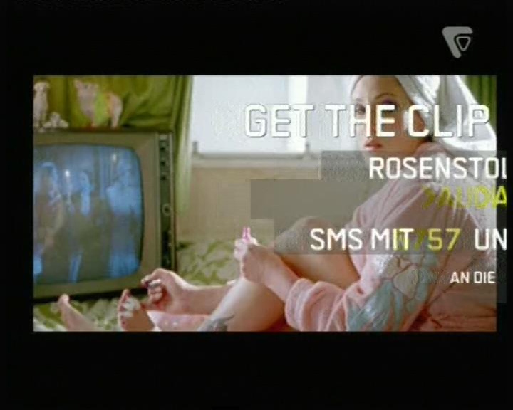

    when I'm using QTGMC, it's denoising and I don't want it.
    See picture below.
    Deinterlaced in 25p with other programm
Name:	Deinterlace Premiere.jpg
    Deinterlaced in QTGMC
    You see the "ghosting" letters...
    (For the example I took Frame 10)
    How can I disalbe the Denoising process.
    Thank you
