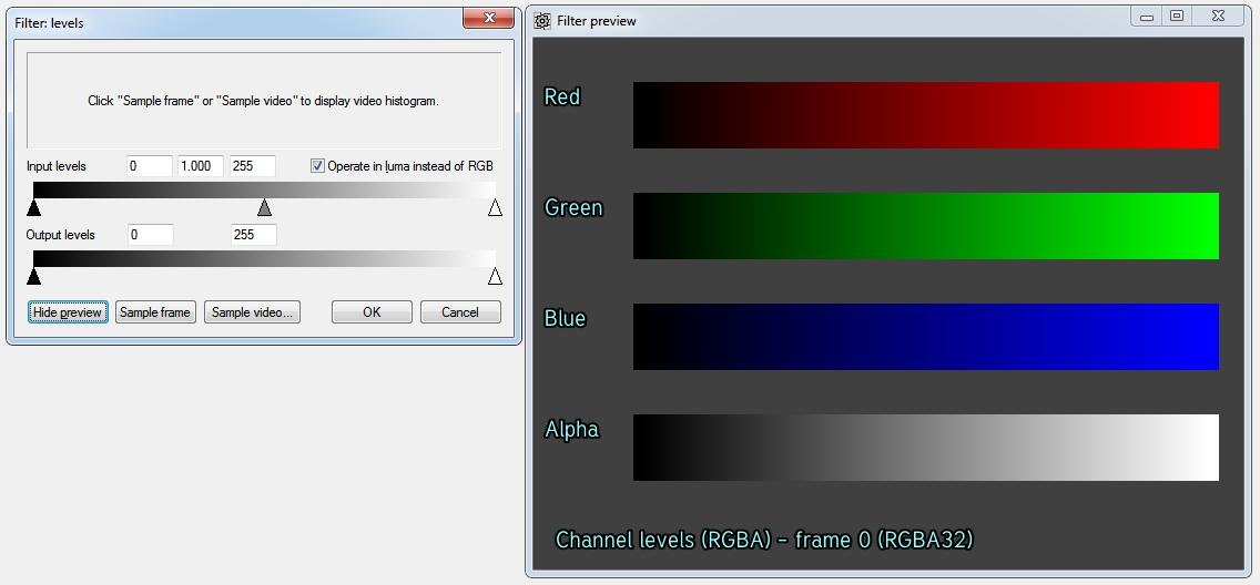

  6. If you want something with an interactive preview try VirtualDub2 and its Levels filter. You can adjust the black level, white level, and gamma all in one filter with real time feedback.
    [Attachment 51181 - Click to enlarge]
    The adjustment works as well as AviDemux. However, unless I'm doing something wrong, VirtualDub won't let me save the modified video as MP4. It will save as avi but my original MP4 video is 2521KB, the avi output is 514,701 KB. Not exactly a good choice for the web.

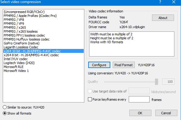

    I've used the following panel:
    [Attachment 51183 - Click to enlarge]
    I chose both selections that said MP4.

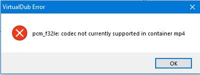

    In both instances I get the following error:
    [Attachment 51185 - Click to enlarge]
    Am I doing something wrong?
  10. You need to select an audio codec too.
    Feb 2006
    Canada
    There is no audio in the input video file. Audio/Compression was grayed out so I selected Audio/No Audio and that worked.
    Thank you for your help. It looks like this will be a bit easier. I'll continue to play with it to see if I can get good results.
