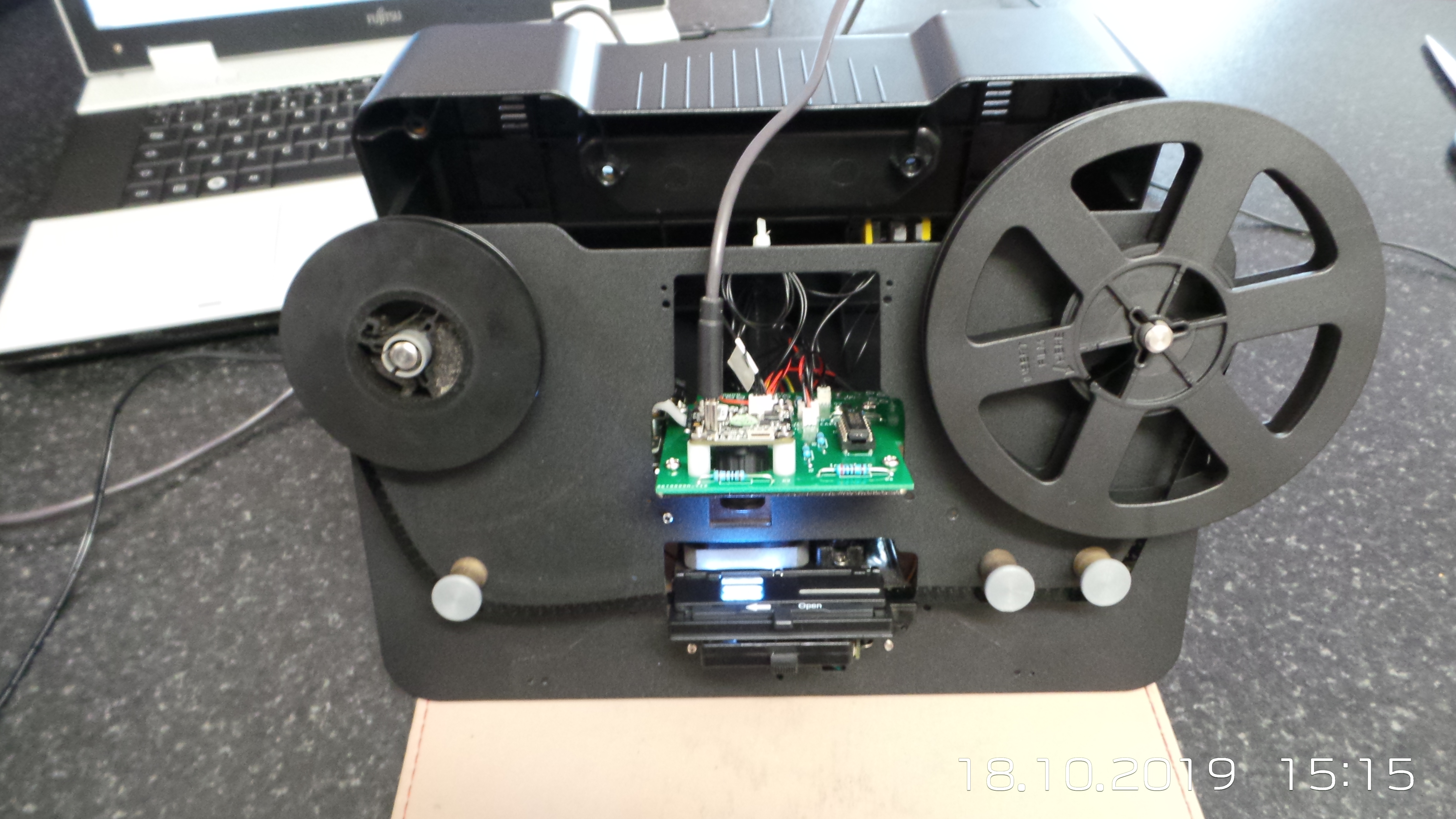

  14. As it happens the Wolverine scanner has now been modded by a chap called Stan, in Florida.
    It is not commercially available but there are around 10 or 15 in existence at this point.
    I have recently modded my wolverine 720 scanner with the new board and camera.
    The mod cost me around £200, the new camera and lens was £160
    It takes jpg or png or tiff images and I use VirtualDub to compile the video.
    That means I can create uncompressed video for later editing, or go straight to h264 mp4 video
    It is also being given the option of a sprocket to pull the film through for broken sprocket holes, altho I don't have that option.
    It's a massive leap forward. Capturing stills from cine is much better than the mp4 the wolverine spits out.
    Still some snags to sort out with exposure during capture, but my results are beginning to look good.
    The camera is an Imaging Source unit (and lens)
    https://www.theimagingsource.com/products/board-cameras/usb-2.0-color/dfm72buc02ml/
    And IC Capture software for the capturing of the stills at one frame per second in jpg or one frame per 2 seconds for tiff.
    I use an Acer Revo computer for stills capture, to memory card.
    I have been using the 720p Wolverine for around 3 years now.
    For frame rate change without re encoding for regular wolverine users, get a copy of My MP4Box GUI from the tools section in this website:
    open mymp4 and choose the demux tab
    add a video
    click demux
    this will generate an H264 video in the same folder as the source.
    choose the MUX tab and add the h264 video
    in the bottom window for fps, select your desired fps. Hit the Mux button.
    18 fps isn't there, so you can go to the view menu, choose 'edit command line' and when you hit the MUX button, a command line will open, insert any fps you like, where is says fps= click save and run. job done.
    This will adjust the frame rate without any re encoding.
    You can only demux one file at a time, but it will batch mux a pile of video at once.
    If you use the batch, ignore the warning about adding a file with only one stream.
    Cine scans done frame by frame on the Wolverine don't have an audio file.
    This software can also be used to join up broken scans, for example, when you have to stop the Wolverine for a broken sprocket, and end up with multiple video clips for the same reel of cine, again, with out re encoding.
    Here is a shot of the modded scanner, during the mod process, with the new camera in place, on a newly designed circuit board which replaces the original board. The USB lead from the board, is plugged in to the camera, and laptop. The opto coupler on the claw triggers the capture which is then saved to computer via USB
    [Attachment 51324 - Click to enlarge]

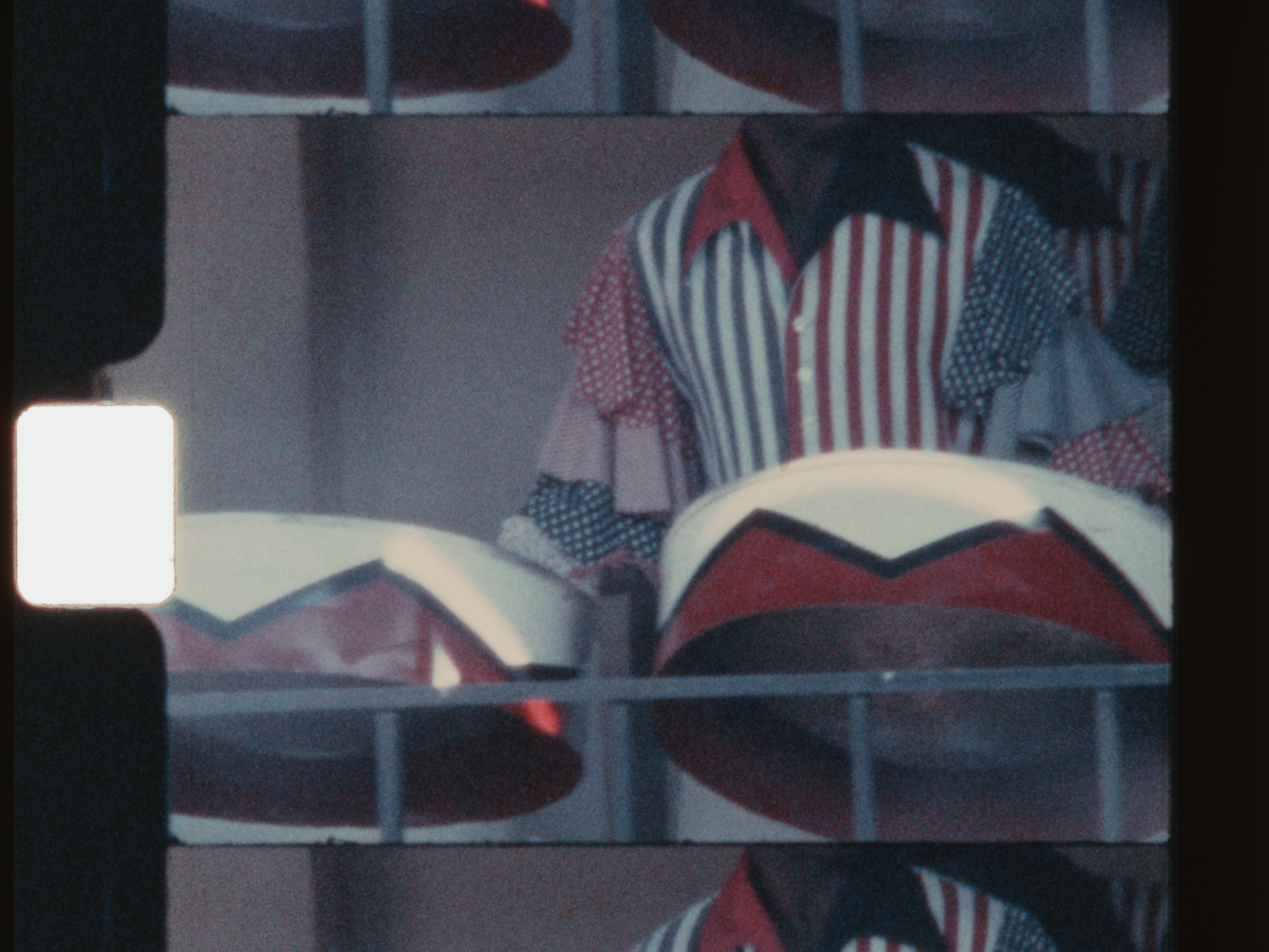

  22. I also looked into the Wolverine and similar. After a lot of reading and YouTube videos, I concluded that these old home movies that were very special to me and my family needed to be captured in the bets possible way, which is 2024 is a Lasergraphics scanner. There are a lot of home-based businesses that have one and offer this service. I recommend Reel Revival Film near Philadelphia, but I'm sure there are all equally good.
    I attached a screen grab from the raw Super8 video captured by the Lasergraphics scanner. Also attached is a screen grab from the VHS copy of a similar scene from another Super8 film that was recorded in the late 1990s with a professional telecine machine and saved to VHS tape. So the quality is better than most wall-projected telecine transfers. Even as respected as that transfer was, the Lasergraphics is clearer and you can get it some at 4K or higher, which is overkill in a sense, but the benefit is that the noise is smaller and easier for QTGMC or Neat to remove.
Name:	VHS tape version.jpg
