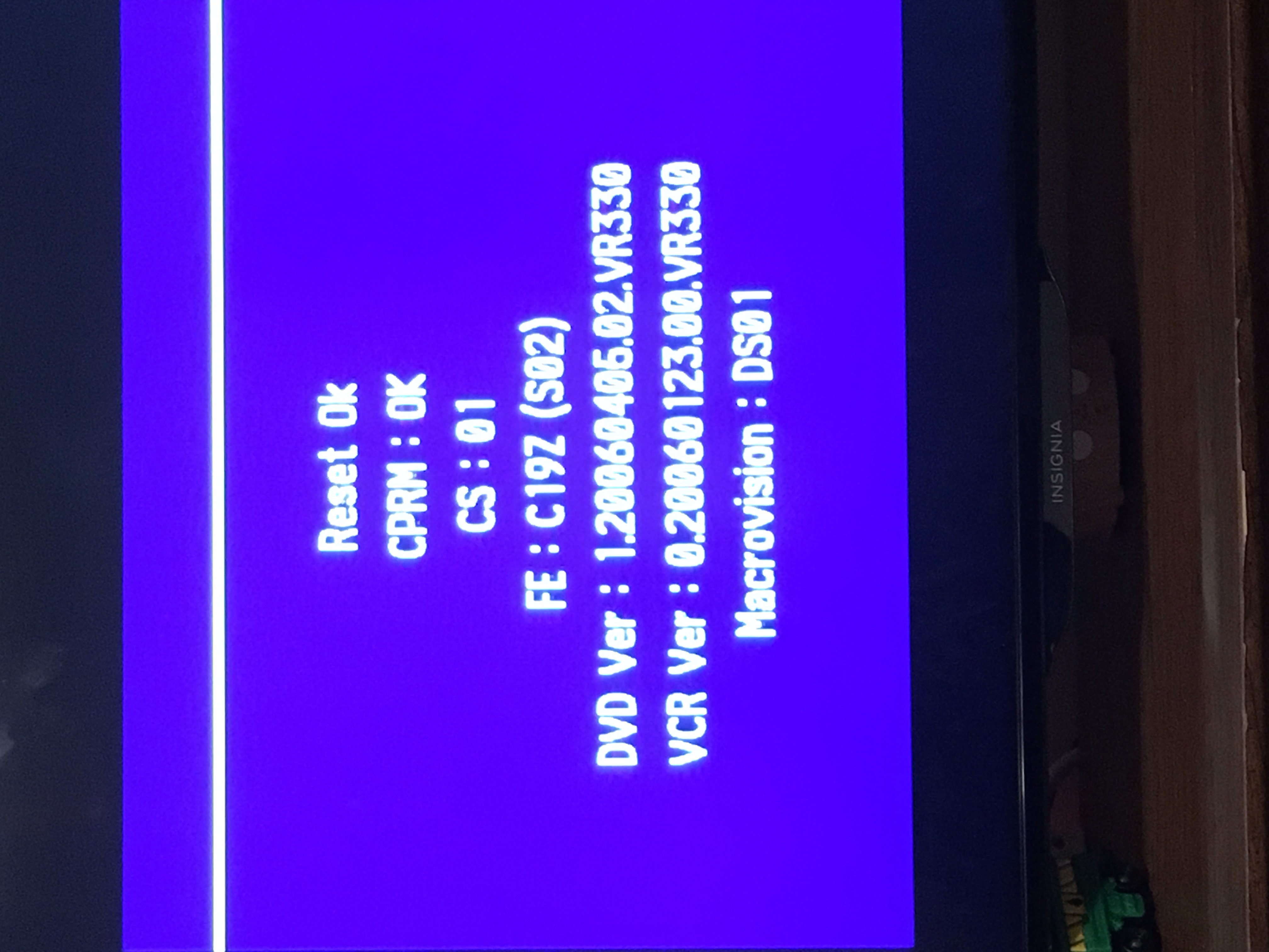

  6. I tried the factory reset per the owners manual (hold down both channel buttons, wait 5 seconds, press power button.)
    Here is what happens:
    The following screen comes up and the the disc tray opens after holding the channel buttons for five seconds.
    [Attachment 51096 - Click to enlarge]
    Then I hit the power button and nothing happens. Then I hit the power button again and it turns the system off. I have tried different variations such as holding the power button. None of this ends up allowing you to
    A) change region in menu screen per other thread on this site
    B) insert a blank disc and have it do anything besides say load for a while, followed by ejecting it and saying it could not play the disc.(tried with verbatim -r, and tdk +R.)
    C) load certain discs that are region 1
    I have three dvds that it will play. Two don’t list the region number or much else. One I just tried that works actually does show a region code of 1. That dvd also says “DVD 5” and “16 : 9 Screen Format” in two little rectangles.
    The dvds that won’t play are region 1, and say widescreen.
    I have used this machine to record a dvd from a vhs in the past. However, I don’t remember if I used a different brand or type of blank DVD. Thanks in advance for any more advice, as I am still stuck. I can supply more details or photos.
