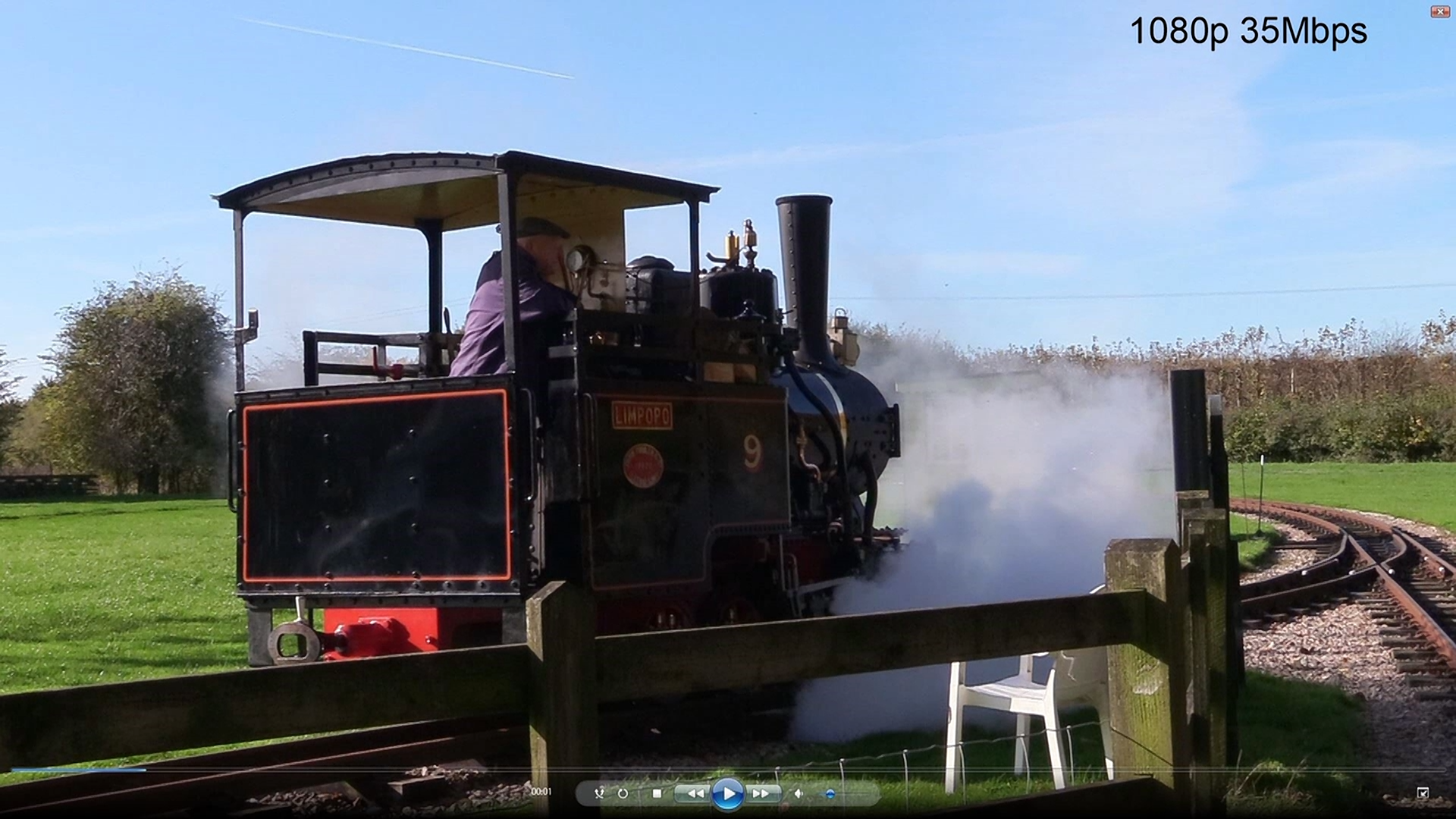

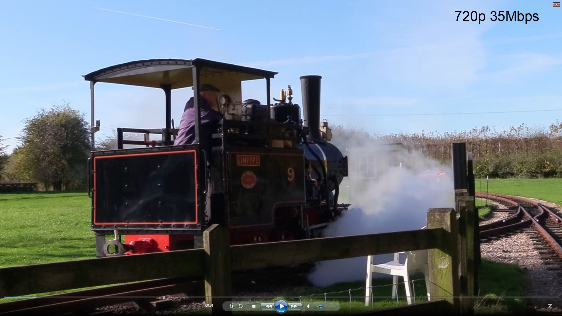

  8. These pics compare 1080 to 720. Both are at a bitrate of 35Mbps. If you switch between them you can see the loss of detail in the 720p version.

  9. I'd be willing to go out on a limb and say that's more blurring due to the downscaling and/or upscaling not being sharp than it is a loss of detail as such. Of course that is a factor. You are at the mercy of the player's/TV's upscaling in that respect. However.....
    The 1080p image downscaled to 720p then upscaled again in an Avisynth script (screenshot 1).

  10. The 720p was not downscaled using a video player, it was rendered at that resolution in DaVinci Resolve. The 1080p is from the camera original.

  11. Yeah, but if the 1080p source was used for the 720p encode, it must've been downscaled for encoding. That's what I meant when I referred to the downscaling, but I don't know anything about DaVinci Resolve. The blurriness could be purely due to the upscaling on playback. I don't know how WMP upscales.

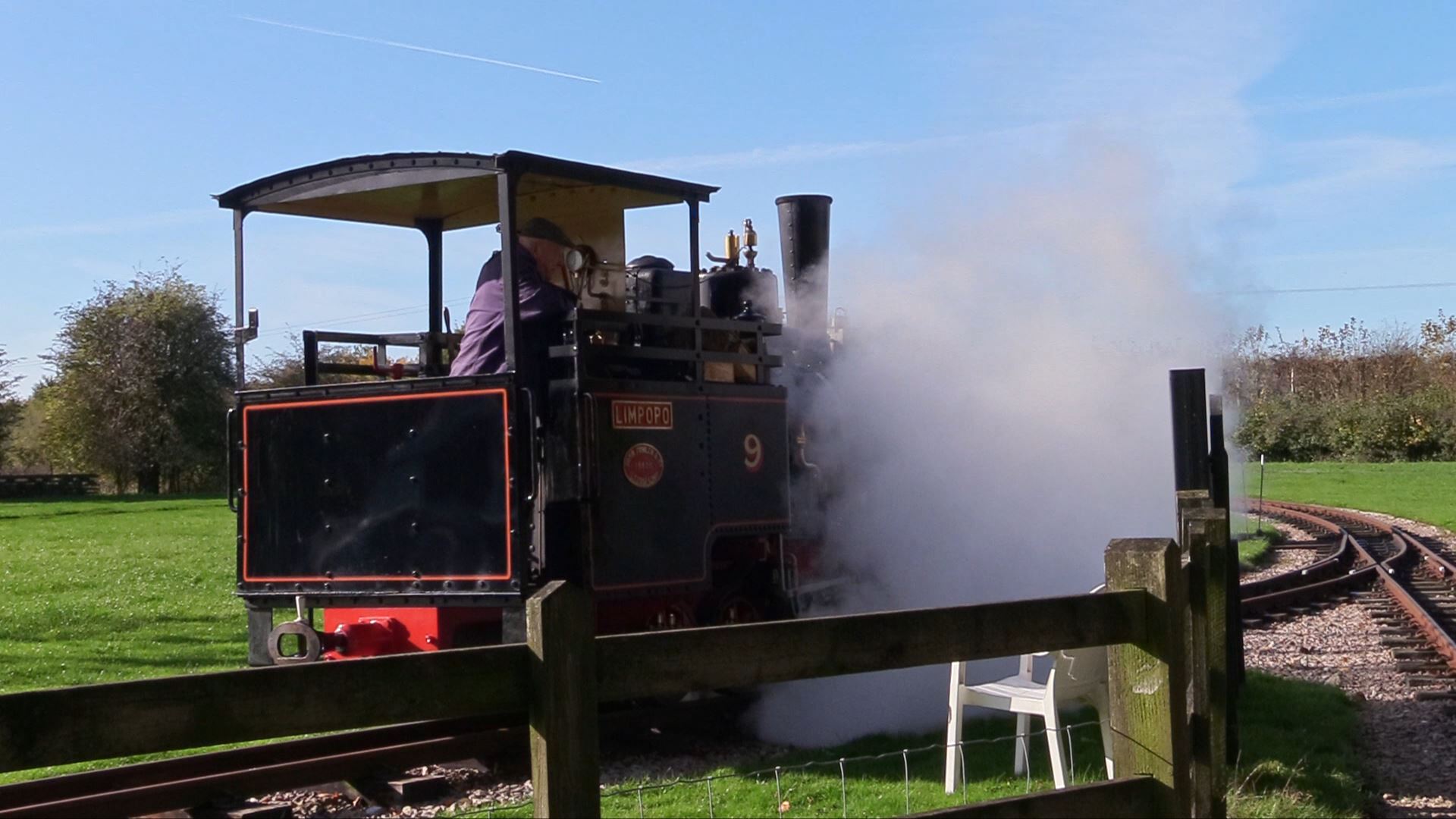

    For me it is hard to believe that your 2 pictures are even from the same original frame. See for example the steam. It is totally different for the 2 pics when switching back and forth, and this happens never due to a scaling effect.
    Also, are your 2 pictures of the same type, i.e. both are I,P or B pictures?
  14. No way of knowing what type the pics are. Original video file is 1080p 50fps MP4 at 35Mbps. For maybe a fairer comparison these two new pics are grabs from the DaVinci Resolve timeline.Top 1080, bottom 720.
    The steam is different in the original post as they are not quite the same frame.

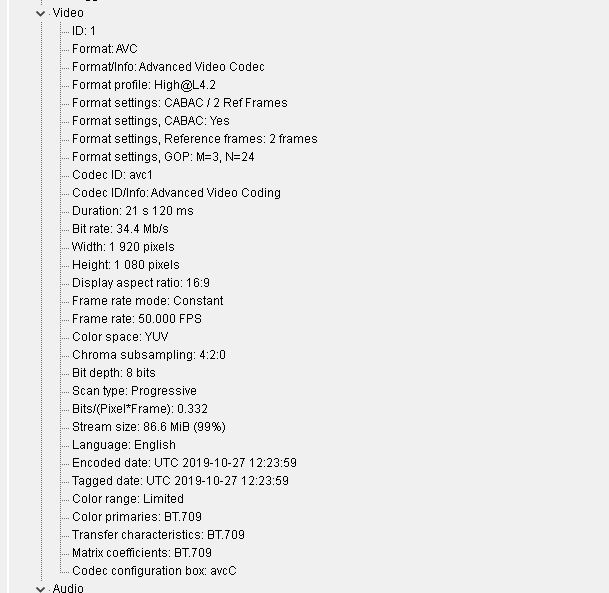

  21. Sharc, the second set of two frame grabs are from Resolves' timeline, no rendering was done only the timeline resolution changed. The loss of detail in 720 is particularly obvious at the bottom of the frame on the wire of the fence and the grass. The artifacts are more likely from the jpeg captures.
    These are the video details of the camera-original clip as reported by MediaInfo.
    Anyway, I just posted the comparison clips to illustrate the difference between the resolutions, something others have not done.

  22. @ChapmanDolly
    ok, thanks for clarification.

  26. No encoding used to produce either pic in my second post. They are direct grabs from the timeline. Firstly the timeline was set to 1080, the clips native resolution, then it was changed to 720.
    Both JPEG screen grabs are 1080, the first of a 1080 video, the second of a 720 video. It's a good illustration of what a 1280 x 720 video will look like when played on a monitor or tv with 1920 x 1080 resolution. The bitrate of the original clip has not changed when producing the 720 version. The frame grabs, using Windows Snipping Tool, has produced jpegs with a resolution only a third of that of the actual video frames.
