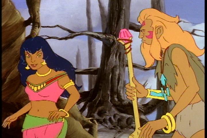

  18. Clip2 is only used when TFM can't find a matching field to complete the frame (ie, orphaned fields). So it makes no difference on the majority of the frames of this video. For example, with the latest clip, if you use just TFM() (no other filtering) you'll see that frame 268 has an orphaned field:
    [Attachment 51060 - Click to enlarge]
    TMF() couldn't find a matching field so it crudely deinterlaced instead (simple bob in moving areas).

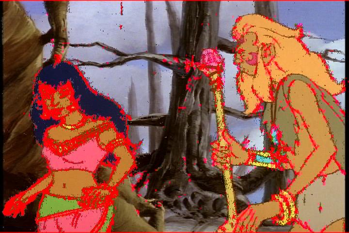

  20. Here I made clip2 all red so you could see exactly which pixels were taken from clip2:
    [Attachment 51071 - Click to enlarge]
    Most frames showed no red at all.

  22. Originally Posted by killerteengohan View Post
    Oh, so it doesn't need to use the entire frame. I just uses certain pixels from the looks of it.
    Yes, only the parts where it detected comb artifacts.
    How did you do that? I would like to be able to view it on all the episodes myself.
    I just used an all red clip for clip2.
    red = BlankClip(source, color=$ff0000)
