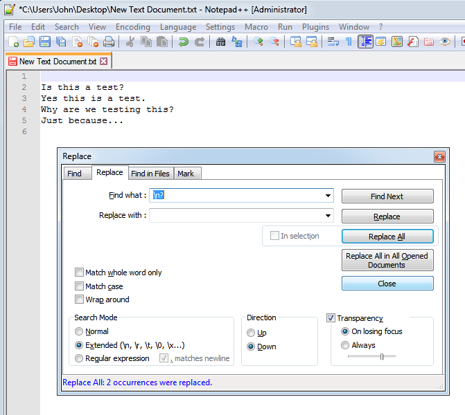

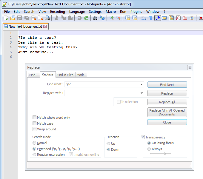

  7. Notepad++ lets you anchor a search-and-replace to the start of a line. Search for "\n?" replace with nothing.
    Before:
    [Attachment 51075 - Click to enlarge]
    After:
    [Attachment 51076 - Click to enlarge]
  8. Originally Posted by jagabo View Post
    Before:
    After:
