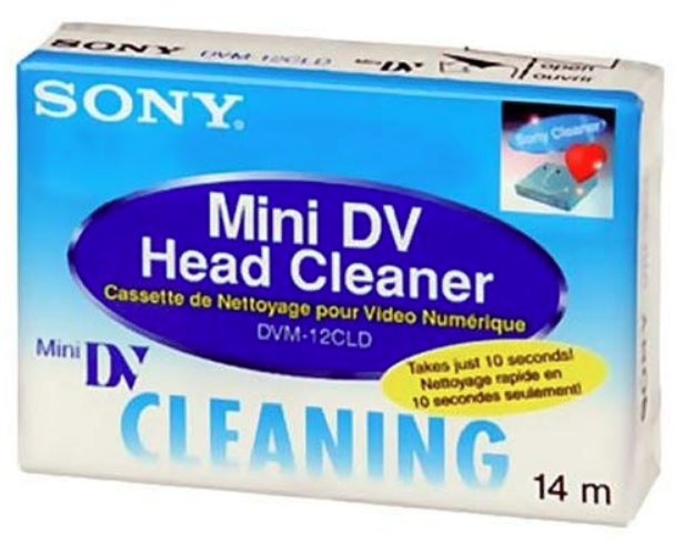

playback errors in the cam. you could try cleaning the heads. easiest way is with a tape cleaner. if that doesn't work the tape may have been recorded in a different cam and there an alignment mismatch.
