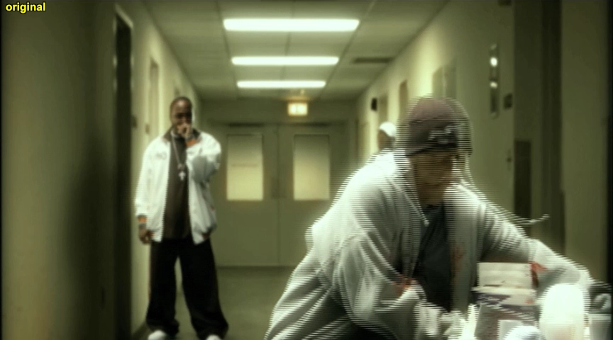

    Unfortunately, I don't have the original script anymore, but I can rewrite it.
    I created two different videos, one with combing interpolated, and one with combing interpolated and also using the half-height method.
    I interpolated comb frames but I also interpolated the occasional dupe frame.

    I then manually edited together the best parts of each version using Premiere Pro. I exported that file, and ran it through Topaz Video Enhance AI, which helped a lot with the banding issues and detail.
    The machine learning algorithms add a bunch of noise, so I imported it back into AviSynth and ran a simple TemporalDegrain2() on it. I find de-graining after the upscale preserved much more detail.
    The biggest problem left is the aliasing, which can be fixed using santiag after I resize to half-height, dosen't seem to work until I resize to half-height though. It works on most (but not all) of the aliasing issues, however, the detail loss is way too much, and I'd rather have minor aliasing.
    Last edited by embis2003; 6th Sep 2020 at 09:42. Reason: Edited mistake in the script, got confused with another project that was PAL.

    For those curious, here is my final result:
    It's nowhere near perfect, and I see lots of remnant issues and artifacts, but it seems fine for what it is. I could put on the HDTV, sit back, and enjoy it for the few minutes of length. The source was overly distracting, whereas the final file distractions become less obvious with normal viewing distance. I've seen better, I've seen worse. Until better source is located, you can call this a win.
    I appreciate that! I find its still the best "quality" of the video around, and that allows me to look past some of those issues, however, if anybody in the future can propose a fix to said problems I would not be opposed to starting the project over again. now that I know my way around a little more, it probably wouldn't take as long as 9 months.

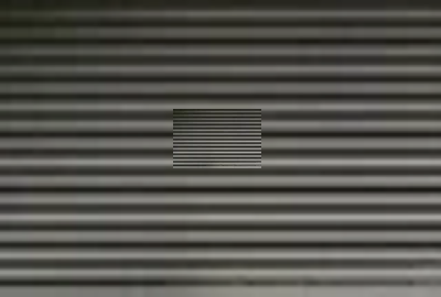

    There are progressive video clips with limited “short combing” that QTGMC works good on!
    Regarding the OP's first clip.
    I have seen the exact same combing in progressive mp4 clips?
    Example shows original and 500% size for easy viewing.
    [Attachment 76975 - Click to enlarge]
    This suggests this exact combing could be result of particular editing practice.
    I have used Vdub Internal Filter called field bob.
    Loaded twice through Vdub filter add function.
    For example:
    Set first field bob to smooth/down.
    Set the second to smooth/smooth.
    Depends on clip.
    QTGMC works better in a final process after field bob, but this might be a result of my QTGMC settings?

  9. Originally Posted by Charles-Roberts View Post
    I have seen the exact same combing in progressive mp4 porn clips?
    There are different types of "combing" with different causes , and therefore different solutions.
    There were old threads dealing with this on some similar issues on porn videos; not all the treatments are the same

    That eminem video in the 1st post is a special case as many of the frames are actually ok. The entire video wasn't done the same way, and it wouldn't be wise to process it using 1 method - or you risk creating new artifacts and problems on the "good" frames .
    Since that old post, there are better interpolation methods using RIFE - cleaner results, fewer artifacts for frame interpolation than using mvtools2 or svpflow. It requires 1 good frame before and after, and they interpolate the frame(s) in between. There are RIFE interpolation functions posted in threads here and doom9 . In general, RIFE produces better results for frame interpolation. MVtools2 and SVPflow have higher chance of edge occlusions and "blobby" edge artifacts, as well as other problems
    I am not interested in manual editing, just full clip processing.
    Then you would get poor results if your case was like his. You would damage "good" frames. You would need to apply different filters to different frames

    It depends on the specific problem and specific video.
    If it's been upscaled from the original resolution using a progressive algorithm, while still interlaced with interleaved fields - then you might be able to "undo" it using a reverse kernel (such as debicubic , debilinear) to reconstruct the original fields. There were examples of code used on porn videos in another thread. But if it's downscaling, then you cannot really fix it properly, because more information is lost.
    Start a new thread if you want advice on specific video

  11. Originally Posted by Charles-Roberts View Post
    The clip I refereed to is exactly the same as OP video, in the areas and frequency, placement and appearance of combing.
    This is why I mentioned clips having something the same in treatment to be so similar. We are talking exact, as best can be noted.
    Whatever was done, is very likely identical for both videos.
    Frequency - are you describing the pattern in a particular frame as a spatial description; or among a range of frames - a temporal descriptoin?
    ie. Do you have clean reference frames to interpolate "from" ? Otherwise that method won't work for you.
    What is the pattern of clean vs. combed frames ?
    A more typical case for a porn video mishandling is simple progressive scaling, with interleaved fields - That's not quite what the OP has, because there are many good frames during motion
    Not worth starting a new thread without being able to supply material.
    I would just like more info about RIFE interpolation functions.
    I will need to study up on this from scratch.
    Perhaps a short sample of code to get started?
    There are several variations, but a versatile RIFE based function that can interpolate multiple consecutive "bad" frames is in post #16
    https://forum.videohelp.com/threads/407293-ReplaceFrameX-InsertFrameX
  12. Originally Posted by poisondeathray View Post
    A more typical case for a porn video mishandling is simple progressive scaling, with interleaved fields.
    The form of combing is the same, but there are more areas where good reference frames are not available.
    What you have said is correct.
    I will need the versatile RIFE based function to interpolate multiple consecutive "bad" frames!
    I have assumed the fps can remain the same with this process?
    I have AVISynth installed, do I need any other bits to make the function work?
    Should I convert to original dimensions and aspect before, during or after this?
    I have not looked into it, but might be able to find the original SAR/DAR before what was likely down-scaled video.
    Thanks.
    Last edited by Charles-Roberts; 12th Feb 2024 at 13:24. Reason: Moved unread forward
  13. Originally Posted by Charles-Roberts View Post
    Yes, FPS remains the same .
    But once you have more than a few consecutive "bad" frames, interpolation because less useful as a technique - because it cannot recreate the actual missing data from missing time samples. The "tweening" motion will look very robotic and fake. RIFE (or related methods) use linear interpolation between 2 good frames - and real life motion is usually not linear at all
    The more typical porn case is it started with interlaced video. The badly resized / badly deinterlaced version is 1/2 the field rate. So for PAL area, it would be 25FPS, when it should have been double rate deinterlaced to 50FPS (For NTSC, it would be analogous 29.97FPS and 59.94FPS) . Motion is smoother at 50 FPS or 59.94 FPS - that's what the video should have been - because it's usually "video", not film
    If you can get a clean 25p or 29.97p single rate version from processing, then you can try RIFE on the whole thing to synthesize 50p or 59.94p - to emulate what it should have been
    If the version you have is upscaled (larger than 720x480 "NTSC", or 720x576 for "PAL"), then I would try the inverse kernel methods, such as DeBicubic, Debilinear.
    The dependencies are listed in the requirements list
    https://github.com/Asd-g/AviSynthPlus-RIFE
    https://github.com/Asd-g/AviSynthPlus-RIFE/releases
    What are the current dimensions ? And what should they have been ? e.g. a PAL DVD original source would have been 720x576
    For frame interpolation cases you'd usually convert after, but in the upscaled case the inverse kernel tries to reverse the scaling method used back to the original and hopefully "fixes" the fields
  14. Originally Posted by poisondeathray View Post
