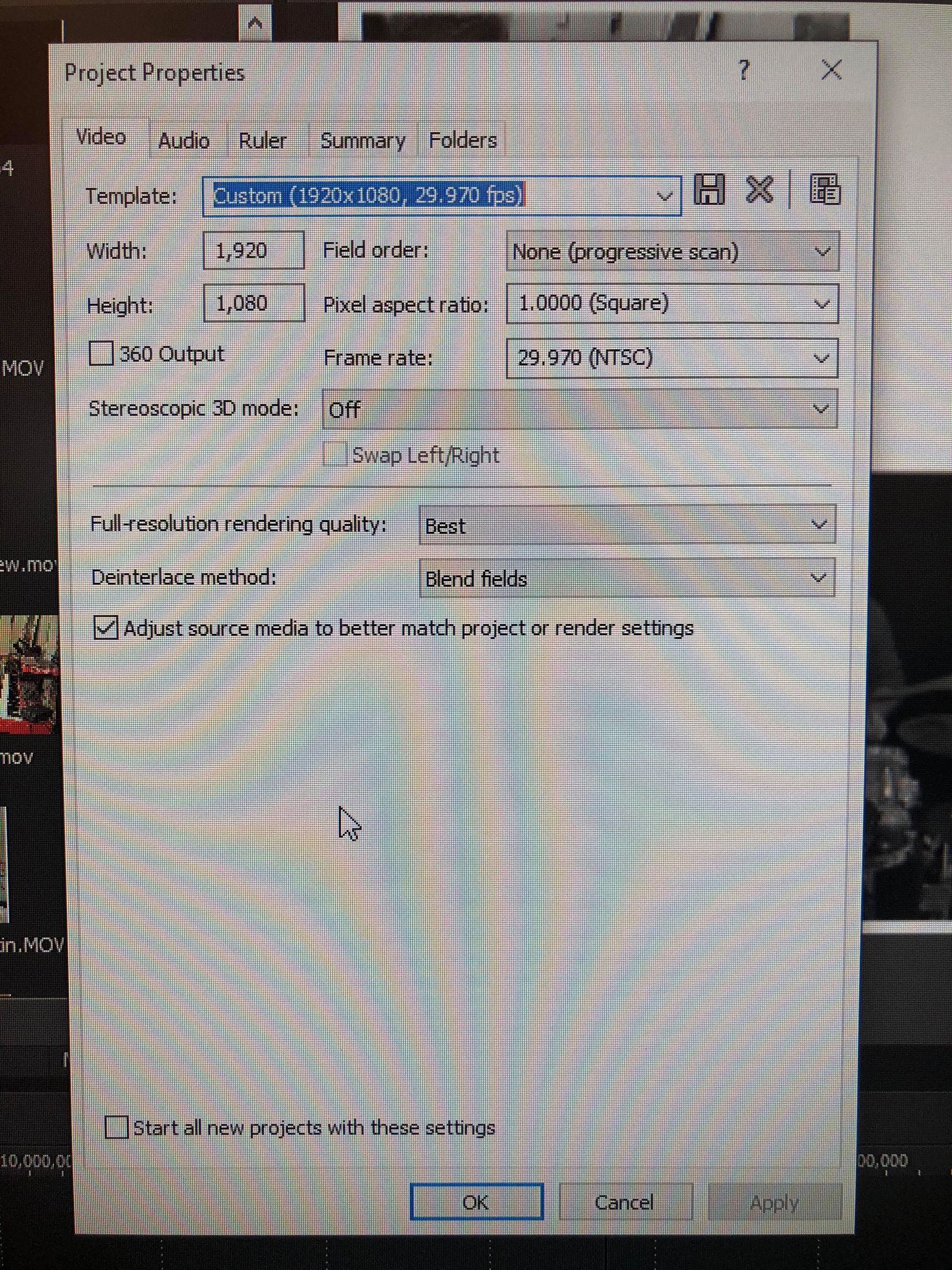

I just bought Vegas 17. I noticed some artifacts in my final render. I watched this video talking about setting 32bit floating point under preferences however on my computer the only option I have is Best Good Preview and Draft. Anyone know why this option is missing on my version?
Thanks -

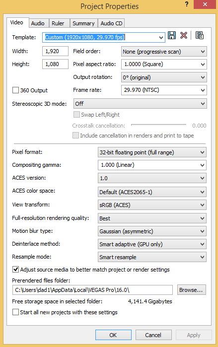

Leave Best in there, but there should be another box called: Pixel Format, That would set bit depth for calculations.
8bit
32bit - floating point limited range
32bit - floating point full range -
[Attachment 53435 - Click to enlarge]Really odd but its not there. No idea why. I just purchased this software two weeks ago and it has the lastest updates applied. Did Magix remove this feature? Magix Vegas Movie Studio 17 Platinum -
Most likely it is somewhere else. They shuffle buttons around when changed it to Magix.
I've been looking but cant find it anywhere. I've googled it but couldn't find it mentioned anywhere else other than where it is supposed to be

Must wait for someone who knows whats going on. There are folks out there saying to not use it for 8bit sources, which is absurd if done correctly, you do not accumulate errors. But they say it is not reliable for colors etc. : https://www.vegascreativesoftware.info/us/forum/plea-to-new-users-please-do-not-set-32...ormat--114750/ , comments like that are really weird.
Was it removed then?
Someone will actually set that straight hopefully.
sony hasn't been involved with vegas in several years. i only have magix vegas pro 16 not 17 and the setting is there. BUT i've used vegas pro since version 6, and i've never not had the options listed in the screenshot below.
[Attachment 53454 - Click to enlarge]--
