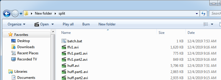

I tested the batch file before posting -- it worked perfectly here (Win 7, 64 bit):
[Attachment 51021 - Click to enlarge]
Before running the batch file there were only batch.bat, ffv1.avi, and huff.avi. The two videos contained numbered frames (0 to 23, 23.976 fps). The output files contained frames 0 to 11, and 12 to 23.
Just to be sure, I copy and pasted the text from my post into a new batch file. It worked fine too.
Note that the batch file is for intra-frame AVI files (I used huffyuv and ffv1 codecs in the test). And the batch file should be in the same folder as the AVI files. I tested with filenames with and without spaces.
