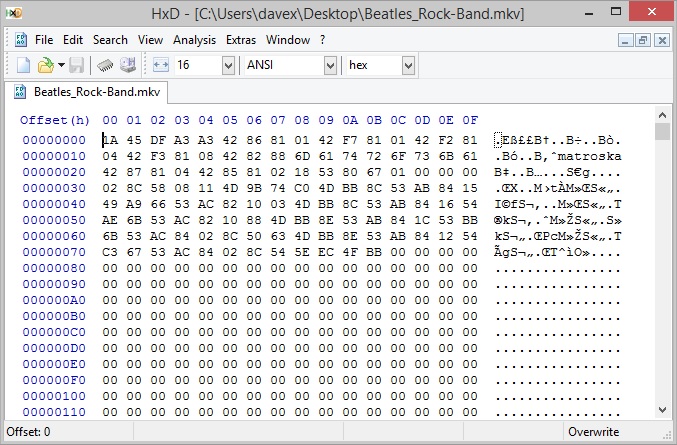

    You can also use a hex editor (eg. HxD) and look at the header (here you can see a known good file, and mediainfo report in text view)

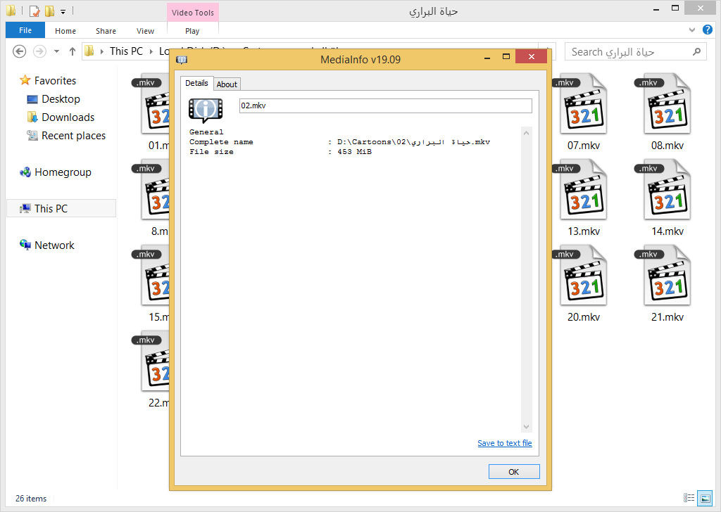

    Unfortunately mediainfo doesn't show much of information about the encrypted files.
    [Attachment 50982 - Click to enlarge]

    To be sure, download and use Hxd, open the file, and look for the header right at the beginning, similar to my post above
    https://mh-nexus.de/en/hxd/
    Your mediainfo report above means that the program was not able to recognize the file as a media file at all

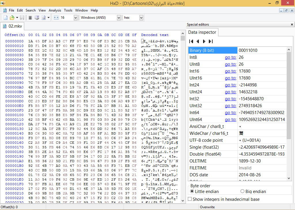

    Here's the HxD report:
    [Attachment 50984 - Click to enlarge]
    Mar 2008
    Based on that, I would say the file is encrypted and unless you can find a decryption tool they are lost.
