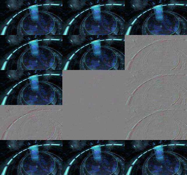

  9. Here's an example of how comparing multiple frames would work. I'm using AviSynth's Subtract() filter which subracts pixels of one clip from pixels of another clip, and returns the result as an image. Since an image can't have pixels with negative values Subtract() adds medium gray. When two images match perfectly the result is a flat grey image. When A-B results in a value less than zero you get a darker pixel. when A-B results in a value greater than zero you get a lighter pixel.
    [Attachment 50946 - Click to enlarge]
    At the top of these film strips is the end of the first clip. At the bottom is the start of the second clip. The grey-ish frames are the overlapping frames after Subtract(first, second). At the left there is only one overlapping frame and it shows obvious differences between the two clips. In the middle there are two overlapping frames and there are only very tiny differences. On the right three frames are overlapped and all three show significant differences. So from these results you would say there are 2 frames of overlap at the end of the first clip and start of the second clip. And indeed, I created the clips with 2 frames of overlap.

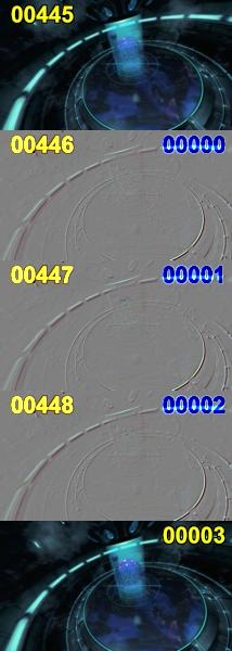

    Here's an example with 3 overlapping frames where the frames were numbered before being overlapped. The first clip is numbered at the top left of the frame, the second at the top right:
    [Attachment 50948 - Click to enlarge]
    You can see the last 3 frames of the first clip and the first 3 frames of the second clip are overlapped. This is the equivalent of the right column in my previous post.
