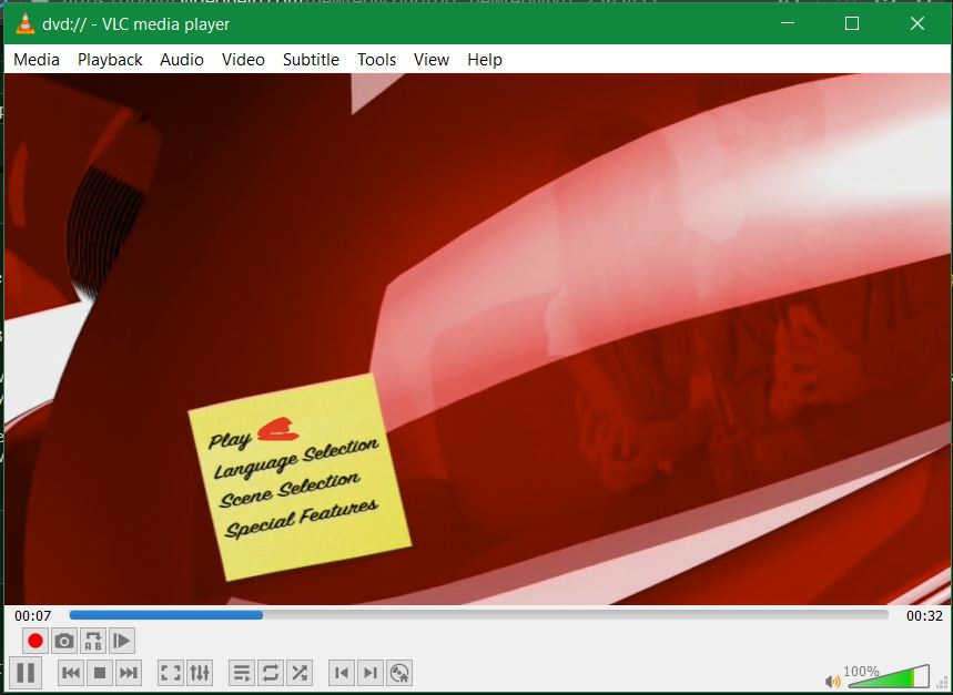

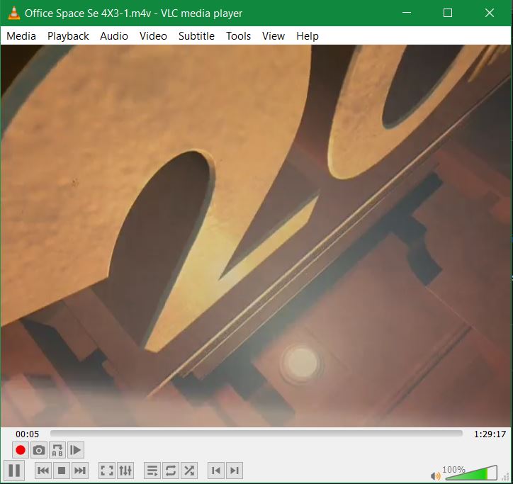

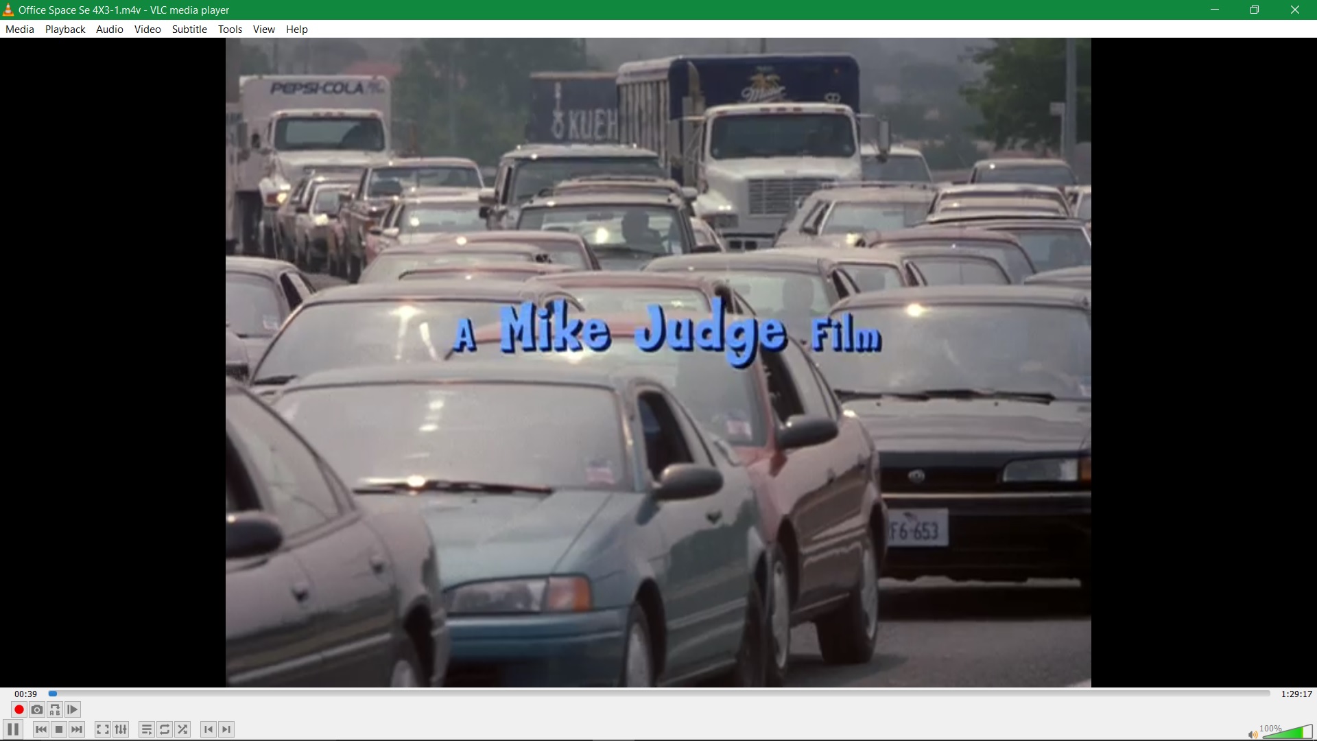

    Ok SO it was my mistake I was using the wrong phrasing. It is PILLARBOXING not letterboxing.
    Here it is when it's played directly from the DVD
    https://imgur.com/a/QjsKvsI Fullscreen
    https://imgur.com/a/ouopiG5 Windowed
    Here it is after ripping
    https://imgur.com/a/RahQTtf Fullscreen After Rip
    https://imgur.com/a/XLr1ZXd Windowed After Rip

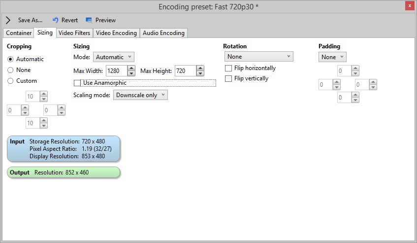

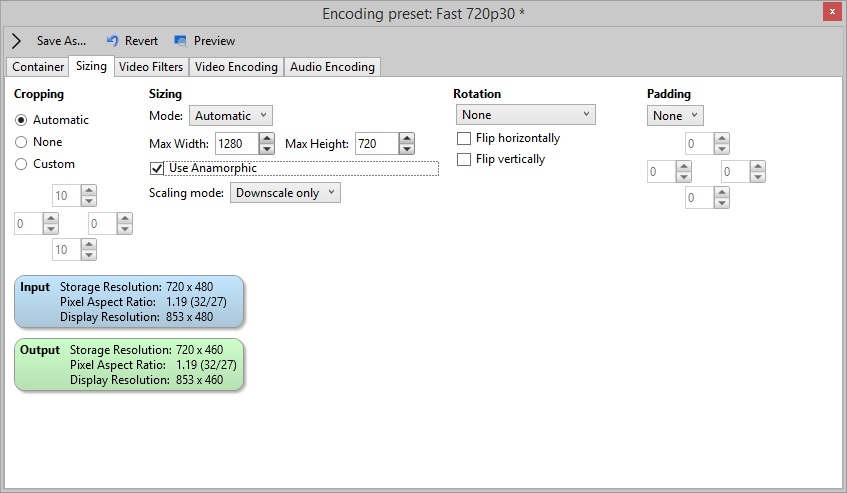

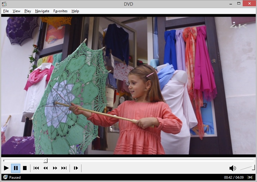

    Here are some images to see how things are supposed to be - I'm using VidCoder, a simplified GUI but Handbrake under the covers.
    I have a 1.85:1 anamorphic DVD sitting on the HDD. When you open it in the media player, this is how it should look, a very
    small lettter box (approx 10 pixels top and bottom), since 1.85 is "wider" than the DVD standard 1.78:1
    When you open it in Vidcoder, the first image shows how the small letter box is accounted for and it crops 10 pixels top and bottom.
    When the video_ts (or DVD) is played, those 20 pixels are a part of the picture; they're only cropped in the conversion.
    You can see in the green output box the finished file will have an actual resolution of 720*460, but a display resolution of
    853x460 (1.85:1). Notice the "anamorphic" setting is selected.
    In the second image image, anamorphic is turned off and the actual resolution and display resolution are the same,
    852x460 (also 1.85:1)
    Either of these two choices are OK, but for playing them on an external device the non-anamorphic is better.
    I hope these images help; since your movie is the same aspect ratio, perhaps you can use this as a guide.

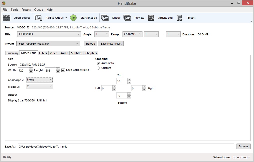

    One of the differences in Handbrake, it doesn't allow an increase in resolution as Vidcoder does.
    So when you turn off anamorphic (because some hardware playback devices don't support it) you'll see:
    Vidcoder expands the width, giving 852x460, HB on the otherhand, reduces the height giving 720x388
    (both 1.85:1)
    If it doesn't work, post the screen shot from the app
