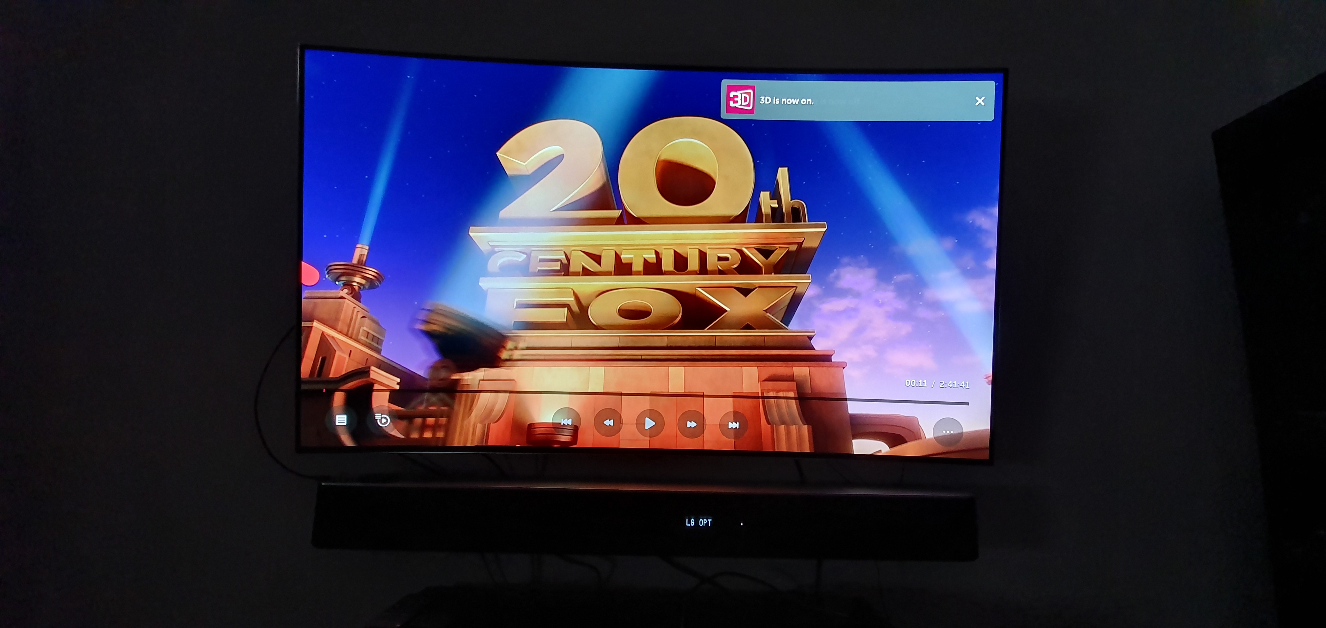

  14. I compare two movies with headers editor but I didnt see anything different in values. I also try to leave the video track and audio and remove everything,subs,chapters track names but nothing changed. Still have a normal 2d image when turning off 3D. Image
    [Attachment 50920 - Click to enlarge]
    [Attachment 50921 - Click to enlarge]

    Right now, I can't think of a reason why this would only be with mkv's that are created with BD3D2MK3D.
    But, may I ask what your goal is to to put both views via usb on the tv?
