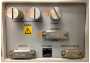

    I need some help to understand the video signal from a BNC video output port. There is a X-Ray machine, model GE 9900 Elite, which has several video output ports, such has BNCs and DVI. A X-Ray machine usually has 2 monitors. I need to capture the video signal on the left monitor. I have attached an image regarding to the ports from the X-Ray machine with labelling. According to the manual, Number 1 and number 2 BNC ports are the video signals display on the left monitor screens, where 1st one is hi-resolution, and 2nd is lower resolution. The 3rd BNC port is for right monitor, and the DVI is also for right monitor. Note: the image below shows covers protecting the BNC and DVI ports.
    [Attachment 50900 - Click to enlarge]

    A single BNC usually just outputs a composite video signal. The same signal that is normally carried on a RCA Composite Yellow Cable (along with the Red/White audio cables). There are $5 BNC to RCA adapters on Amazon. This would allow you to look at the video on just about any TV.
    I'm a little confused about everything here in your post but with RGBHV (VGA), that's a RGB signal and not directly compatible with YPbPr/YUV (Composite). The only thing I guess that is compatible between the signals is the Green, which Composite treats as the Luma (Black and White) and does not require an additional signal.

    The DVI port from X-Ray is for Right monitor. I want the content from left monitor.

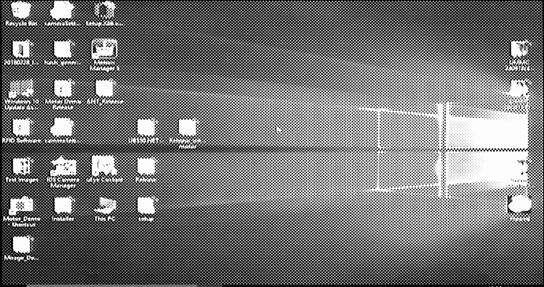

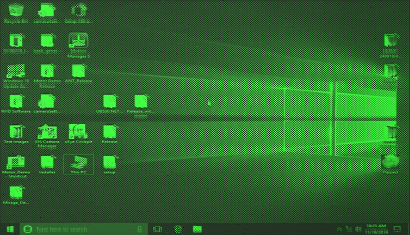

    5 BNCs to VGA produce blurry green tint video as shown below
    [Attachment 50914 - Click to enlarge]
    scanmaxx produce blurry black and white video

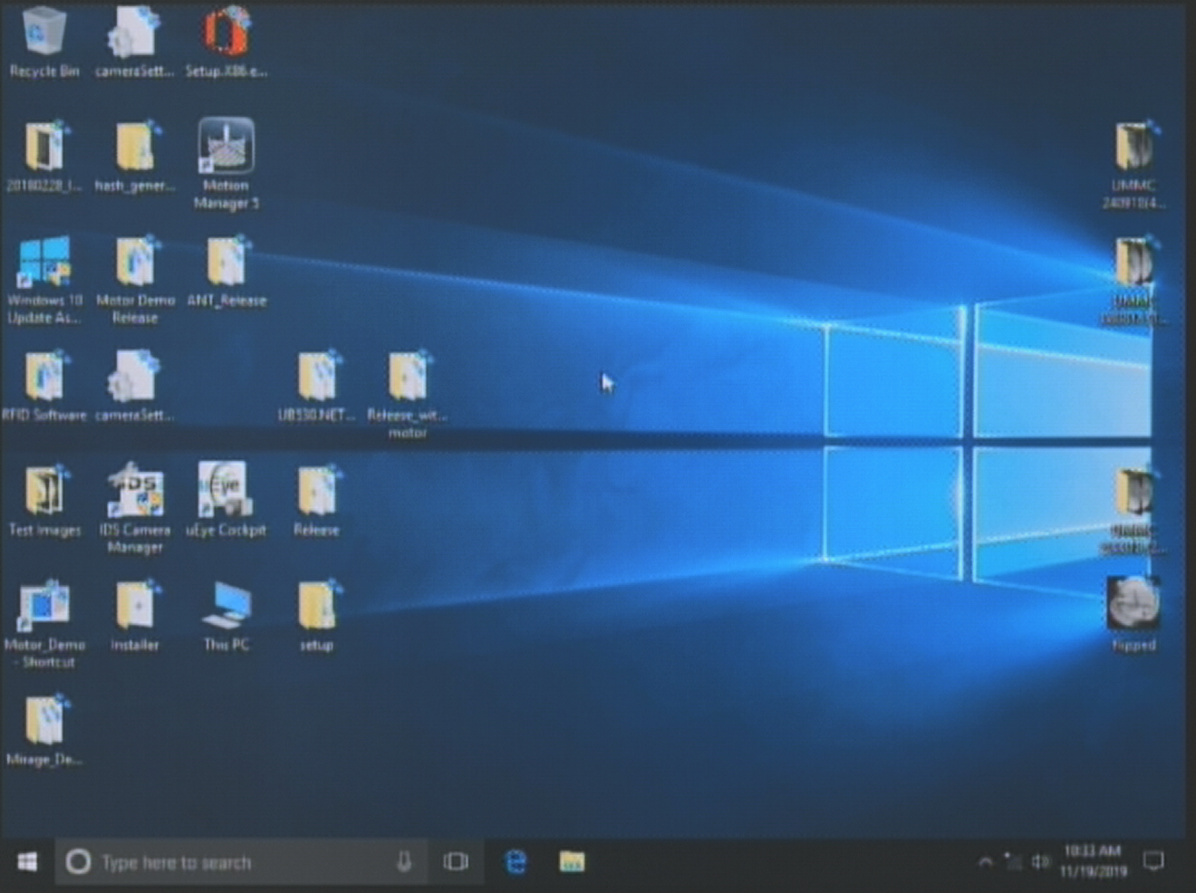

    composite to VGA converter produce the least blur colored video
    [Attachment 50916 - Click to enlarge]
    But for the X-ray machine, the 5 BNCs to VGA and scanmaxx do not produce such blurry video though, it's quite clear as compared to the result here.
