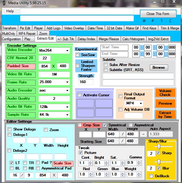

  8. Member Budman1's Avatar
    Jul 2012
    NORTHWEST ILLINOIS, USA
    FFMpeg can be daunting (hard) to learn for some, especially if you need some function right away. Maybe I can help with an example and explanation of the script.
    ffmpeg -i 'C:\Users\Bud\Desktop\G50_25_Test_Pattern_w_sound.mp4" -ss 00:00:00.000 -to 00:99:00.000 -vf smartblur=1:0.2:6,unsharp=5:5:0.25,eq=1.1:0.1:1.1:0.9:1.0:1.0:1.0:1.0,scale=854:480,setdar=1.779 -vcodec libx264 -crf 22 -r 25.000  -acodec aac -ac 2 -ar 44.1k -b:a 128k  "C:\Users\Bud\Desktop\G50_25_Test_Pattern_w_sound__Edited_1.mp4"
    The above takes a 640x480 video, within 0-99 minutes, Blurs it, sharpens it, Final processes it (bright, contrast, gamma. colors,etc, scales it,sets display aspect, quality and frame rate.
    ffmpeg = name of the program to run
    -i = input the following program
    'C:\Users\Bud\Desktop\G50_25_Test_Pattern_w_sound. mp4" = Name of video to process
    -ss 00:00:00.000 -to 00:99:00.000 = set time of video to process
    -vf = The list of Video Filters(vf)
    smartblur=1:0.2:6,unsharp=5:5:0.25,eq=1.1:0.1:1.1: 0.9:1.0:1.0:1.0:1.0,scale=854:480,setdar=1.779 list of video filters, each different layout, must be researched at first until you become familiar
    -vcodec libx264 = Video codec to encode with
    2
    -crf 22 = quality you are attempting to achieve. (20-22 about equal to source.
    -r 25.000 = Frame rate of output video
    -acodec aac = audio codec to encode audio
    -ac 2 = set channels to 2 for audio
    -ar 44.1k = sample rate of audio
    -b:a 128k = bit rate of audio
    "C:\Users\Bud\Desktop\G50_25_Test_Pattern_w_sound_ _Edited_1.mp4" = Output video file name
    You can Match the functions and their representation with the pictorial below. Then read and adjust for your use.
