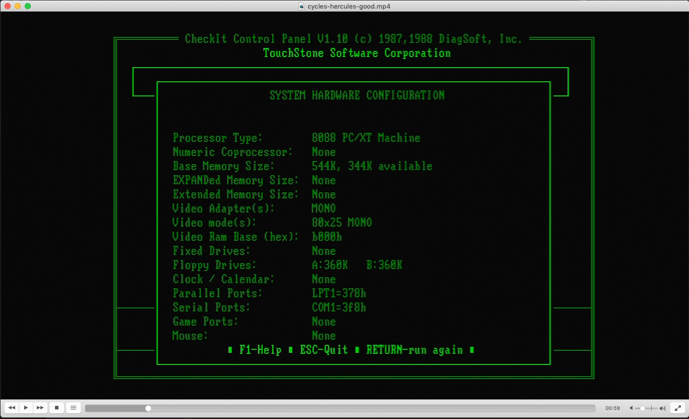

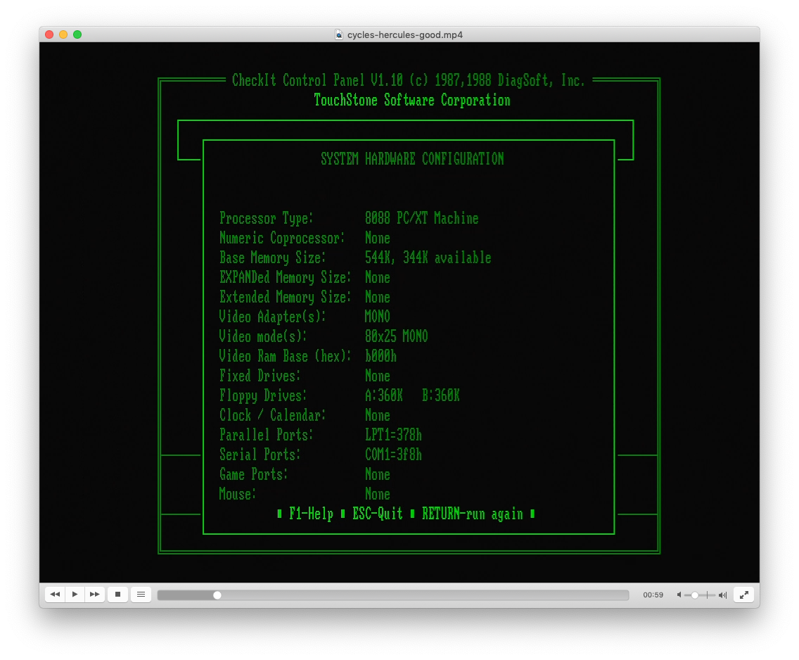

    I have a video from a capturing device that has captured footage from an old computer (MDA graphics 720x350). The captured video file has a resolution of 1024x768 (dictated by the capturing device), but the video shows the content way too narrow (it is captured like a square, so I need to increase the width of the video somehow or change the aspect ratio).
    If I load up the file in VLC player, it looks like this
    [Attachment 50868 - Click to enlarge]
    If I change the aspect ratio in VLC player to 16:9 it actually looks a lot better and resembles more what I see on the monitor.
    So I would like to have it permanently look like that by modifying the video file itself, so other players will play it automatically like that
    [Attachment 50869 - Click to enlarge]
    As you can see the image is stretched out, and resembles more what I see on the monitor.

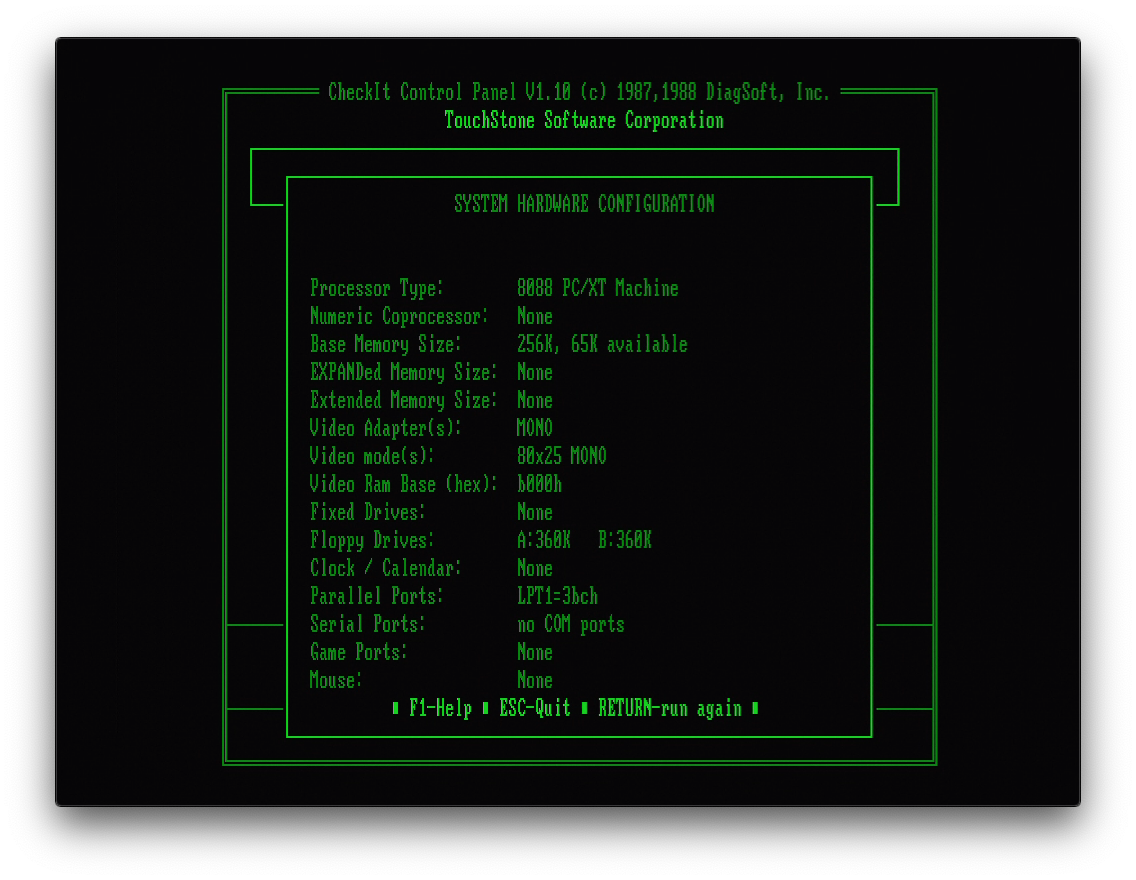

    [Attachment 50881 - Click to enlarge]
    And after executing the mp4box command above I got this file :

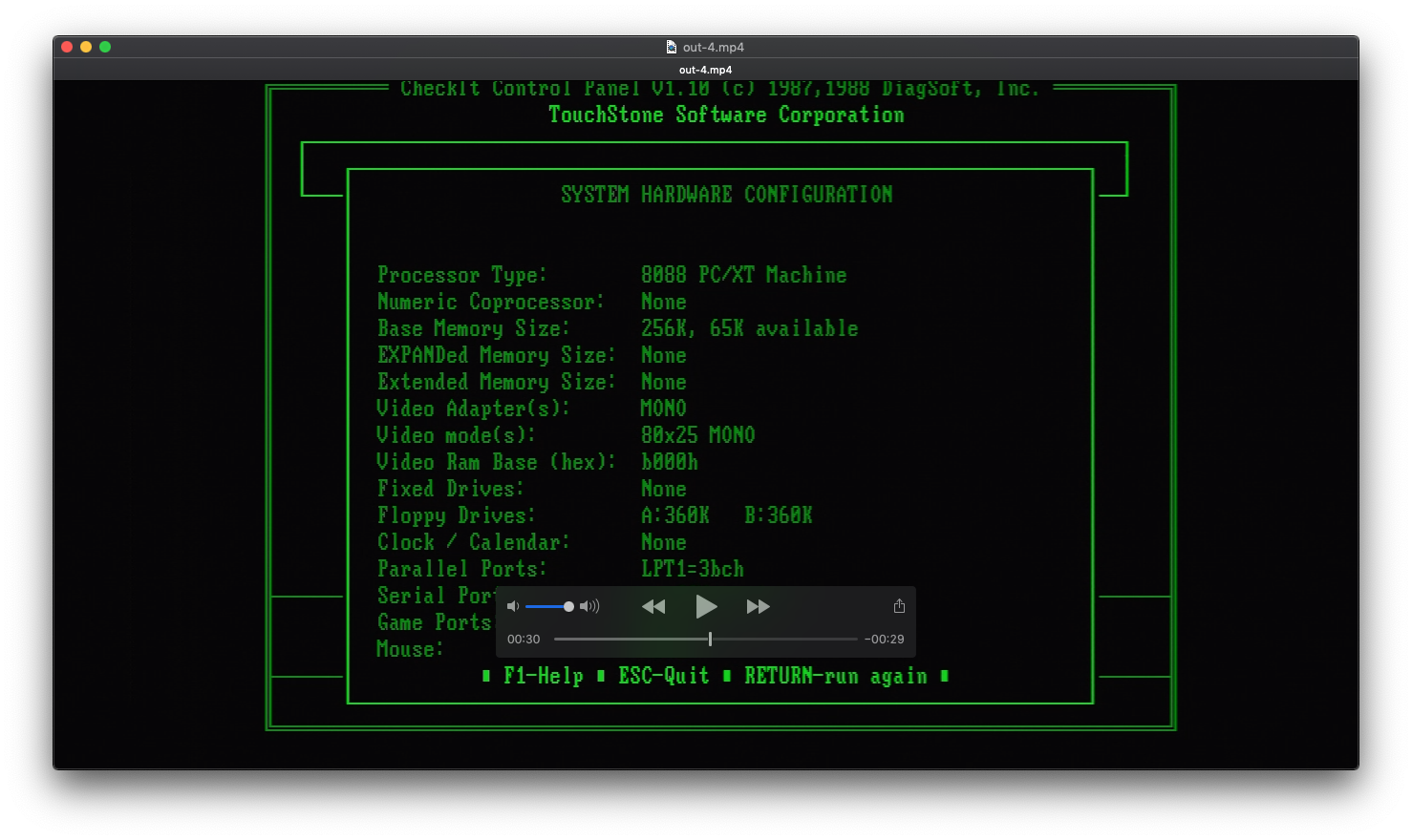

    [Attachment 50882 - Click to enlarge]
    This was pretty much the visual I was looking for. So if I understand correctly only a parameter (meta-data) was changed (Display aspect ratio) and not the actual file.
    But why did it end up setting 16:9 in the meta-data when I specified "-par 2=4:3" in the mp4box command ?
    When I specified "-par 2=16:9" in the mp4box command the Display aspect ratio was set to 2.40:1
