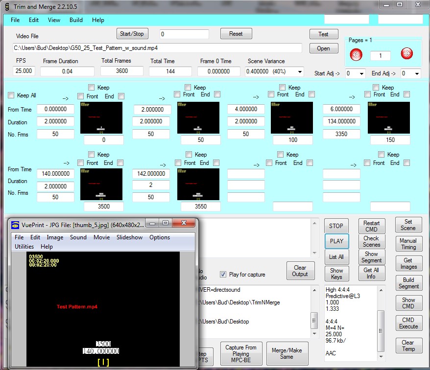

    FFMpeg does a pretty good job with the recent versions of cutting frame accurate and making the first frame start at 0.00000 without encoding. You just have to be aware that it takes about 2 frames (depending on codec) to put the brakes on. This is why if you try to cut exactly on an I-Frame or 1 frame early, you next all the way to the next I or P frames. Many cutters do this without manual intervention. For this reason, I wrote a cutter that encodes just what is needed and copies the rest, being frame accurate .
    [Attachment 50859 - Click to enlarge]
    This is an example of cutting times 0 - 139. You need to get the times where you want to cut, (I assume you use something similar to FFProbe) either with FFProbe or outputting the times and frames as it plays.

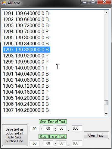

    [Attachment 50860 - Click to enlarge]

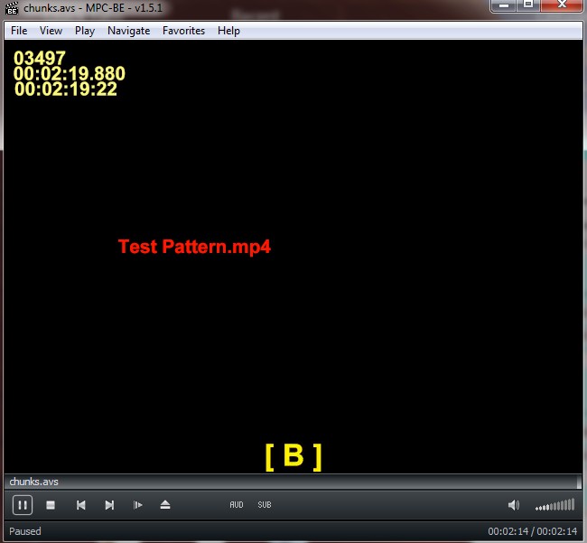

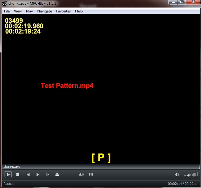

    Then set your cut point 2 frames short. In the highlighted area it is a 'B' Frame 2 short of frame 3499, a 'P' Frame before The cut point intended and the cut will include this.
    [Attachment 50861 - Click to enlarge]
    [Attachment 50862 - Click to enlarge]
    Then just use FFMpeg as :
    ffmpeg -ss 0.000000 -i "C:\Users\Bud\Desktop\G50_25_Test_Pattern_w_sound.mp4" -t 139.880000 -c:v copy -c:a copy -y "C:\Users\Bud\Desktop\0_0_G50_25_Test_Pattern_w_sound.mp4"
    I've never used ffmpeg to cut, all of my stuff is in mkv container so I usually use mkvmerge for cutting (except for these cases where I've tried smart encoders to help with the MPEG-2 stuff). Your program looks slick. I'll try ffmpeg with frame adjustments you recommended.
