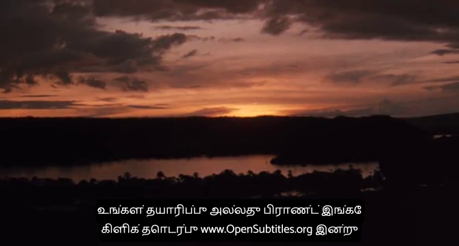

    Hi, i have coded with ffmpeg command the subtitles to a video using .ass file.
    the coding ended successfully and when i click to play the output file in vlc media player from my saved folder in pc, the subtitle shown correctlyl as per my language, which is like the first picture.
    But when i saved the same to usb drive and play with the file, it behaves differentlyl , even though i selected .ass format, which has all formats saved properly , and which plays correctly.
    see the difference in the formation of letter. i used catamaran font for encoding and all the adjustments have been made in aegisub to save as ass file.

  2. With soft subs you are at the mercy of the subtitle renderer. Not all renderers work the same. They do not all support the same fonts and same languages.
    Jul 2007
    Are you playing these videos on your TV as you've mentioned in your other threads? If so, the only options are hardcode or use a better (i.e. external standalone) media player.
  4. Another possibility is to use graphic based subs (pictures of text) rather than text based subs. But again, outside a computer (and authored DVD and Blu-ray), not many devices support that.

    the fact that appears correct if i i run in pc, is the fact that i inadvertantly did not remove the .ass file in the folder where the video was located, with the result the vlc player had used the .ass file to give the correct picture. i did not notice it at first.
    then when i moved the .ass file, the video in pc also shows the same way as in pendrive.

  6. The subtitle renderer is the program that draws the subtitles onto the video. Text based subtitle files are just instructions on how you want the subtitles drawn. The subtitle renderer may not follow all the instructions properly.
    If you want to make sure your subtitles are seen exactly as you want them you must hard code them with a render which draws them the way you specify.

  8. vlc does not render fonts specified in the ass file that is whyou get the default vlc font which is arial, and that explains the difference..
    Try hard coding foreign sub into tbe video..
    Otherwise tv will not play the ass as formatted.. i dont think tvs support trutype fonts..

    Because you did not hard code the subtitles. You just muxed the subtitles into the mp4 container. You don't seem to understand the difference:
    Take a cardboard box, a photograph, and a piece of paper. On the paper write the instructions "Write 'This is a subtitle.' in italics at the bottom of the picture". The box is the MP4 container. The photograph is the video. The piece of paper is a soft subtitle. Put the photograph and the piece of paper inside the box -- this is the process of multiplexing, or muxing. You now have an MP4 container with video and soft subtitles inside. When you play this video (that is, when you take the photo out of the box and look at it) you become the subtitle renderer. You can choose to write This is a subtitle. on the picture or not. You may use italics or not depending on your abilities. Your handwriting is different than mine, so when I view this video the subtitle will look different -- that is my handwriting "font" is different than yours, even though we followed the same instructions.
    Now take a cardboard box and a photograph. Get a pen and write 'This is a subtitle.' in italics on the photo -- as you write this you are the subtitle renderer. Put the photograph in the box. You now have an MP4 container containing video with hard coded subtitles. Every time you look at the photograph you will see the subtitle. You cannot look at the picture without seeing the subtitle. No matter who looks at the picture it will have the same subtitle, in italics, the same font, the same location, the same color, etc.
